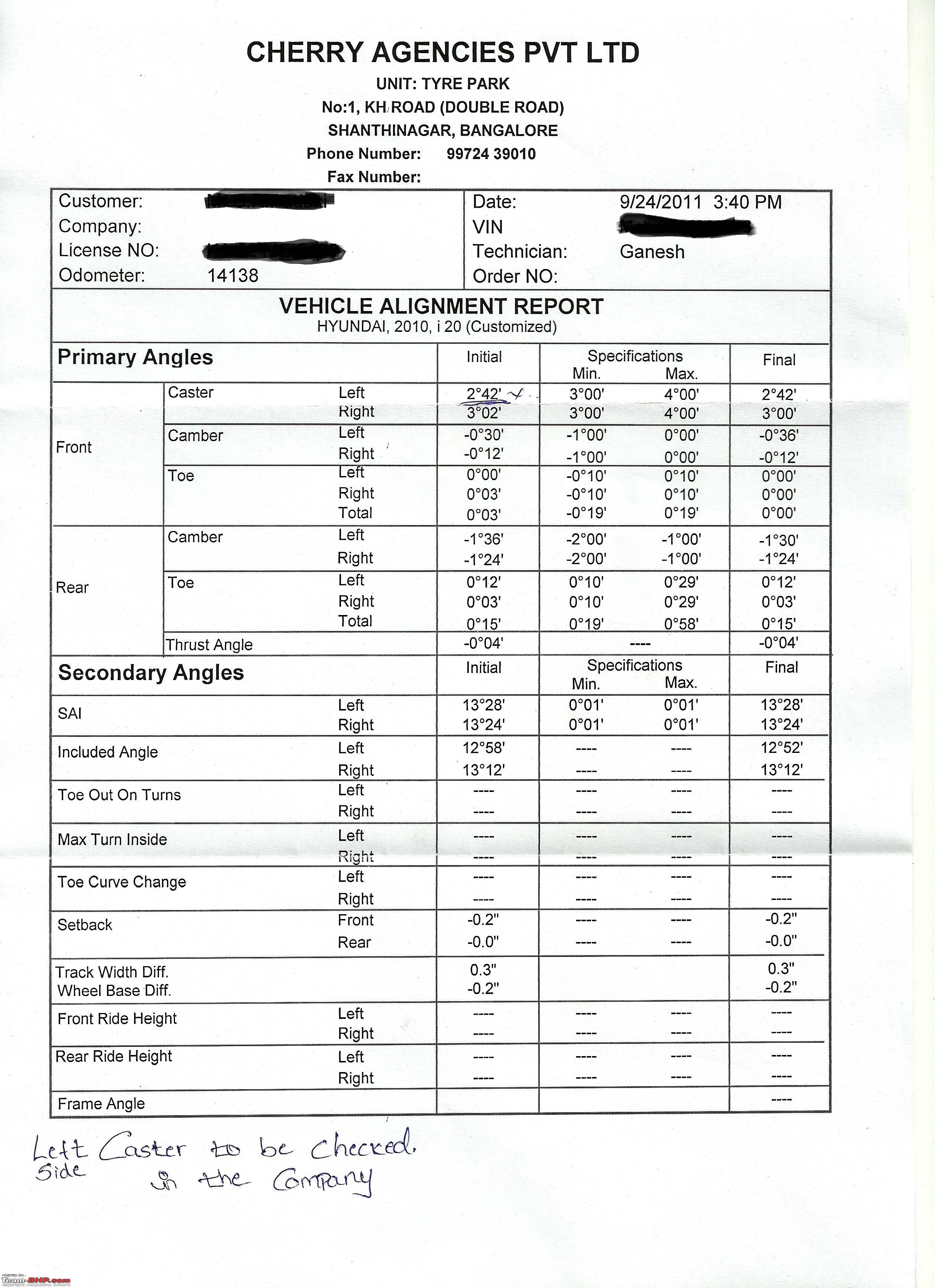

Today got alignment done to my I20. The technician said the left front Caster cannot be adjusted and there is a problem. He asked me to check with service center.
What exactly is wrong and what should I ask the service center to check.?

Caster cant be adjusted by any tyre shop guy. You will need to get it done at the service centre.
I think you have problem with the camber and not the caster. Caster is the angle the steering makes and there is no LEFT or RIGHT with that. Camber is measured at every corner.
Camber also cannot be adjusted for most cars. You will have to take the alignment report to the Hyundai service centre and show them how the camber is off and ask them to have a look at it.

Nikhil,thanks for the reply.
I have been having a left pulling problem with my i20 since past 7K kms. I am unable to find out why.After the last alignment it was reduced to 50%. As soon as i leave the steering ,the car starts drifting to the left very rapidly and within one or two seconds it will go out of road.
For your reference i am attaching the Alignment report . Please let me know what should be corrected to solve this left pulling problem.
PS- All the tires are properly and equally inflated and its not because of tapering of road because this left pulling happens even on the flat concrete roads
EDIT- What is this "SAI'? The SAI value is way out of limits!
