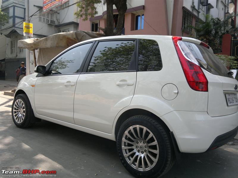

Posting on behalf of a friend, Plati Alloys - Tyre Yokohama 195/55/R15
Ford Figo : Tyre & wheel upgrade thread-04032011468-medium.jpg
Ford Figo : Tyre & wheel upgrade thread-04032011469-medium.jpg
:thumbs up
