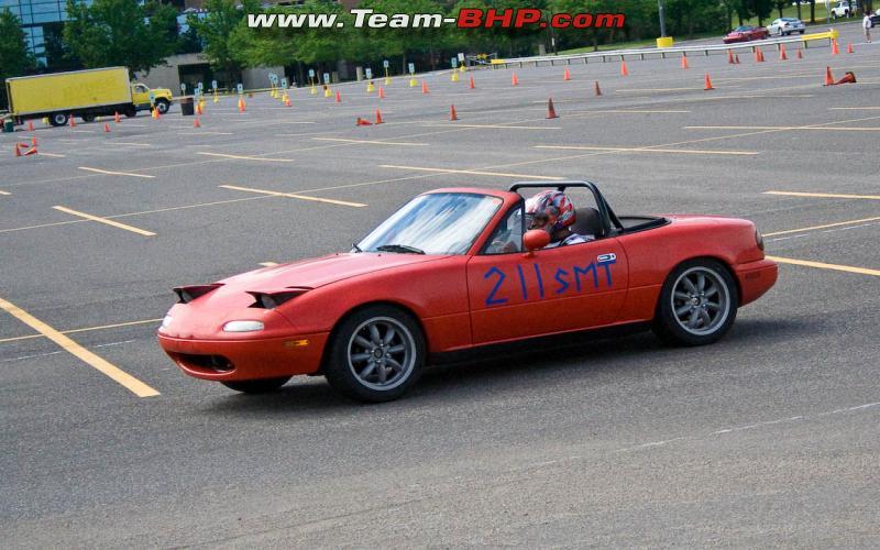

Engine Specifications:- 1596cc DOHC
- Stock block, head and valvetrain
Turbocharger & Induction: Home-built fully custom setup with:- MHI TD04L-13T turbo
- Denso intercooler from Ford Probe
- Denso bypass valve from Subaru STi (that's right no boy racer BOV here)
- Custom charge tubing
- Cone filter
- Custom-built exhaust manifold
- Custom-built downpipe
- 2.25" catback exhaust
Not dynoed but at 12 psi I have put several car lengths on E92 M3, Mustang Cobras and even a BMW Z3M coupe on the freeway. Fuel & Tuning:- Custom-built standalone ECM in stock Denso case and un-molested factory wiring
- 330 cc injectors @ 38 psi base pressure
- Closed-loop fuel calibration
- Closed-loop idle control
- Closed-loop electronic boost control
Drivetrain:- Stage 2 clutch and 2 lb lighter flywheel
- 3.9 ratio and stronger diff from 1999 Miata.
Wheels & tires:- 16 x 7 Rota RB panasport-style
- 215/45 R16 Kumho Ecsta XS auto-x compound tires
Suspension:- Bilstein HD dampers
- 425/340 lbs/in springs
- Adjustable coilover spring perches
- Polyurethane jounce bumpers
- Heim-jointed Flyin Miata front sway bar
Interior:- Hard Dog roll bar
- G-force 6 point harness
- A/c Vent boost gauge
- Concealed RS232 port for ECU
- Either Radar detector or speeding ticket (coming soon)
Exterior:- Faded paint for that true bomber look
- Stock except wheels and tires
