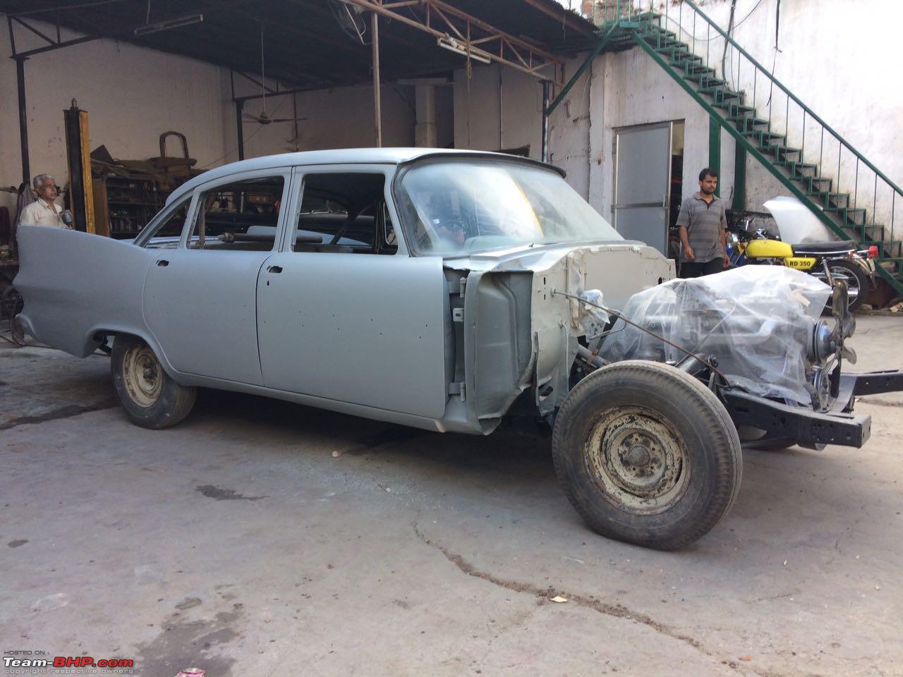

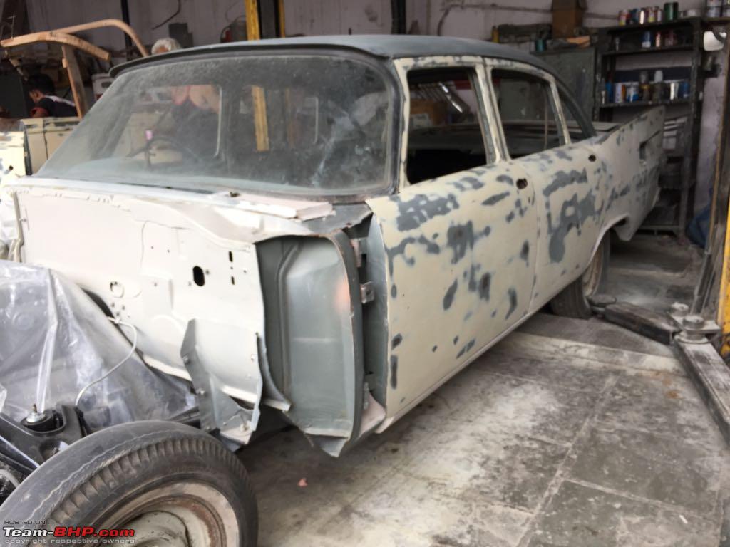

Chassis is fully restored with all new suspension, shockers , arm bushes , steering ends and engine and transmission mounts, all parts imported from USA.
The body has been united with chassis and tinkering work is in progress now.
