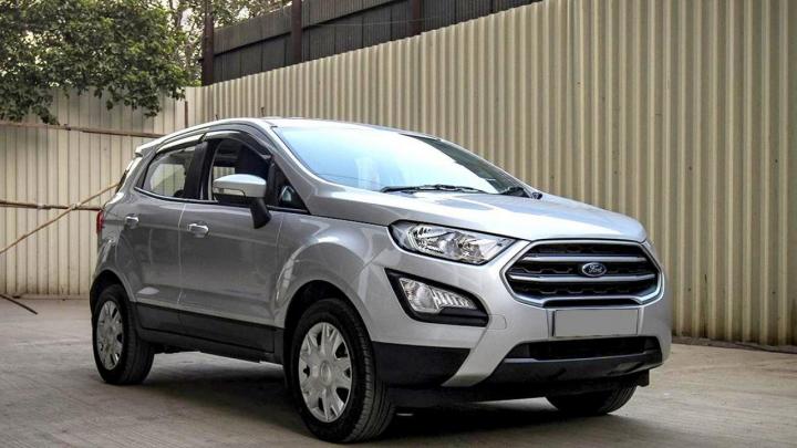

I drive an MY2019 Ford Ecosport BS4 diesel.
Despite a fair share of gremlins, I have come to appreciate how dynamically sorted and well-equipped the car is. I have had issues with the powertrain module (car refused to move/kept revving - pwt malfunction light blinking - which took ASC a week to solve), hill hold function (it switches off on its own), accessory mode (activates itself), all 4 tyres developed bulges (replaced under 5 yr Goodyear warranty but I had to pay 50% of the MRP), reverse camera drowned at 2nd service etc. Add to this how Ford Exchange Assurance abandoned me when the buyer of my old car refused to get the car registered in his name (a story for another post).
My biggest pet peeve though has been the clutch. Not only is it hard/springy, but the travel is just too much. I'm 5'7'', but to be able to fully engage I have to keep the seat way forward which then messes up the ergos. Add to this the bite point which keeps on changing on a daily basis, which makes it feel inconsistent. Nonetheless, one can adapt but what I can't fathom is how unreliable it has been i.e., @ just 18k kms the clutch started slipping and I had to get the clutch replaced (clutch, pressure plate and bearing were changed). Ford denied goodwill warranty and quoted ~ 25K which included the flywheel too, but I found Ford ASCs of Gurugram a bit deceitful and my earlier experiences with them were not great either so, got the clutch overhaul (minus the flywheel) at a reliable FNG for 8k. The clutch retained its poor qualities but the car ran fine.
Now, the Odo stands at 35,000 kms and the reverse gear has started acting up, i.e. it never shifts in one go and makes a screeching whine while doing so. I have been managing by shifting to first before engaging the reverse but now it has really started to bug me. So, I have the following queries:
