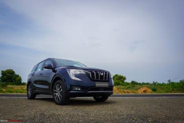

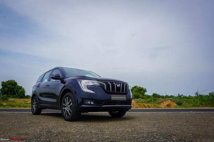

While I had set my mind on XUV700 due to its value for money in the segment, I have read the car being reluctant to start after just 7-10 days of standing still, let alone two months. Is it seriously this bad?
And if the above example is true, does that extend to most connected or ADAS-loaded cars, which means cars like HECTOR, New Safari, etc are out of the question? I feel cursed to have to stick as less techy as possible, since more tech = more battery drain.

As a guiding principle, sadly yes. Even things like the intrusion alarm are a constant drain when armed, so is the auto-sensing of key and auto unlocks going right upto the connected cars like the XUV700(Adrenox)/Hyundai(Blue & Me) and likewise for other manufacturers which constantly maintain a data link with the servers along with geofencing and OTA updates.
You can try the XUV700 MX with MT as that doesn't have the Adrenox and generally the base, base+1 variants which don't have connected features and even keyless entry to avoid higher battery drain.
