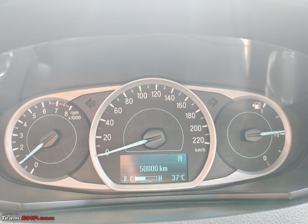

Odo now stands at 52,000.

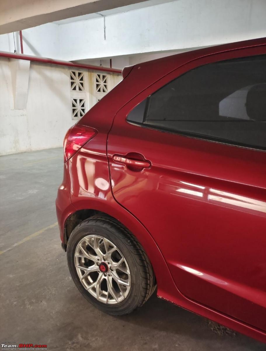

Decided to get the job done at Lal tyres near Sathyam theatre, as I had good experience with them before. Ford's weird PCD meant very few options were there, which actually made it easier to zero in on these beautiful 15 inch 7j Lenso samurai wheels. Details are amazing, and the extra width had totally changed the stance of the ride, car no longer looks like it skips leg day. For the tyres, I went with Yokohama S drive 195/55 R15, so far extremely satisfied with the grip and reduced body roll thanks to reduced sidewall thickness. Mileage has taken a hit though, almost 2 kmpl difference after the alloy/tyre swap( was higher initially).
50k milestone, zero issues so far:
Beautiful alloys with nearly designed Yokohama S drive, not a fan of these red hub caps:

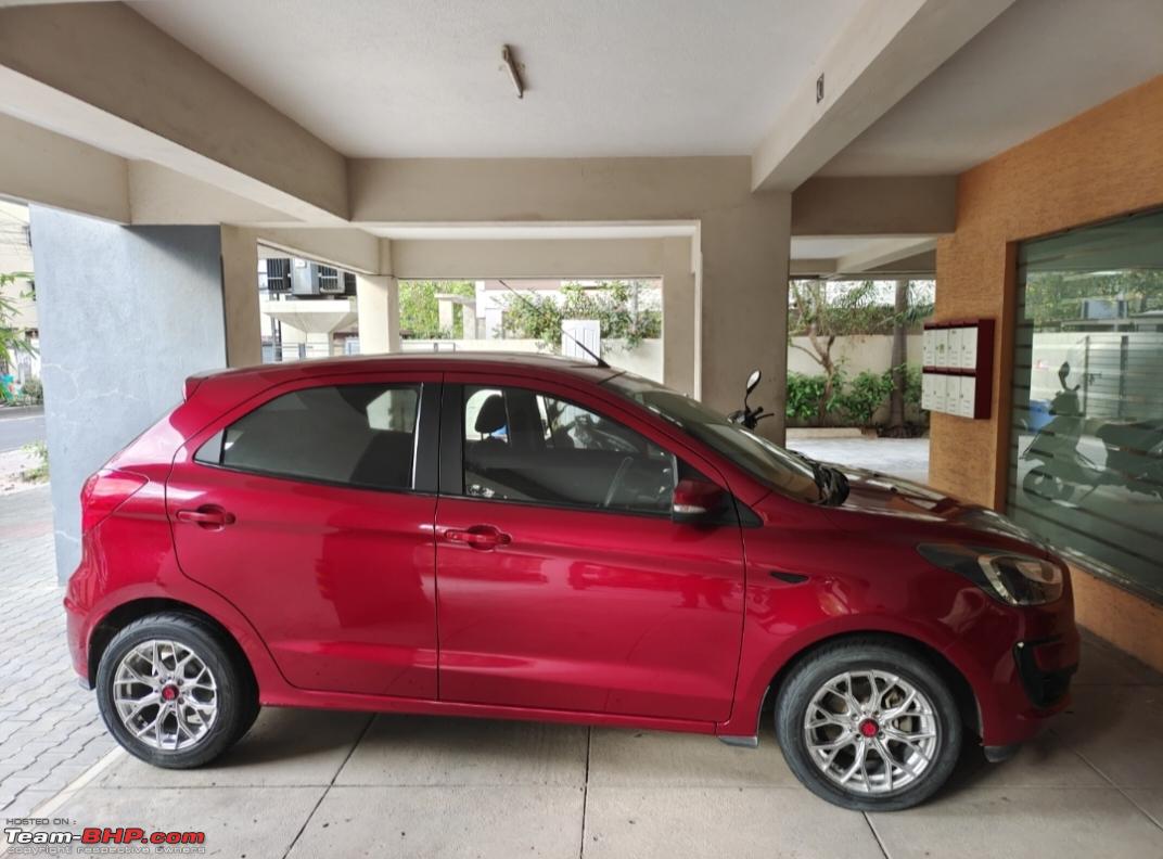

7j = aggressive stance when compared with sad 14inch stock wheels, mud splash is the only issue till now, tyres doesn't scrap even on full steering lock:

Wheel wells filled up with not much gap, suspension upgrade could make this even better:
