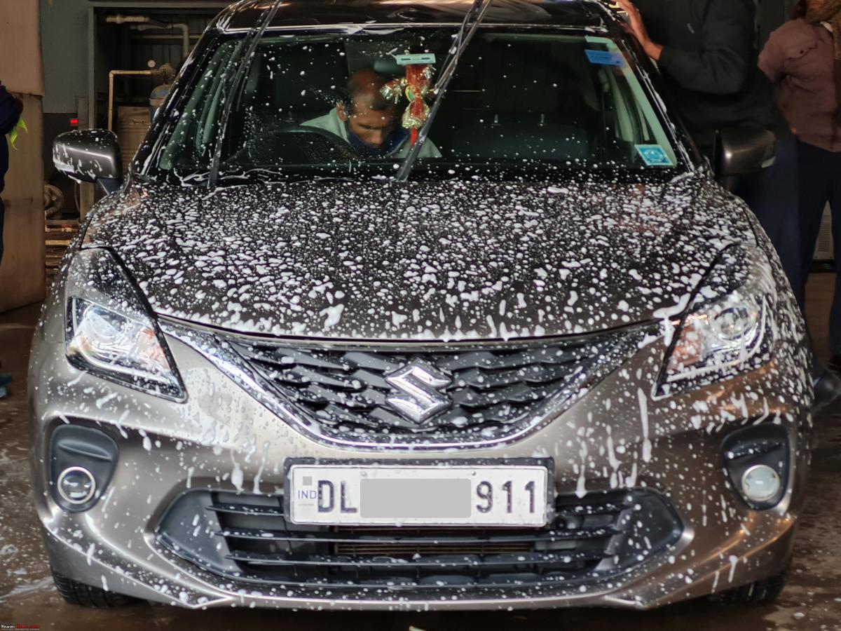

The work started with the vacuuming and washing and mine was the first car in the que. The cleaning team obliged by using my clay bar on the exterior after the foam application:

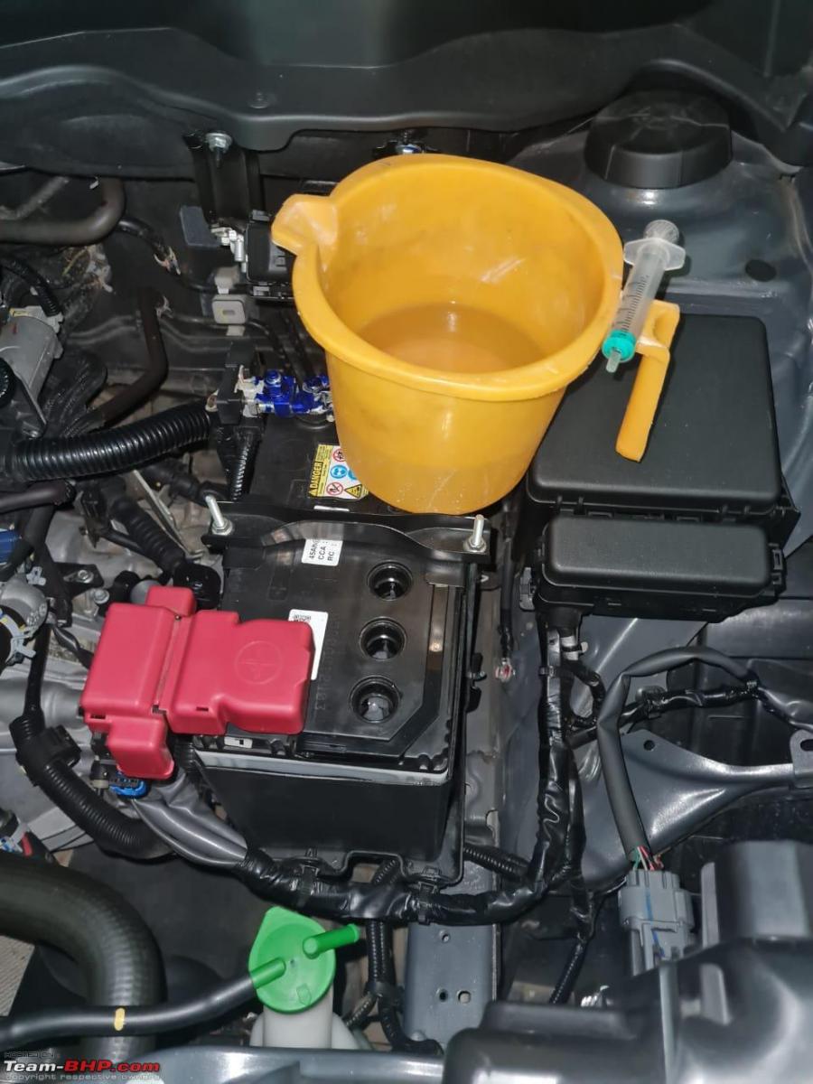

I had reported just one specific concern – to resolve the rusting that had occurred around the battery clamp and tray area – as they had overfilled the distilled water in the last service:
It was promptly resolved with the mechanic first removing the battery, cleaning the terminals and base with hot water, drying the entire area with pressurised air, and finally changing the clamps and screws with new one:
The team ensured that this time around they fill it to the appropriate level and remove the extra water using a syringe:
The battery readings were taken down as well and the health came out to be good, with need for some recharge:

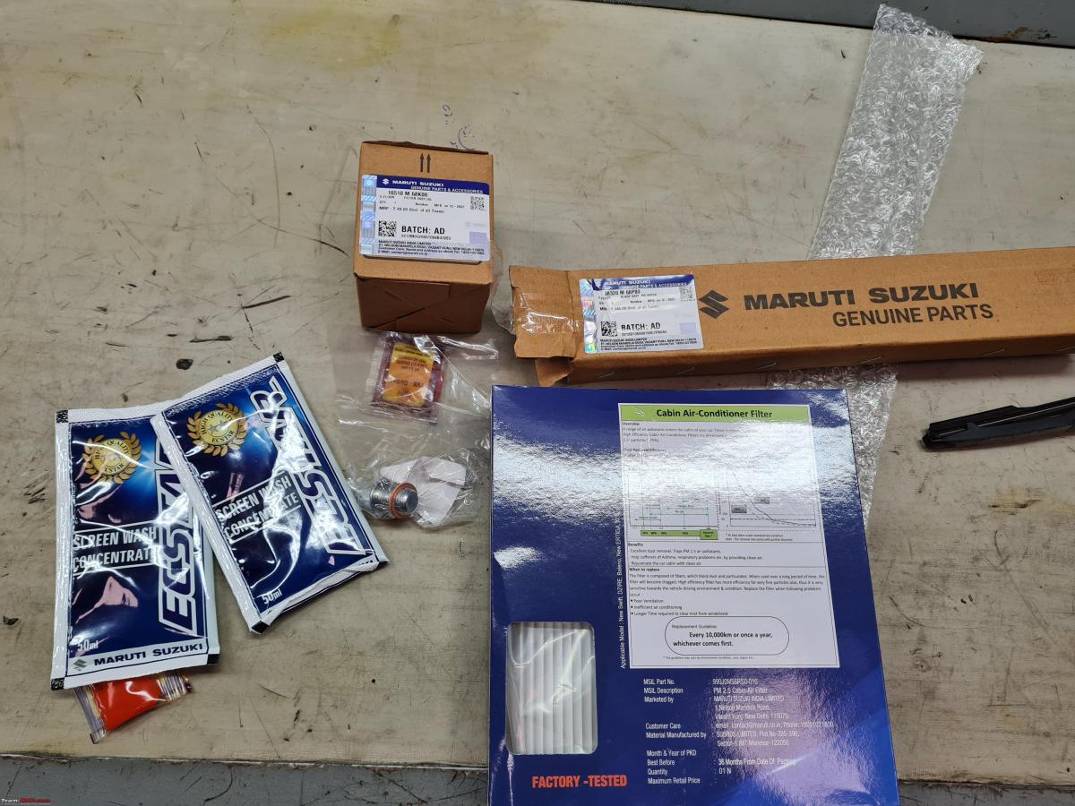

The other scheduled tasks part of the preventive maintenance were also diligently done with the car being stationed at the service bay:
The jobs performed:

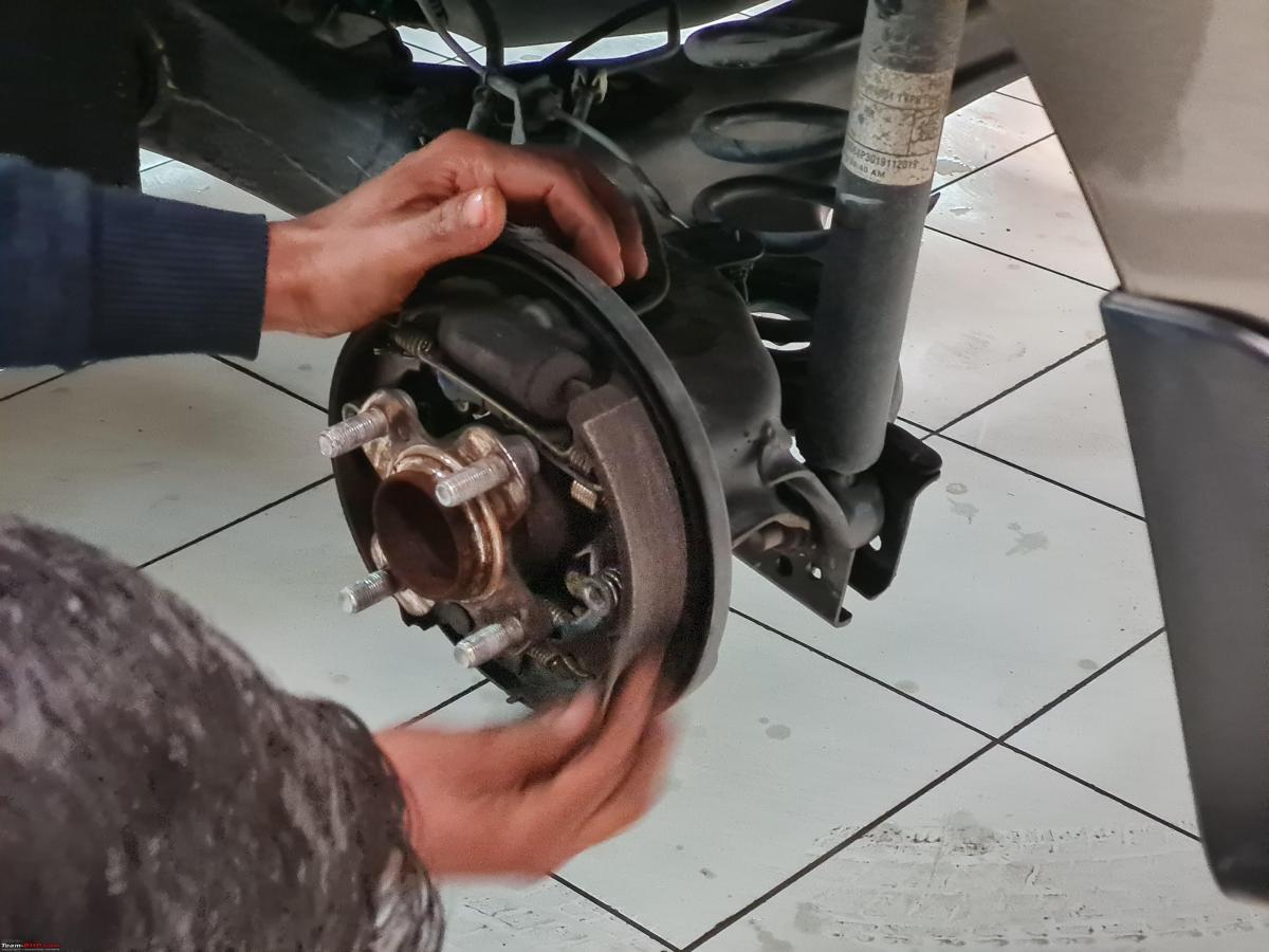

The brake cleaning in progress:
After the head technician did a thorough underbody inspection, and the tyre rotation and alignment was done, I was taken on a test drive to see if everything was in place.
