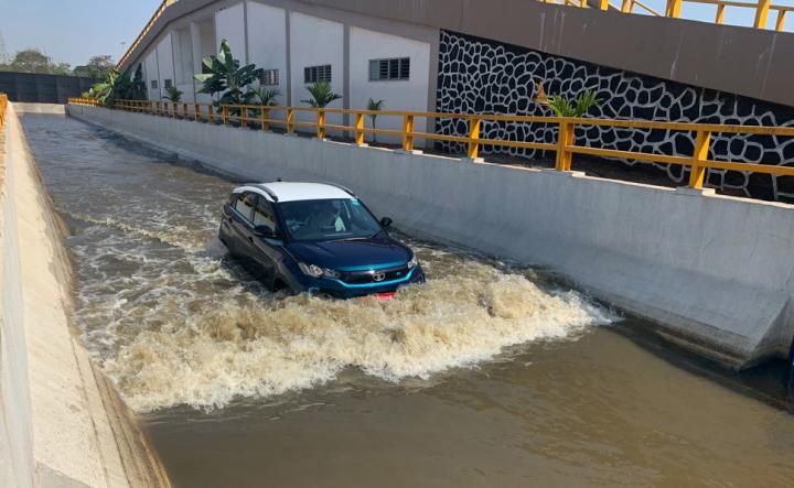

Not from Bangalore but in Pune the Tata Tigor EV handled waterlogged roads like a BOSS! Where other sedans we’re waiting by the side, the Tigor EV effortlessly drove through almost 12 - 14 inches of water. I am sure the Nexon EV with higher ground clearance fares better.
The biggest fear of water entering your exhaust pipe is not there. Of course the wires are exposed but standing water doesn’t really have much impact.

Obviously since there is no air intake for combustion, an EV does not have to worry about wading through flooded roads. I once got extremely pissed off recently when I had just finished taking my Kizashi (155mm ground clearance) through some deep-ish water and once I had got to the other end after nursing my car through like a champ keeping its revs up high, this idiot in a Nexon EV decides to block my path by aborting his attempt through the water and taking a U-Turn Seriously, EVs should have no problem going through flooded roads. Given you understand the road you are going through and there isn't any fear of getting stuck in potholes and all that.

Most of the EV batteries are sealed. Even if these batteries have liquid cooling or not, the Battery is sealed, but it will have the needed inlets and outlets for the coolant to pass through.
The terminals of the battery are coated with heavy rubber or other synthetic material to sustain wear and tear and not to short circuit with any elements. All wiring [related to propulsion] are heavily coated to ensure nothing/no one could touch it.
The motors are sealed too, but the gaskets used shall determine the water wading depth.
Technically, you can use your EV in water as a boat if built well. Here is an example.
