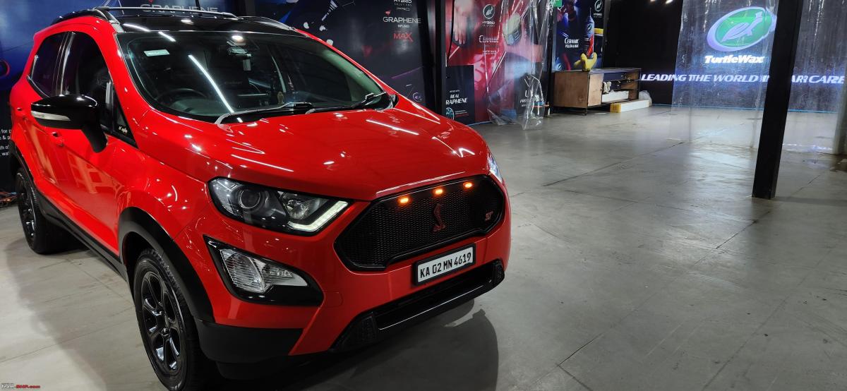

Detailing at Turtle Wax: 12,000
Post detailing!
So the total cost for my joy is Rs 3,55,600. I’d say it’s very reasonable as I’ve travelled across 24 states in India and this car has been like a mini house on wheels for me. Heck, even flights to travel so much would have been way more expensive(also the unlimited luggage carrying capacity while driving your car is priceless!). I haven’t included the washing cost as that is frequent and imperative to keep the car clean.
