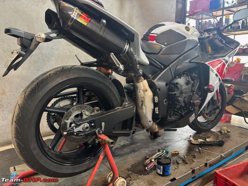

Now that both side rearsets and associated pieces surrounding the swingarm has been removed, next to come off was the side fairings on both sides.
Now if you are wondering why this much has to come off, well at first we thought just removing the slip-on and cat-con would give enough access to get the job done, but that would mean lifting the bike on a jack stand underneath the link pipe but later it was decided it might not be a wise choice. So the executive decision was made that the full exhaust system right from the header pipes would be removed, hence the detailed strip-down of the bike.

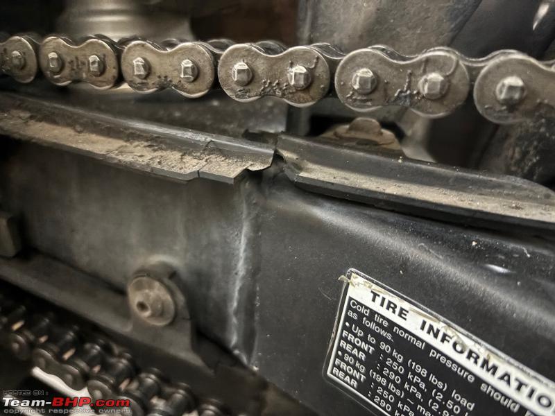

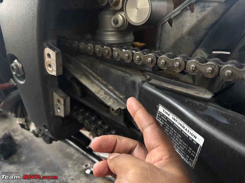

That is when another thing came to my attention, yup, yet another part on the bike that will need to be replaced, the chain slider upon reaching this stage of disassembly has been fully cracked and started to turn into powder at some places.
The toasted chain slider
This again is a rubber part that has just become hard and brittle over 11 years of worth of heat cycles and abuse
