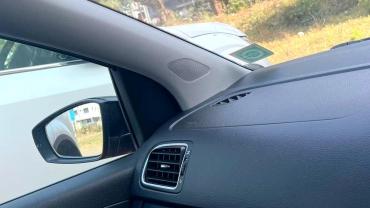

Overall, the treble improvement is definitely felt and it adds a lot of character to the car's audio that is delightful. Since I didn't get a chance to click pictures like I'd usually do, big thanks to my friend and fellow BHPian Mayur Shinde, for sharing the below two pictures from his Polo and for helping me add value to this post.
