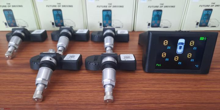

Received items:
1 sensor was manufactured on 30th June 2021, 3 of them were manufactured on 27th November 2021 & the final one had a manufactured date of 20 December 2021. The display is of 30 March 2022 manufacture.
Marked each sensor with tyre code: FL, FR, RL, RF and S, using a permanent marker for later identification.

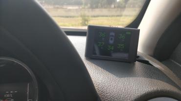

Fitted the Display to the right of the steering wheel column console. The Unit comes with a strip of 3M double-side tape on the front half of the bottom. For a better fit, added a strip on the rear half too. The placement was based on easy access to the three buttons on the Display’s right side with enough space on left for connecting the charging cable if so required anytime. The Display does not stay switched ON all the time. What I have observed so far is that once the vehicle starts after some time (I think triggered by the motion of the sensors which then transmit to the Display), the Display switches on and shows the status. Of course, one can manually switch ON using the buttons to check at any time.
Display fitment:
