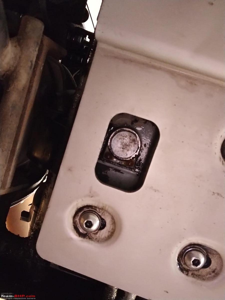

  • While performing the servicing before the trip, I observed oil drops. I was informed that this was because of the excessive chain oiling. Something I did not buy but could not reject as well. Coming back I understand that oil is indeed dropping off and I now need someone to check and advise from where are the drips happening. The drain bolt might be the culprit, but somehow I think that the oil is seeping from some other place and then dripping from the drain bolt surface.
I have a bash plate attached and therefore cannot clean the entire bottom properly. The bash plate though can be removed at home but then the fact that one of the support mounts is at a very odd position, I will have to have this removed (for closer inspection) at my technician's.
On the 27th, After I noticed the oil drops, I cleaned up the bottom pushing in the cloth to the extent possible.
On the 28th, I observed oil drops and on inspection from bottom, I observed a reverse mountain forming up.
Though the initial suspicion is of a loose bolt, but this morning I observed that the drops are forming at the sides of the bolt. Also when I wriggled my finger around, they touched clean oil from surfaces away from the bolt.
This makes me suspect that the oil leak is happening from some other point. Might be from the section where the strainer is located as it was removed and then reattached or from the other bolt up north, from where around 150ML had come out. A complete flush of the engine oil had been performed before filling up with the Semi-synthetic, which is now dripping merrily. Good that I have around 600ML still with me, something which I intend to top up before taking Amun-Ra to the hermit

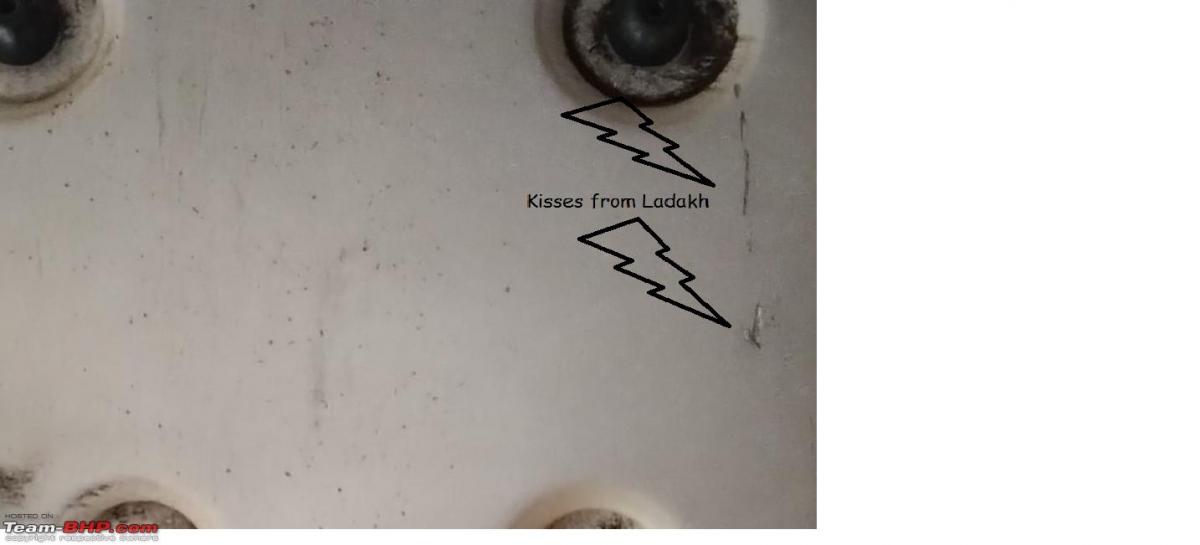

Just Noticed that Amun-Ra had a sweet rub on its bottom too
Source of oil leak identified and it's the O ring which needs to be replaced.
Below is an image of the O-ring that remains connected to the Kick shaft. Notice the wear and tear on this piece.
I was not expecting that these rubber O-rings have a metal underlying layer. Quite a design aspect I must say. Obviously, this is used to increase strength.
