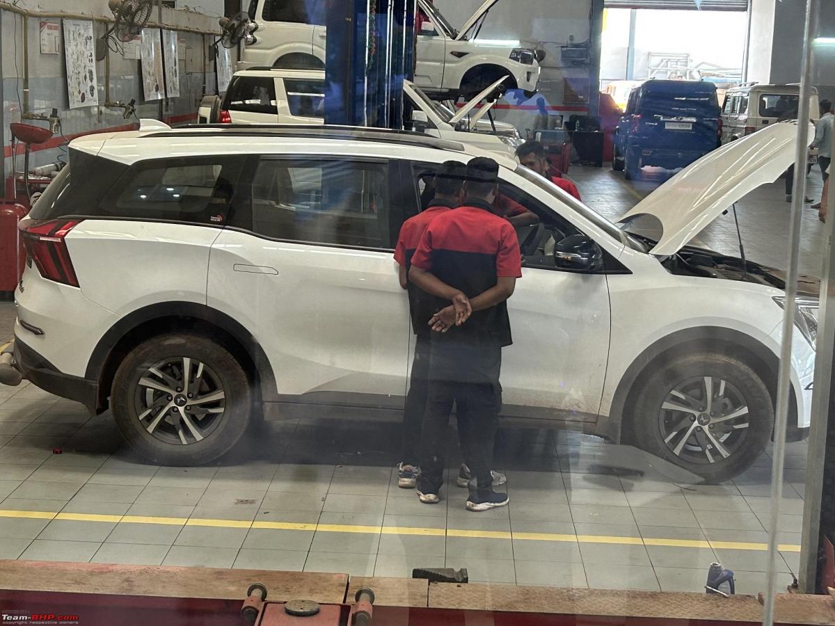

Delayed by a month, I went to get Icarus's 2nd Free Service done at the local BR Balaji LLP dealership on Thursday, 25th May (exactly 13 months since Icarus came into my life). They had become operational in mid-May and have now started catering to XUV7OO owners. I called up beforehand and booked a slot. Reached the dealership at 10:30 AM.

Dedicated ramp for the XUV7OOs at the BR Balaji ASC.

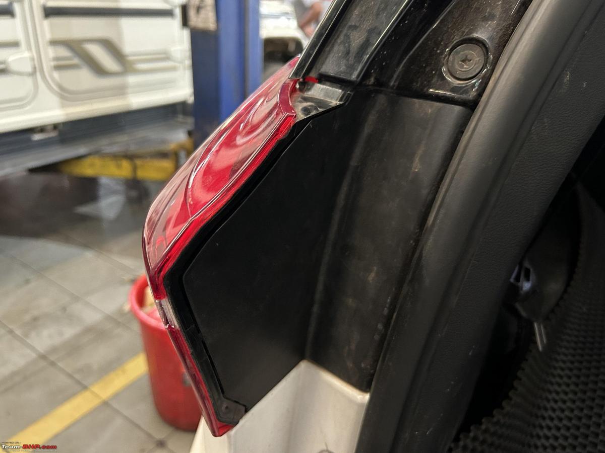

They then checked the rear tail light flaps (called water shed flaps) for which I had reported slight rattling sounds and had noticed that they were not fitted flush with the tail lights. The techs discovered that all the locks in these sections were broken - possibly by the lads who did the fitting of the rear sequential indicator-equipped tail lights sent by Mahindra back in December at the Paramount dealership in Jeypore, Odisha. They showed the flaps to me and it was disheartening to see these OEM parts damaged so badly! They didn't have these in stock so placed an order promptly for the same. Till then, I have to make do with the broken flaps.
These tail light flap sections were not fitted flush after the swaps.

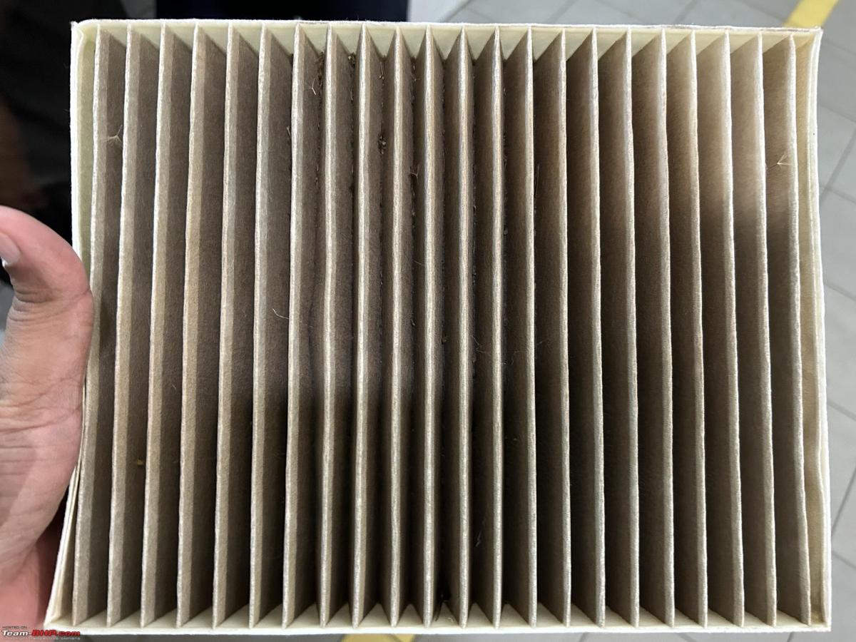

Mechanical checks were completed and fresh engine oil was poured into the engine system. Icarus was the first XUV7OO they were servicing so it took a few minutes for them to familiarise themselves with the engine oil inlet and the oil filter area. The air filter was still good to go for possibly another 5,000-6,000 km so they cleaned it thoroughly and put it back, but the AC filter was completely gone and was beyond cleaning. Got it replaced. DEF was at 72% so skipped topping it up for now until it comes down to 50%-ish levels, as was advised by them.
The VIN check showed an EMS (Engine Management System) update pending, so that was completed next. The suspension control arms & their related bushes were not in stock and were promptly ordered. By this time it was nearing 4 PM and I had a prior engagement at 5. Paid the bills and left by 4:30 PM, promising to return on Saturday to get the remaining jobs completed.

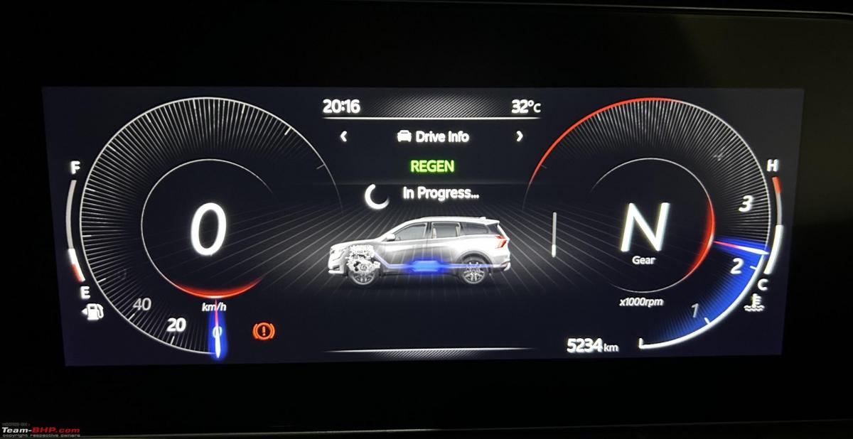

They then took Icarus up on the ramp and got the fuel filter drained. All fluid levels were good to go, as was the battery. The brakes had plenty of life left in them, and the tyre checks and underbody checks sprung up with no surprises. DPF was at 7% so no problems there as well - not surprising because Icarus had demanded a parked Regen 2 days prior to this, on the same day the first half of the servicing was done! Got all the wipers checked as well, and got both the front wipers changed. That was the only job which incurred charges that day.
