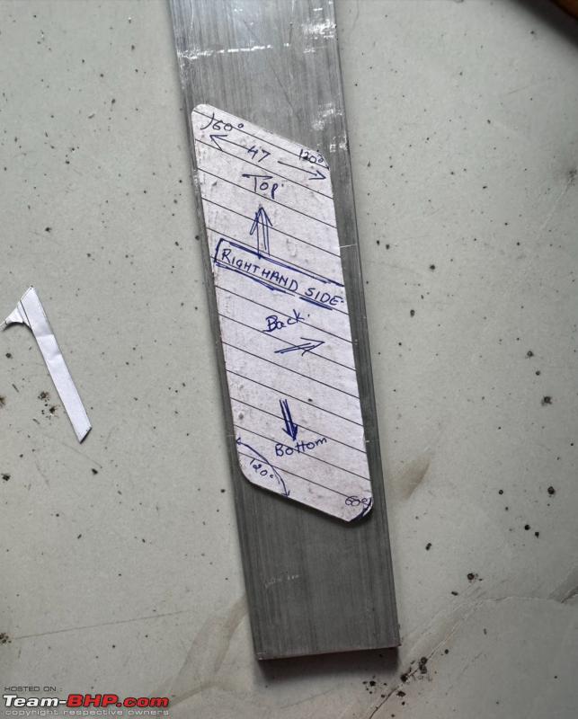

Next up is the plastic fins that fit on the side panels that are missing on the RD 200. Very difficult to source and next to impossible to get a new set.
So, the next best option is to make one in aluminium

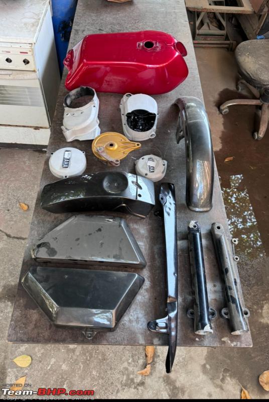

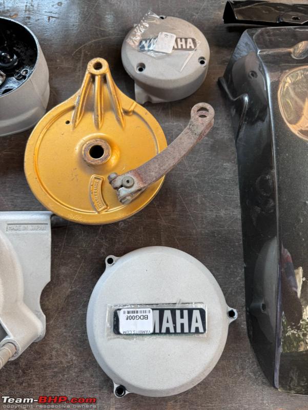

The RD 125 parts are ready for paint. As I said earlier, the cosmetic details on this one are not complex to capture. Notice the side panels are plain with no fins. The second time they will be painted and I am glad that the Titanium grey shade never actually turned into a complete bike.
OE Yamaha badging that will go on the engine covers after the paint but before the clear coat

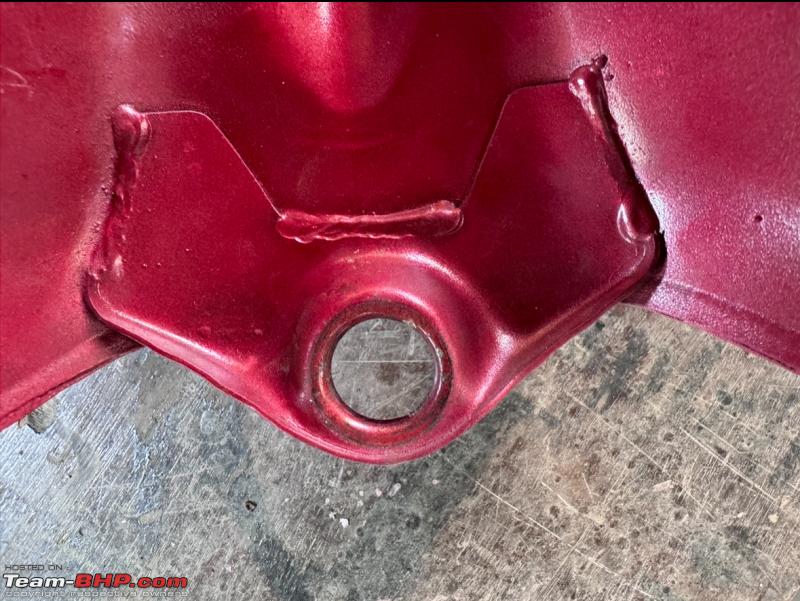

Trying to capture the details of the coffin tank
Preparing for paint
Took off the rubber mount and fuel transfer tube

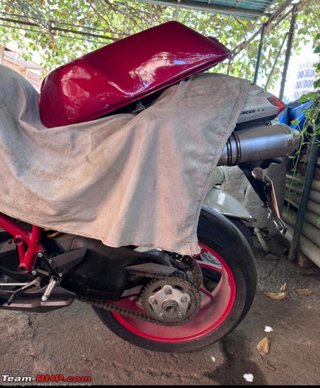

Time for some in house paint colour inspiration
Ducati red it is with pearls

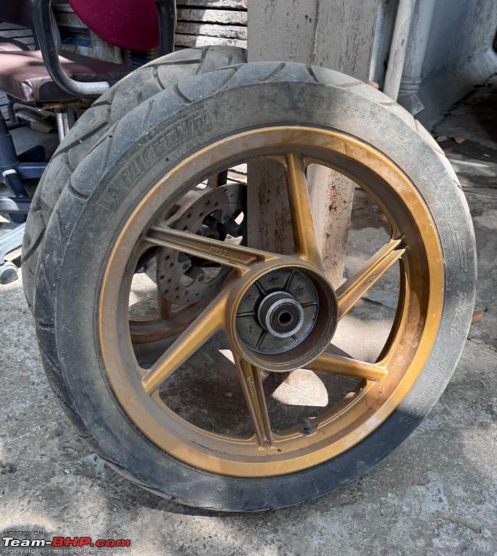

Golden wheels will turn all black though
Never used 15 year old rubber. Rebuilds on rear bikes are never cheap and you can never have a fixed budget especially if you’re seeking PERFECTION

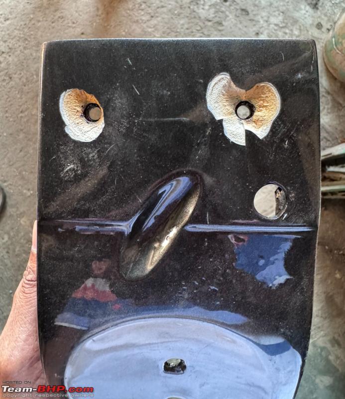

Rear mudguard with the chassis mounting and taillight mounting holes
Will be sanded down to the metal

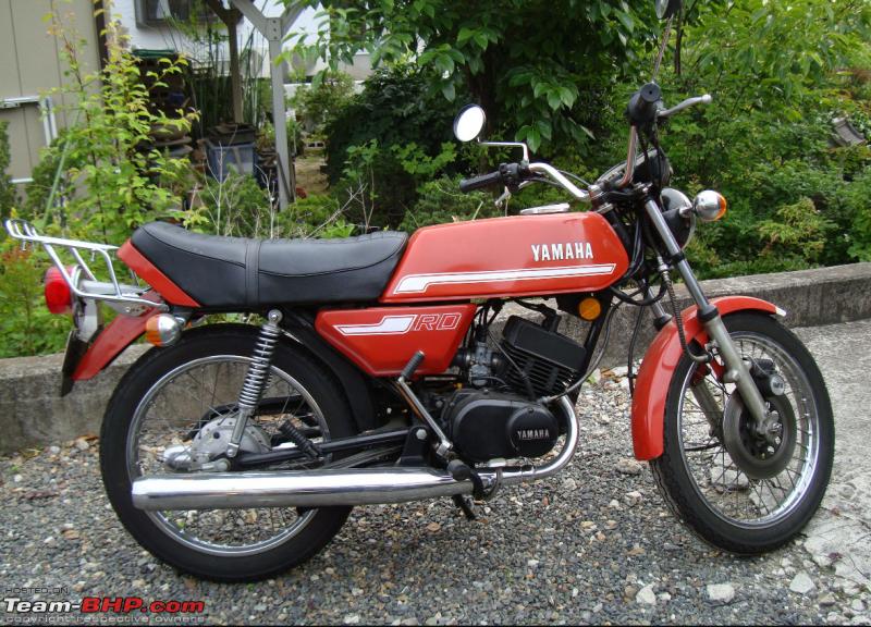

This is how my RD 200 would have looked back in 1979
Mine though will have a lot less chrome
