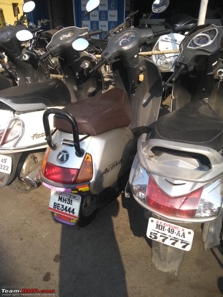

Above photos at Vasant Auto Centre with its tribe.
Above photos also at Vasant Auto Centre.

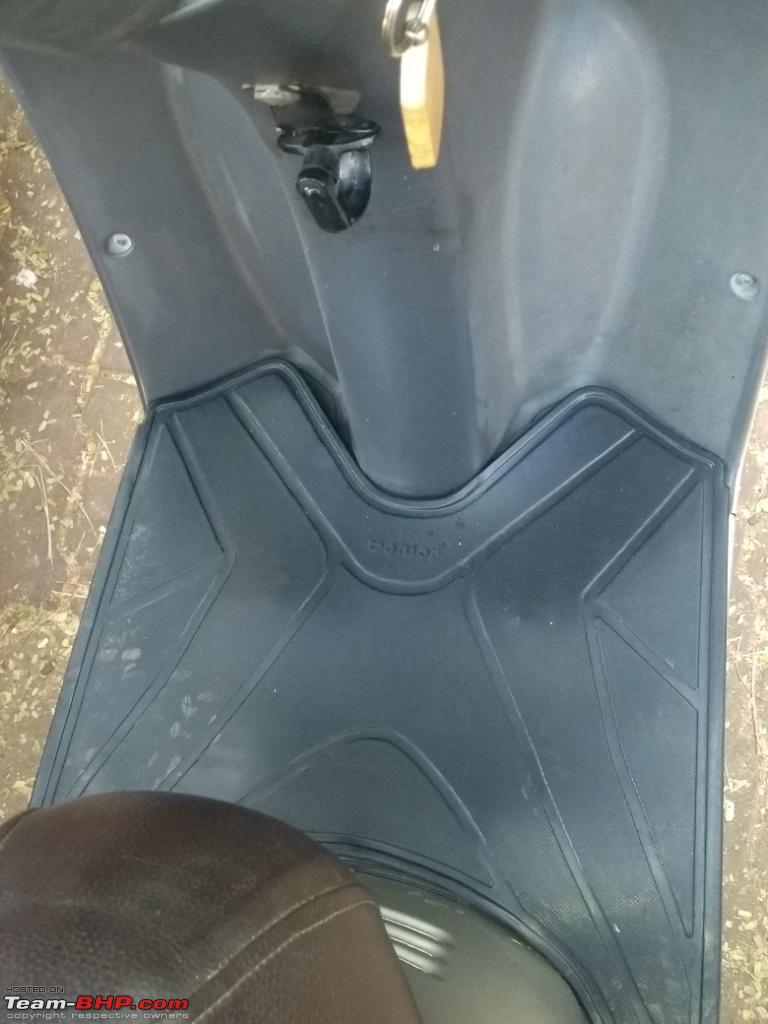

The new mat covering the OE mat- a brand new design.

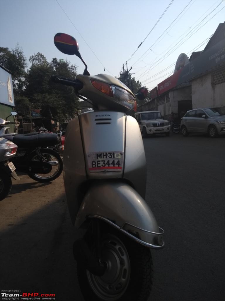

At an office en route to work.
