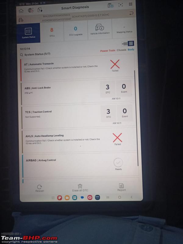

We got many codes, some of which raised more questions than they answered. First let me share the codes themselves, below:
Some notes from the codes:
  • The airbag light is on but there are no codes for that. Strange
  • There are 2 distinct definitions for the same code, C1256. There's no height sensor on my car so I assume the other one is relevant to me.
  • The wheel speed sensor on the Rear Right is suspect - either a loose connection or a malfunctioning sensor.
  • There is no auto headlamp levelling system on my car from the factory, so we'll be ignoring that code.
We'll check out the wiring for loose connections in the relevant areas e.g. the TCM error and the dash issues are surely related, probably due to a loose connection or rusty contacts (I should've handed my mechanic a can or two of contact cleaner when he was putting the wiring back together, in hindsight).
We're fixing the low-lying fruit first, namely the wheel speed sensor, the brake switch wiring, and the TCM to ECU wiring. Fingers crossed that solves all of the codes.
