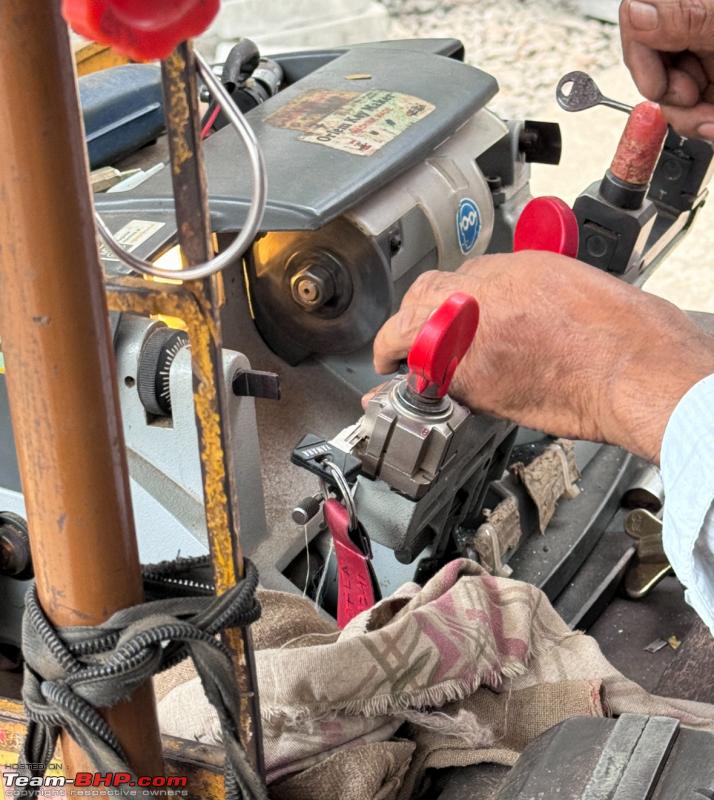

Getting a spare key made as Eddie only had a single original key. Being an odd size needed some extra effort to find and make the right one
