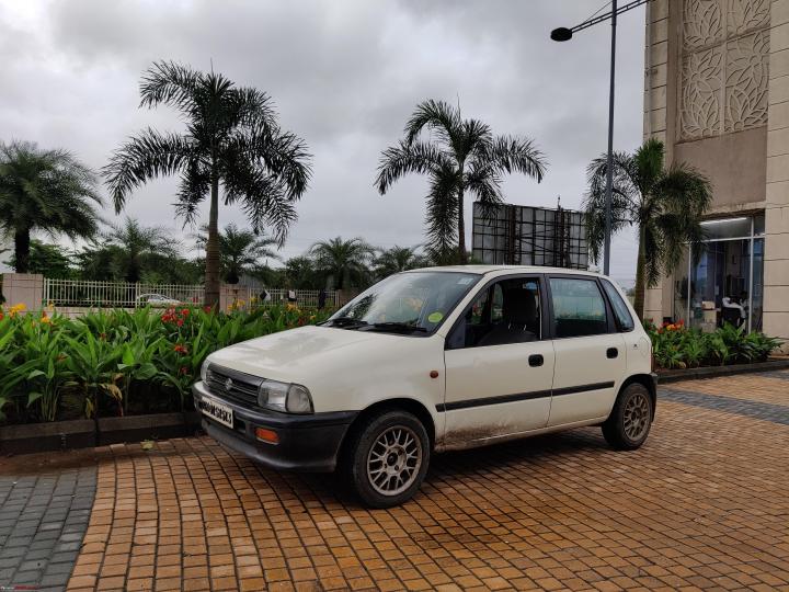

Need advice: Irritating stalling issue on my 2000 Maruti Zen
It starts immediately and idles well. But the moment I shift into 1st gear and accelerate, the engine appears to choke up and shuts down.
BHPian pheru8b recently shared this with other enthusiasts.
I bought one of the last Zens which had a carburetor in 2000. The car has been a reliable companion all these years, and I have done over 90k km in it. I even proposed to my wife in the car, so letting it go isn't an option!
Now 22 years old, the engine has a strange issue.
It starts immediately and idles well. But the moment I shift into 1st gear and accelerate, the engine appears to choke up and shuts down. After 3 to 4 minutes of idling the issue reduces, but doesn't go away, so while I can drive the car, every time I accelerate, it first slows down, struggles a bit like it's timing is off, then slowly, very slowly, starts to pick up speed. It works fine till the next red light, when this struggle starts all over again when I start driving from stop.
I've tried 2 mechanics, and both are nonplussed. I've changed the air filter, engine oil, spark plugs, carburetor, to no avail.
Can anyone please help me, or recommend a good engine specialist is south or Central mumbai?
