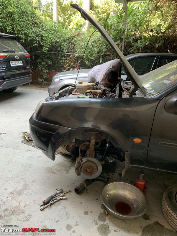

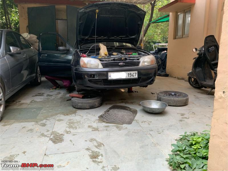

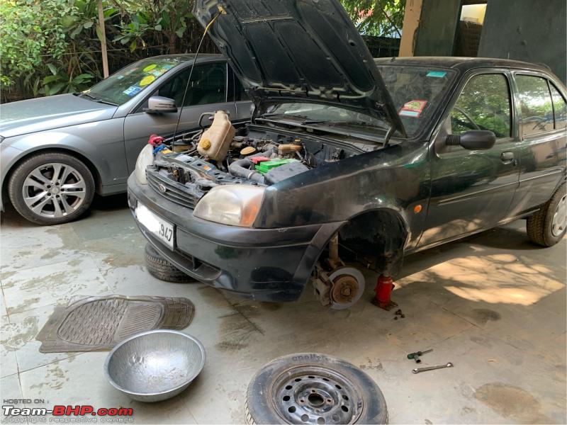

They began by hoisting the car on a pair of jacks and removing both front wheels:

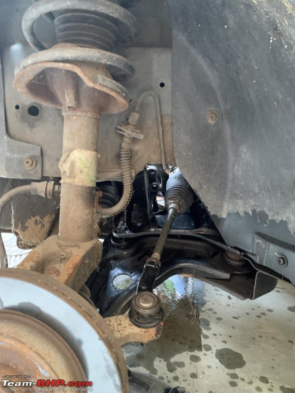

The rack was then unfastened from both ends:
The old rack that was pulled out. Notice the stuff that came out of it; A mix of PS fluid, water and other contaminants:

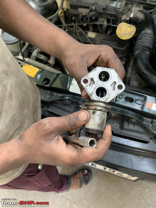

Took the car for a short spin on closed off private roads and was satisfied with the steering feel and feedback. However, I found it to be a little sluggish in the lower gears. The mechanic sprayed the IAC valve with throttle body cleaner, and that certainly made a difference:
