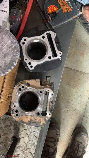

I figured out about the big bore kit for Himalayan. There was one from NMW Racing which is a trusted name for its rally and racing circle. There were 3 kits; 450cc, 470cc and 500cc. The last one needed the boring in the crankcase and needed a special drill. I couldn't source any trusted guys for the job even in my extended circle. So 470cc kit was ordered. It came with forged pistons (83.5mm) and extra gas kits and a couple of main jets, eventually the 125mm stock jets turned out to be the best fit even for the bigger bore.
The installation took mere 4 hours at my trusted mechanic's shop. I wish I had more pics taken while installing. I also installed a big sprocket for the rear.
Just to please my eyes, I removed the stock headlight setup and installed led lights on custom-made brackets.
There's a 25kph extra on the top speed even with a bigger rear sprocket. I expect it to be in the order of 165kmph+ with the stock sprocket. The revs for an extra 1000rpms which is way beyond my expectations. The setup seems to be reliable.
