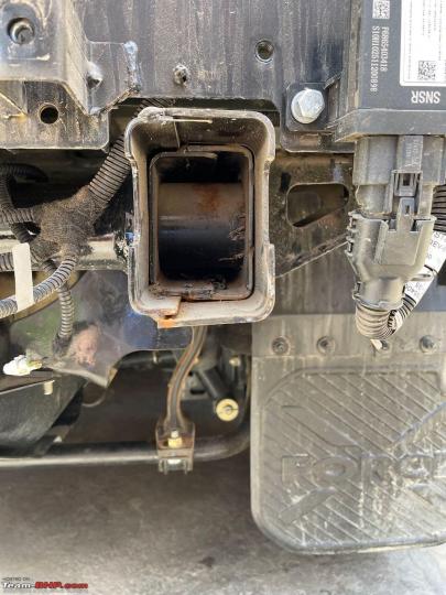

Frame Rust Proofing: Gurkha's Frame has poor paint protection, unlike the body shell, the frame is not dip coated. It is simply painted from outside without primer, main member internals, cross member internals, under-mount points, etc do not have paint. It was a real pain to do frame rust proofing.

Internal of the frames as seen via cable camera, you can see rust, MB like spacer and C-in-C overlap joint as well. Internal of one side of center frame piece was painted though.
Rear-end, this C-in-C overlap extends till the front of the rear wheel arch, it's painted just at the end.
I used RustOust in 50% concentration sprayed throughout via various frame holes and kept it wet for a day, then used a pressure washer with swivel head + zero deg attachment to clean up the rust. (If rust is thick just repeat, if you can reach and scrub that would be good too).

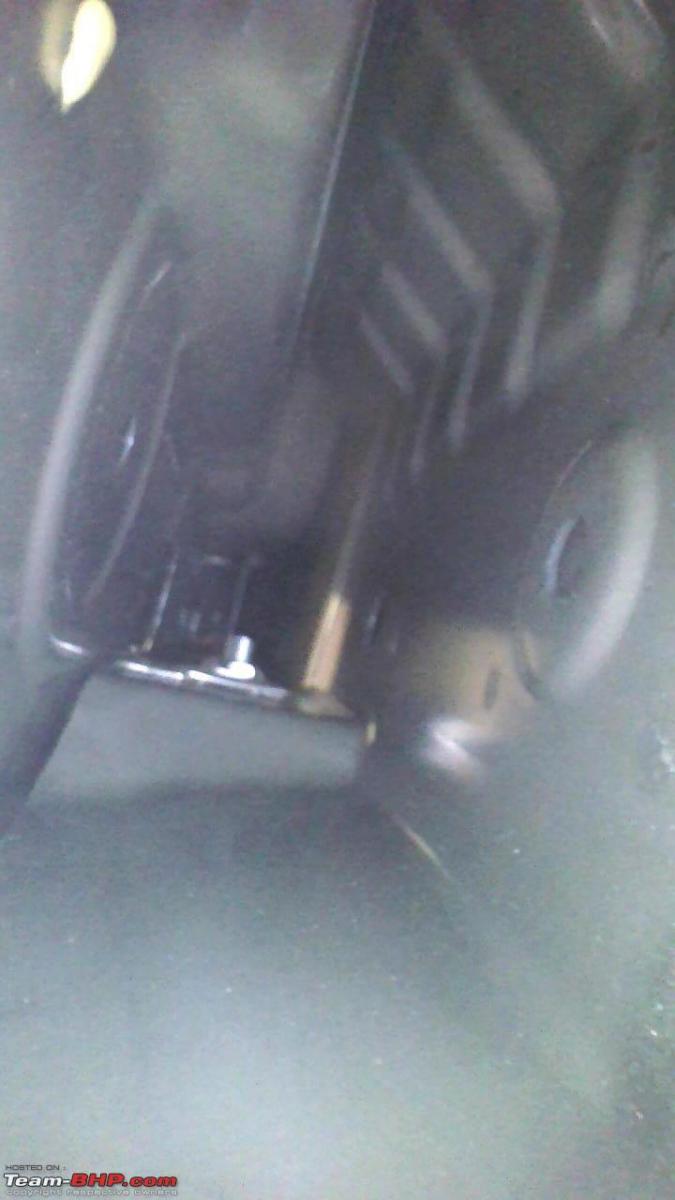

You can see one side of center piece has paint or coating, white/grey is bare metal, poor resolution of cable camera makes it look like paint.
I used 3M underseal with a small quantity of slow curing thinner for better spray/flow inside the frame, 3M underseal has very good adhesion over rust.
Taking a clear pic is hard with a cable camera once the internals are coated black, this one is a phone shot through a paint hole.
