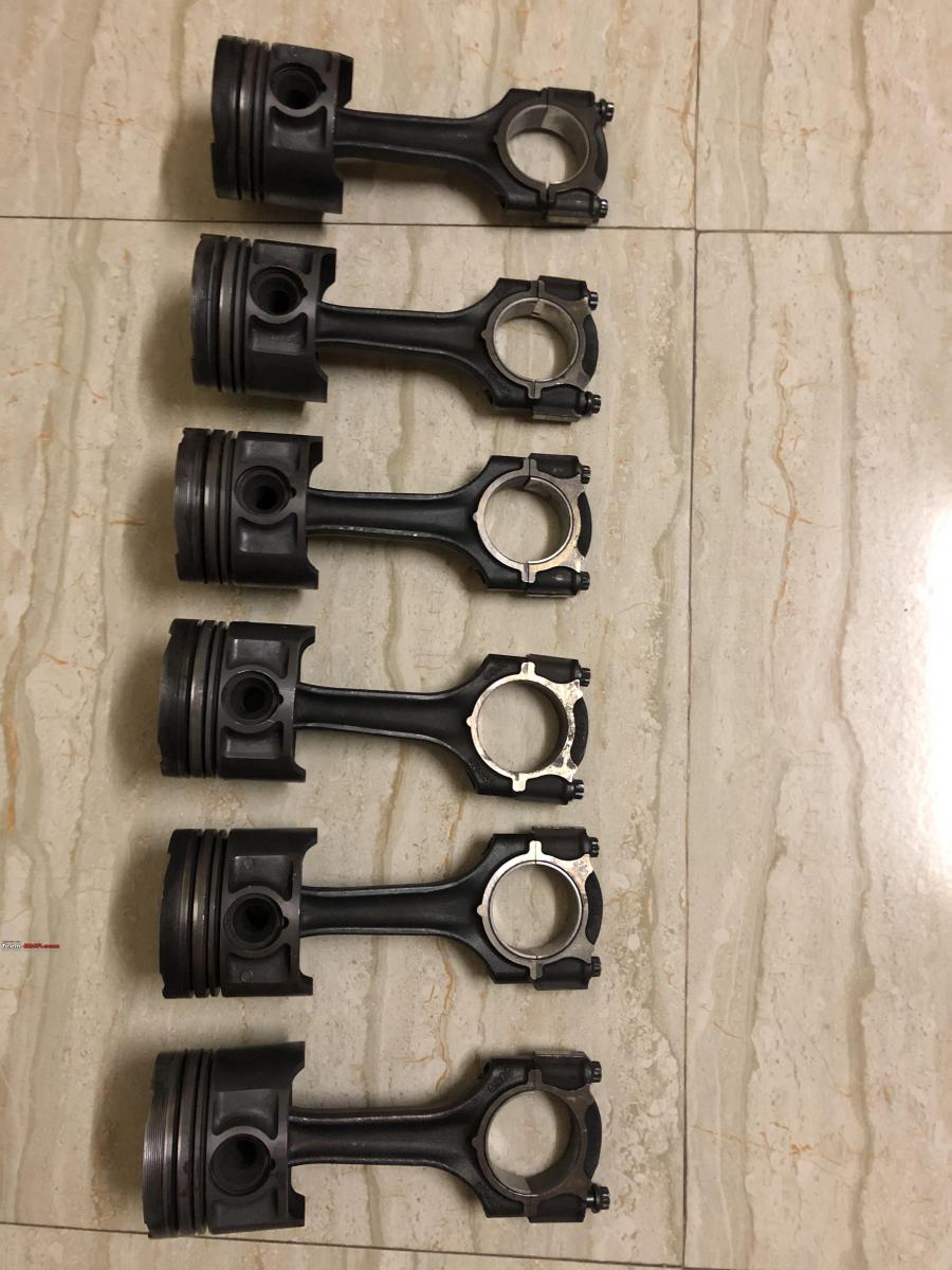

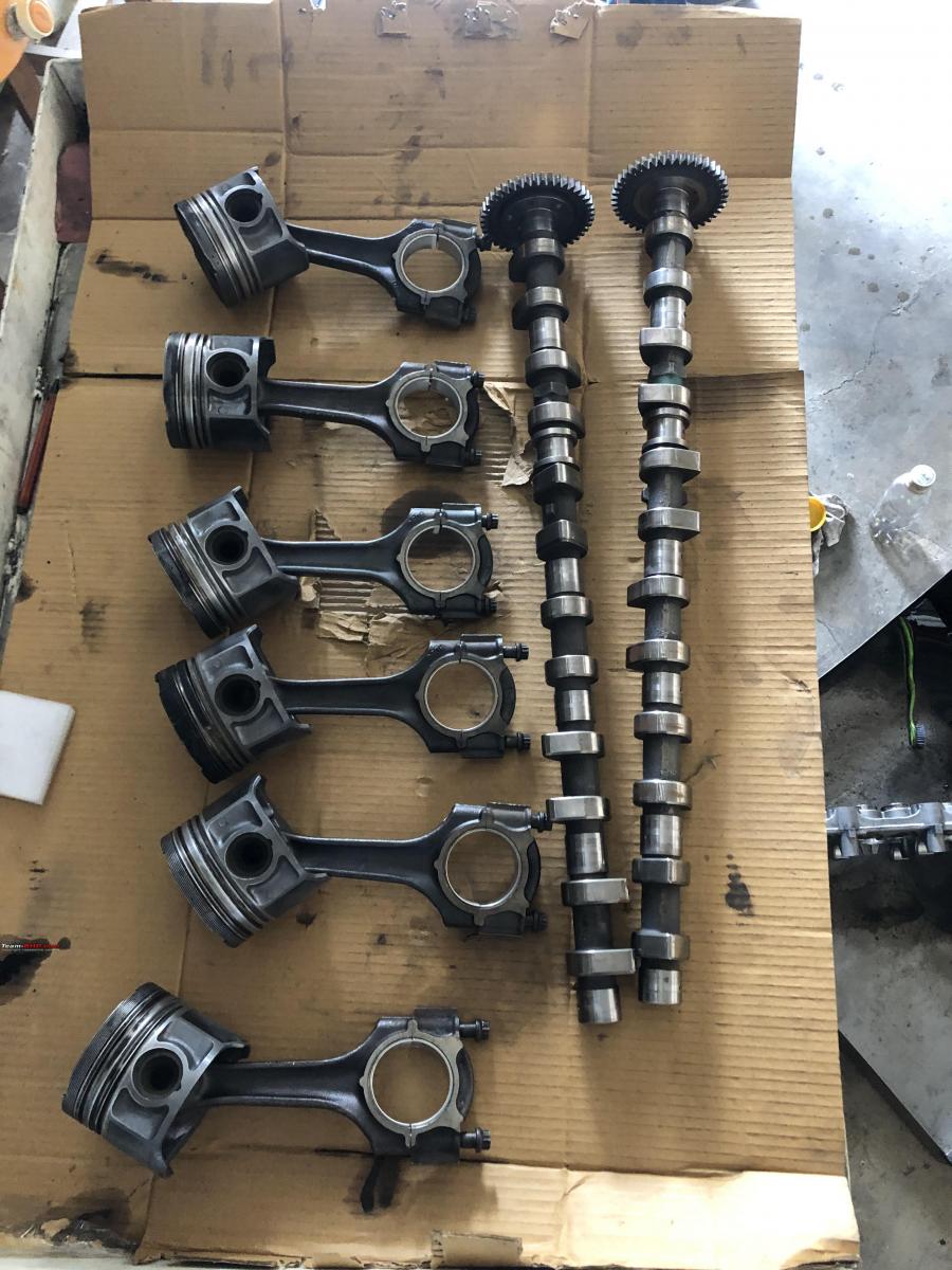

So, we decided that instead of going with forged pistons and rods, we imported used OE turbo pistons and rods from Sweden. They were in great shape (expected from the Mercedes parts of that time).
The block is pretty good in both unit and so is crankshaft, so with new rings and new valve seals, polishing, balancing pistons and rods, we made a reliable & capable unit, which would serve a long time.
And we didn’t have to do a lot of changes considering the amount of time, work, efforts on it plus its now an OEM+ unit.

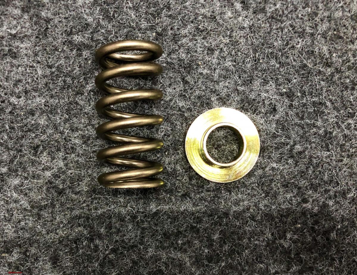

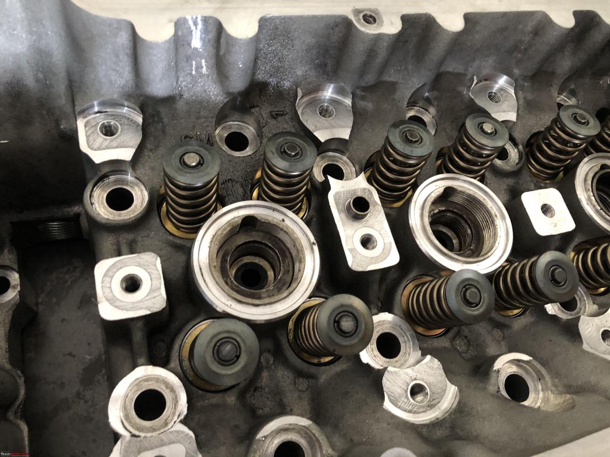

KM CAMS 8000 rpm VALVE Springs
OM606 is a high revving diesel engine with a rev limiter 5500 rpm in stock form. When power output is increased, its a natural practice to raise the rev limiter to usually 6000 rpm (have seen one OM606 in MKIV Supra doing 7500).
Now, the issue with raising the rev limit is valve tends to float at high power levels, so usual practice is to limit fuel when its about to reach 6000 rpm. This means not able to get the real benefit of raising the rpm limit.
Solution:
8000 rpm rated valve springs with undershim from KM Cams.
Yes, we got no plan of going over 6500 rpm to maintain the reliability plus our desired power goals come well within 6000-6200 rpm. But its better to have an overbuilt unit than to worry later on about stuff.

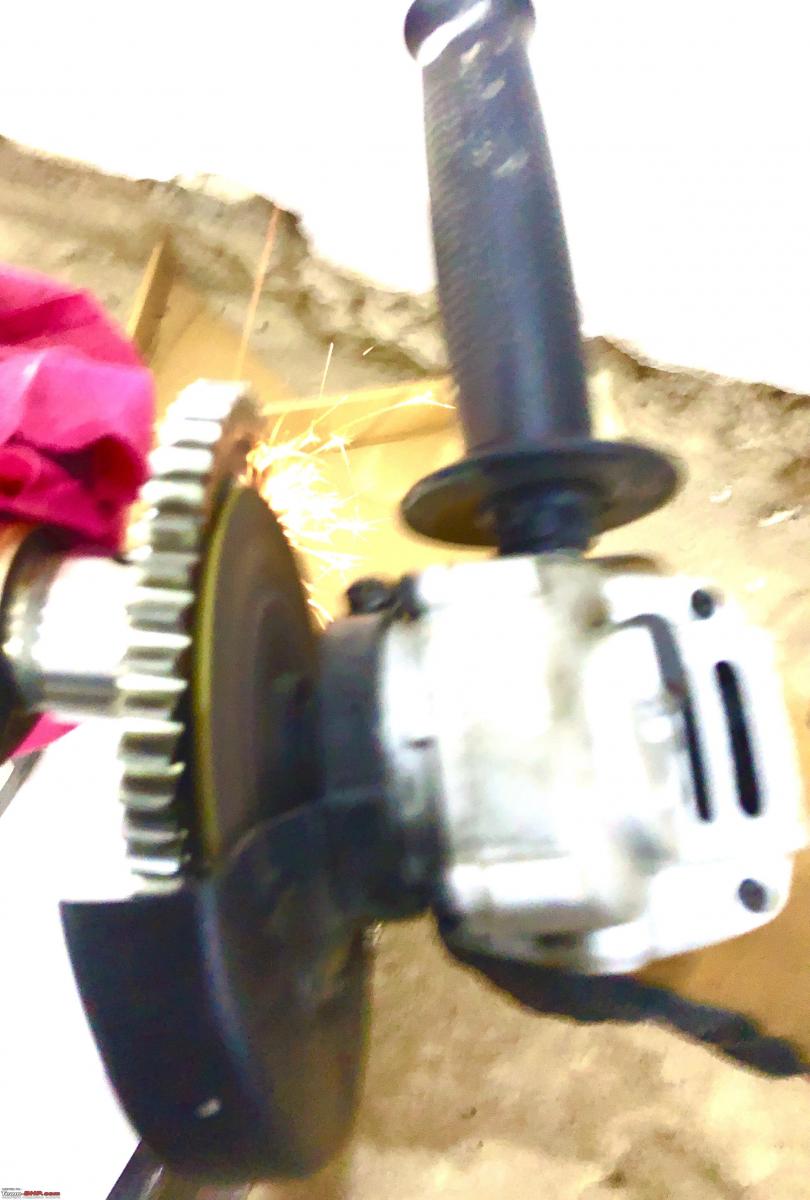

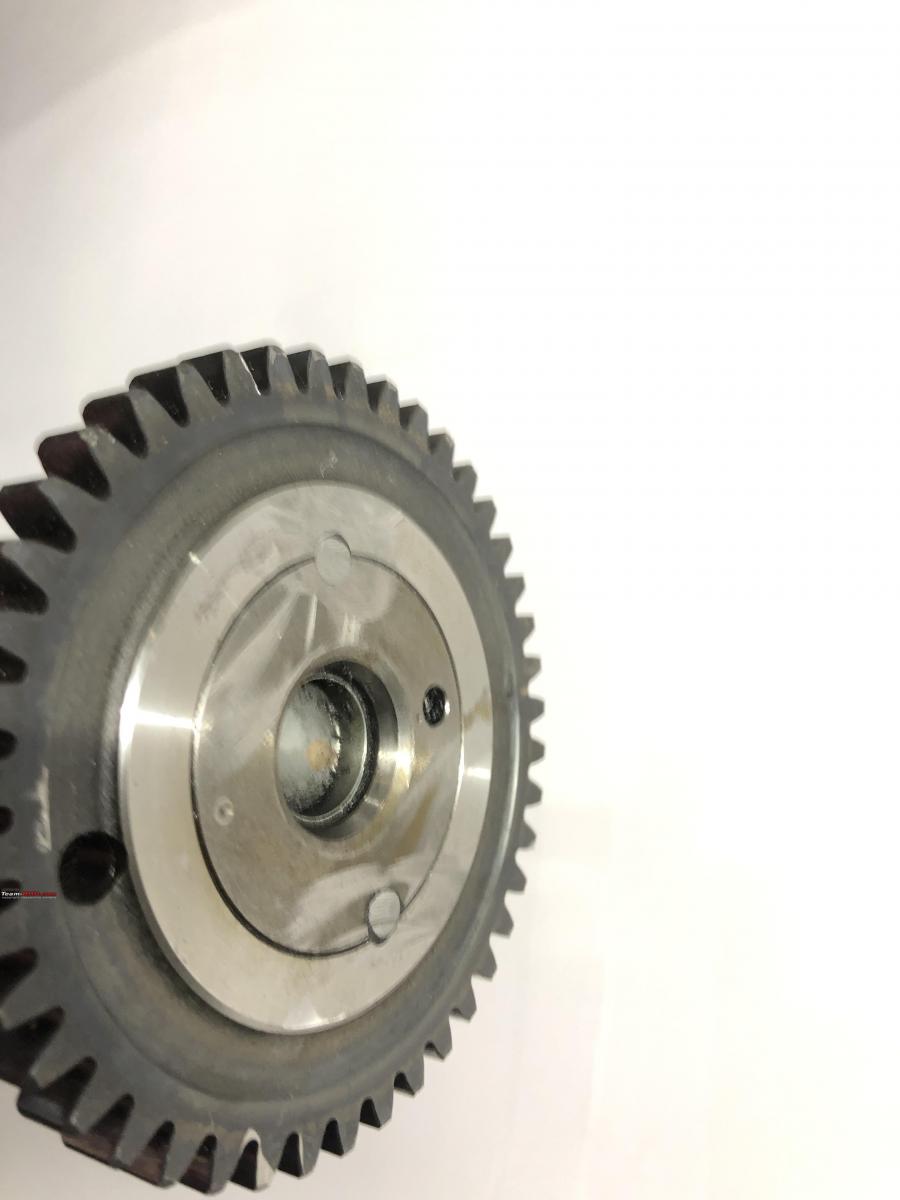

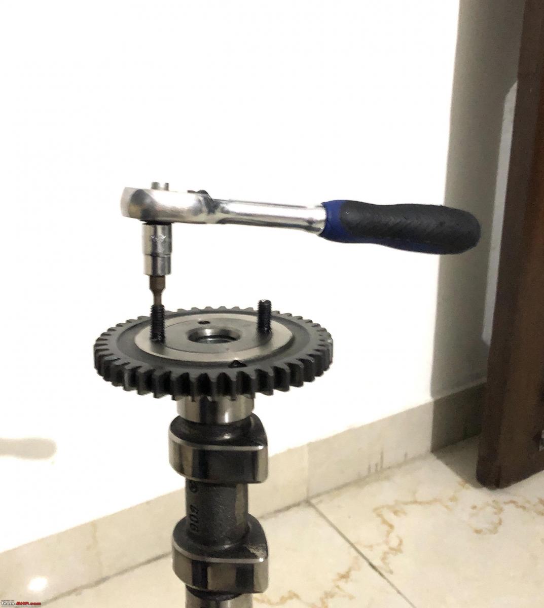

Pinning Intake CAM
This is a very small but major step. When producing high power, there is a high chance of intake cam sprocket spinning and causing engine damage. So pinning it is the best solution.
