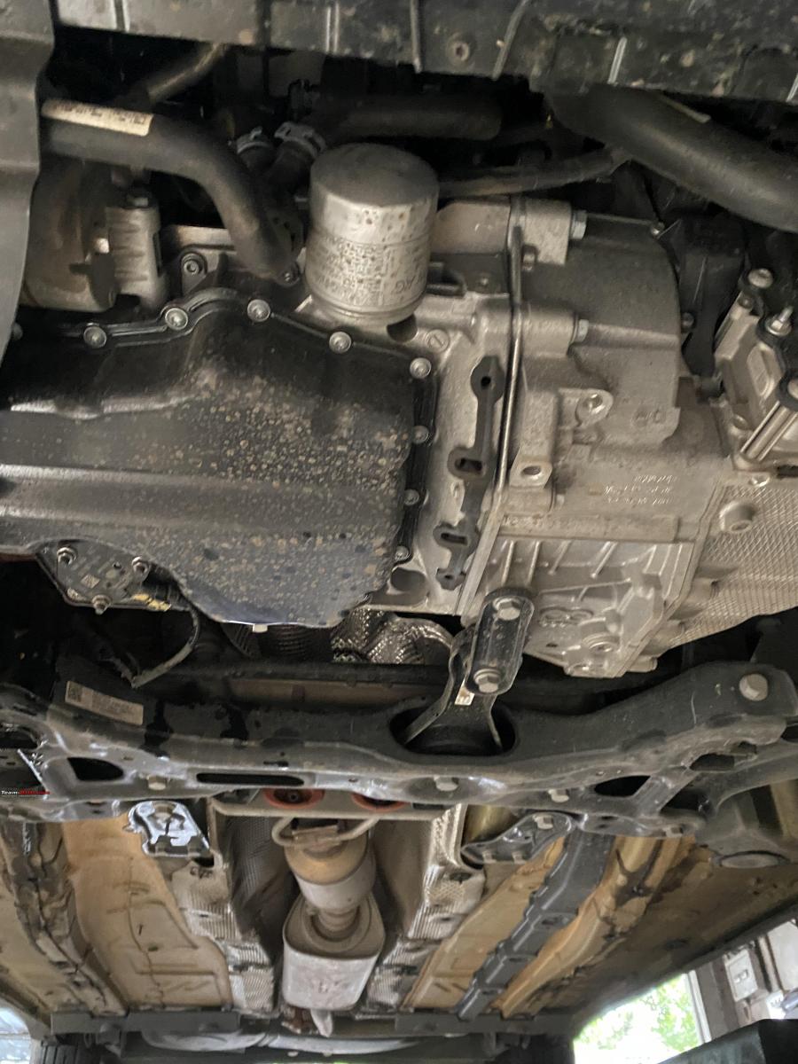

Took this picture from below the ramp. This positively scares me. Look at how exposed the oil filter is. Such a setup devoid of any kind of protection does not augur well for the road conditions we drive on.

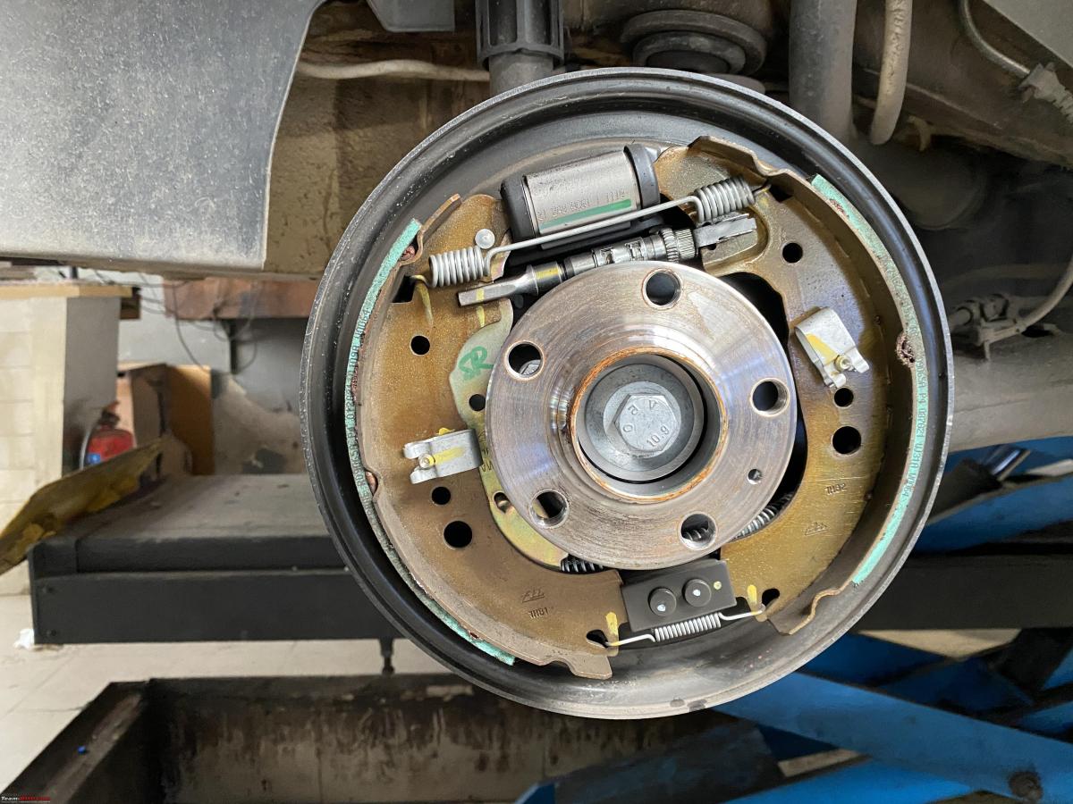

There was also a recall for the rear wheel hubs. This is a picture of the rear wheels opened waiting for a hit change

A point of caution for those of you that will have a hub change. Note that the hub for the Taigun is exactly the same shape and size as the Polo/Vento. But its specifications are different. They can very easily be mistakenly interchanged so ensure the correct part number goes in.

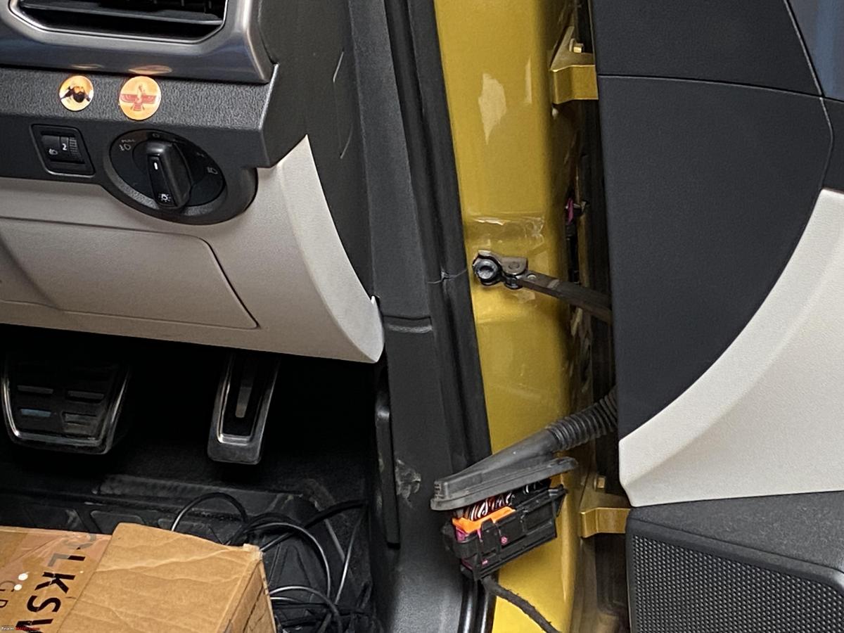

This was the actual yearly service that was done under the Service Contract. I did not have the oil changed at that point. The Air filter & Pollen Filters were changed. Sunroof rails lubricated, Windshield Washer Fluid topped up. Balance Roof Rails lubricant and washer fluid were handed back to me. The Engine & Brake Oil level and quality were checked and did not need topping up. Air Pressure was checked and updated to 35 PSI. VAS Scanning was done. Some error codes were cleared but not sure which ones.
