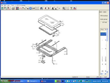

Drainage - Above all, how it drains water and the drainage points. Dust gets everywhere and with water becomes muck, this can clog your channels. First thing is to open your roof, take a bottle of water and pour it around the channel. Get out of the car and see where it flows. Note the drainage points and how they can be cleaned.
Schematic diagram for VW & Skoda cars:
Here you see the front drainage hole for the sunroof (car came back from a respray so the area is a bit dirty - expect a lot of muck to flow through!)
The rear holes cannot be seen as it is deep in the recesses. In the case of VWs, the front drains through the windscreen pillars to a nipple in the front door hinge area.
These nipples can get blocked. It's best to clean the nipple by squeezing them and pouring water down the sunroof channel occasionally.
Water flows through the front door.
As for the rear: The pipe will be hidden in the boot behind the trim / lining. Merely pull the lining, and pinch pipe at bottom to clear muck. This drips through the rear wheel arch.
