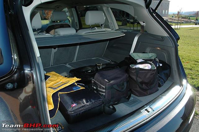

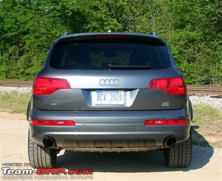

AFAIK, vehicles that have their brake lights on the hatch (tailgate) have to have additional brake lights on the bumper. So if you've loaded something long into the boot and have to drive with it open, you still have brake lights that are visible.
See this:
The lights are mounted onto the hatch.
So when the hatch is open, lights aren't visible.
Hence, an extra set are mounted on the bumper.
In the case of other cars, I guess they are just reflectors to aid visibility.
