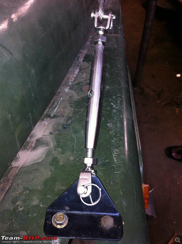

Definition:
Limb Risers are the steel cables that run from the brush bar / front of your vehicle up to the top of the roof line above the windshield.
Synonyms:
Limb Risers / Branch Deflectors / Bush Cables / Tree Cables
Use:
Their purpose is to keep tree limbs / branches from hitting your windshield by deflecting them above the roof line, thereby, avoiding damage to the windshield, A pillar and A pillar mounted lights. Also useful in jeeps without doors and windows whereby a whiplash of a branch from the windscreen can hit your face.
Limb risers are a fairly simple mod to fabricate and can be attached in front either to the body or the brush bar and at the other end to the top of the windscreen frame or a roof rack.
In some countries it is illegal to drive on the road with these since they can lethally injure someone in case of an accident and they must be removed when on the road.
Earlier explorers and road builders used to use razor wire for bush cables which would cut these branches rather than deflect them.
DIY Threads:
Did up some limb risers - YotaTech Forums
Limb Risers
Make Your Own Limb Risers
Limb Risers
Here are some pics of the limb risers on my old Classic and the new jeep:
Limb Risers / Branch Deflectors / Bush Cables-cl1.jpg
