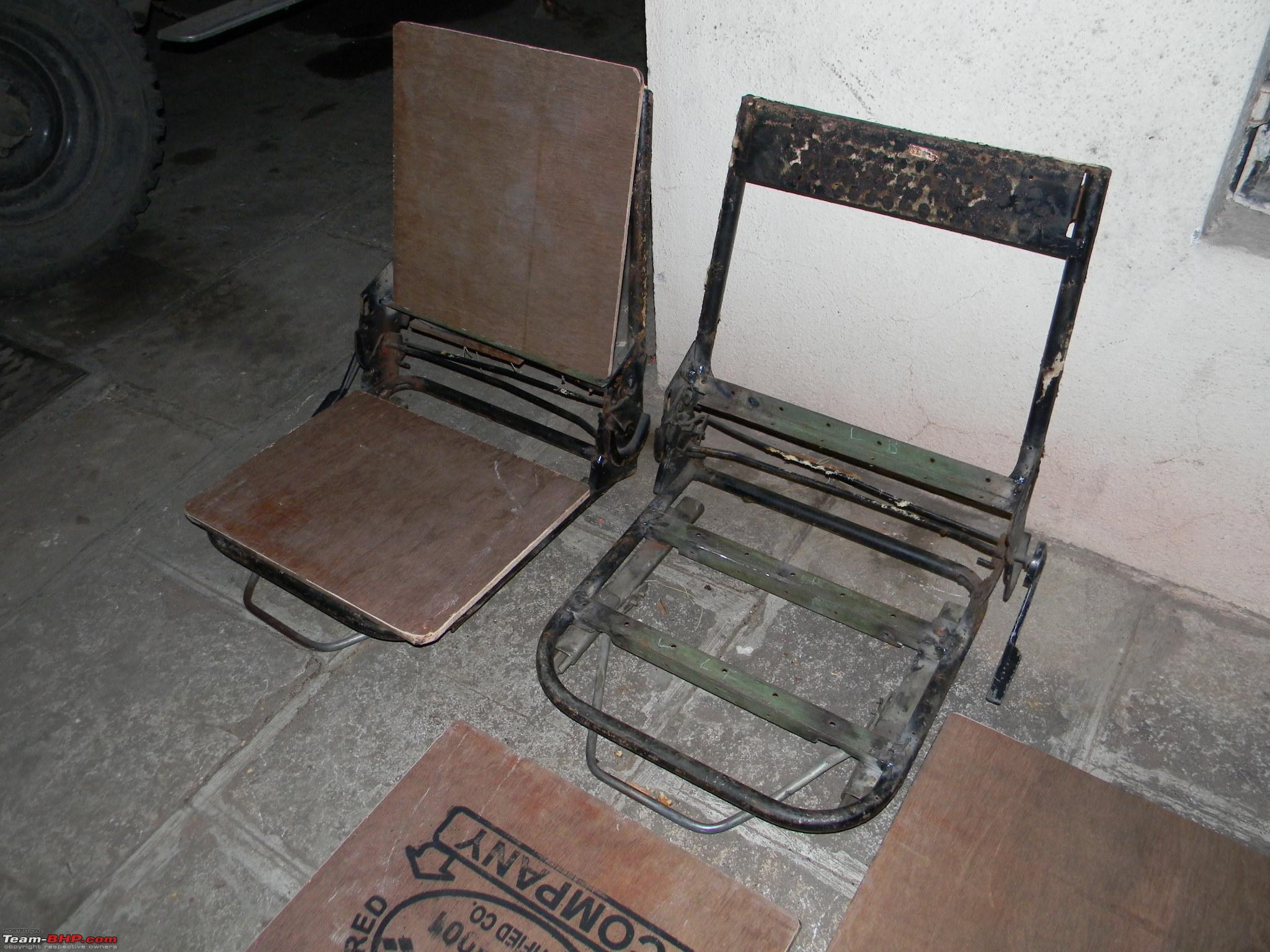

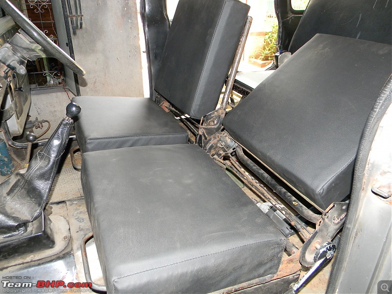

This is about how I made the seats in my Jeep .
The original were the 118 NE type seats came with the Jeep , these lasted many years . With time they went bad , but meanwhile I got the taste of the Land Rovers & this subject of repairing / replacing took a back seat as the LR became my primary ride .
Two years back I Purchased a commercial sewing machine for some sample making purposes & then I thought about doing the seats the DIY way & I did it .After that I did the Landy front row seats too .
These are basically a Coir + Foam seats based on half inch waterproof board using the existing seat frames .
With the Original seats , I used to have pain in my neck few times if the driving exceeded 4/5 hrs . but now tested these for some 5 hrs driving & the neck pain is gone . Tested these on off roads too & they proved worth the effort .
Have a Look

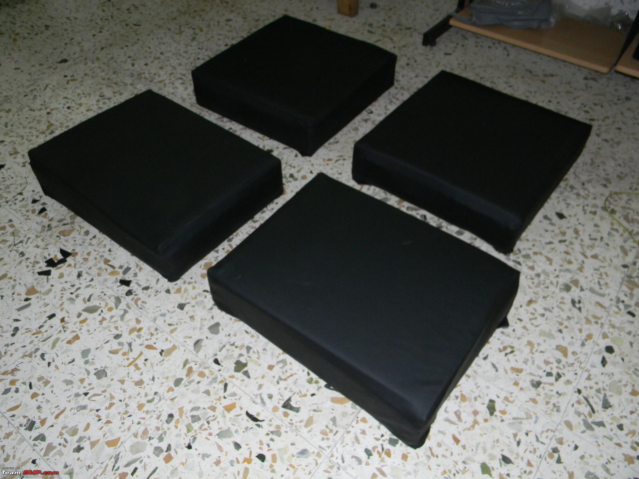

Thanks for the compliments, the Coir used was 4 inches thick & the foam was 1 inch thick. I need to search files for the bills to check the specs of both. Don't remember the correct specs now. Bit confused as I remember the coir of 100 density & the foam 60, but will confirm later.
I used common sense to select the foam & coir in the shop by taking the 'feel ' of the material, had no other guidance.

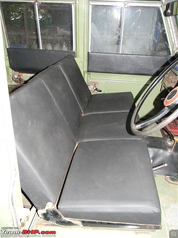

Attaching here the pics of the Land Rover Series 2a front row seats, which I did later. This was a bit tricky job as the supply of material fell short & had to use some old coir at the last moment, leveling took some time

Coir 100 density , foam ( sponge ) 60 & 30 , used different grade for seat & back
Good one, thanks for sharing.
Exactly how cheap . Can you please share the cost of material?
Spent some 3500 Rs for the material including the seat leather/cloth ( whatever ) , made 10 seats ( 5 pairs , a seating portion & a back )
Did not calculate my own workmanship . Spent some 18 hrs in all .
