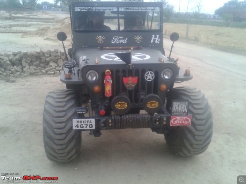

Check this one out from Mumbai (Link to OLX ad). Though the odds are, it's a 6x4 (or 6x2) and not a 6x6.
6x6: Any significant advantage over 4x4?-1.jpg
6x6: Any significant advantage over 4x4?-2.jpg
6x6: Any significant advantage over 4x4?-3.jpg
6x6: Any significant advantage over 4x4?-4.jpg
6x6: Any significant advantage over 4x4?-5.jpg
6x6: Any significant advantage over 4x4?-6.jpg
6x6: Any significant advantage over 4x4?-7.jpg

Wow, this one takes "multi-brand" to a new level.
Ford and H2 in the front, Jeep and Toyota at the back. Why, he has got a new 'willy' too.
