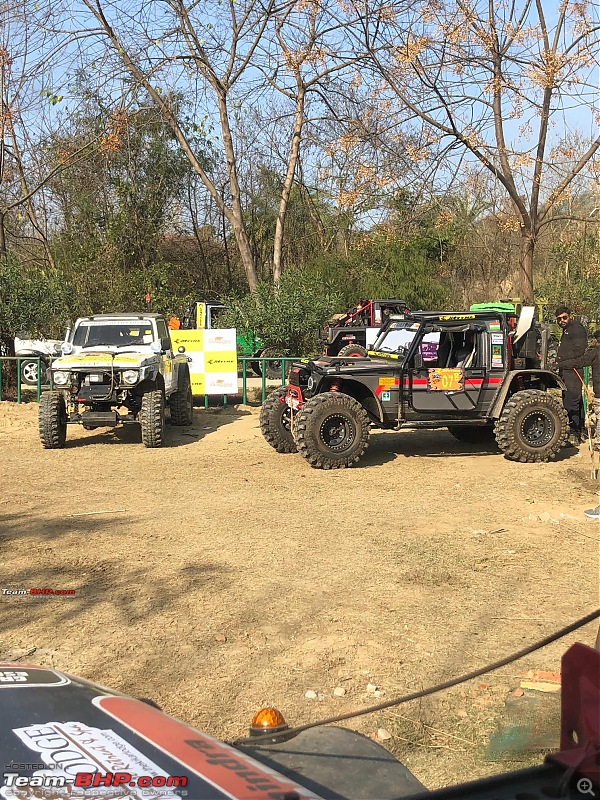

Here are a couple of pics of some purpose built off-roaders. Hard to achieve these with a unibody. (check out this thread here, ESPECIALLY the videos https://www.team-bhp.com/forum/4x4-e...ge-punjab.html )
Monocoque vs. Ladder Frame Offroaders (case in point, the new Defender)-reached-kikar2.jpg
Monocoque vs. Ladder Frame Offroaders (case in point, the new Defender)-reached-kikar.jpg
