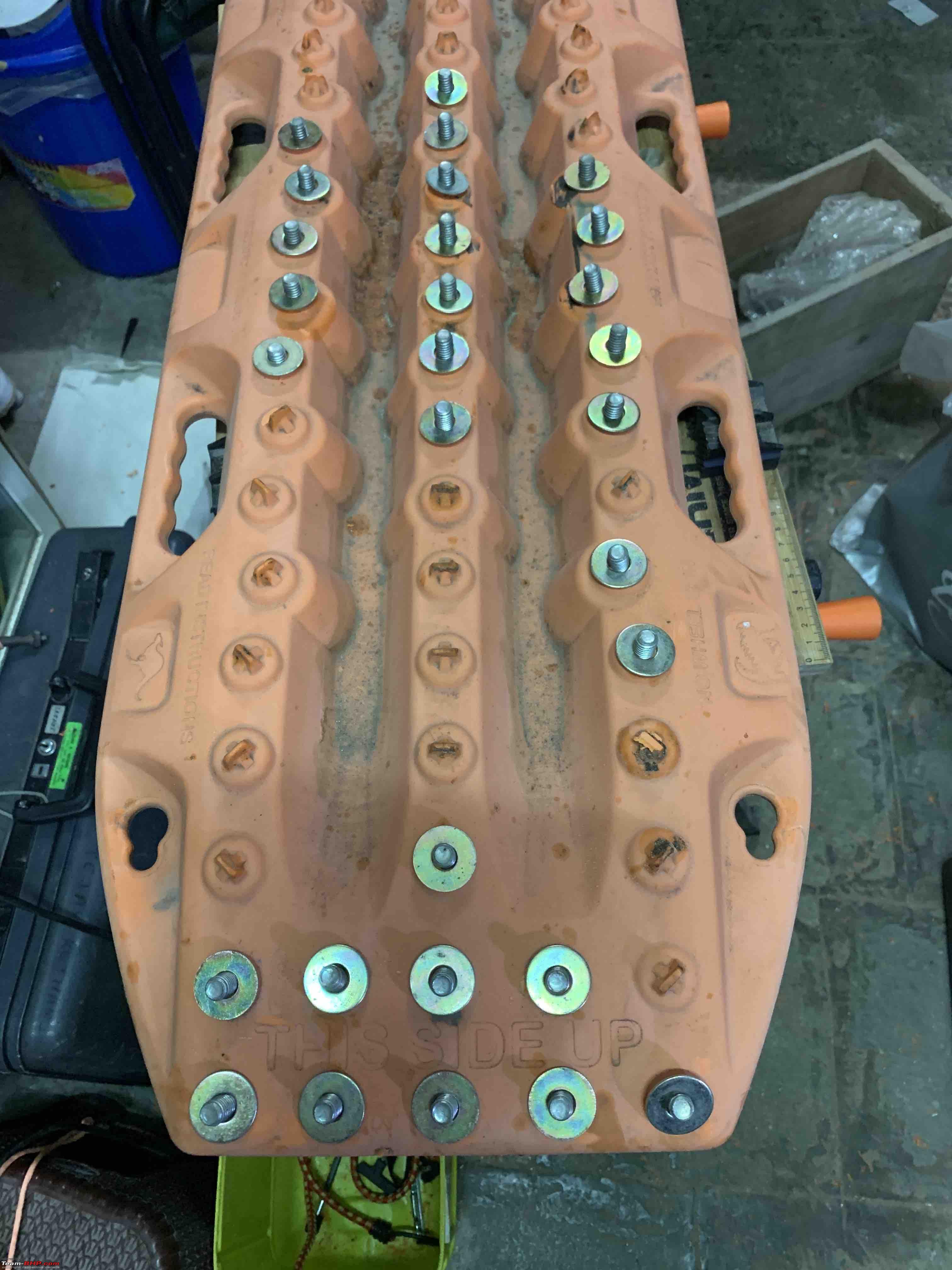

A fellow colleague from I4WDTA, Kyle had done a mod to repair his Maxtrax and even Maxtrax itself has now introduced an extreme version with a similar concept.
So here's the procedure:
First off is to cut off the damaged studs.
I tried to use a Dremel type tool with a diamond cutting disk for greater precision:
And then sandpaper disk for finishing.
Then a trial drilling:
Inserting a 1/4” diameter bolt 3/4” long with washers and nut:

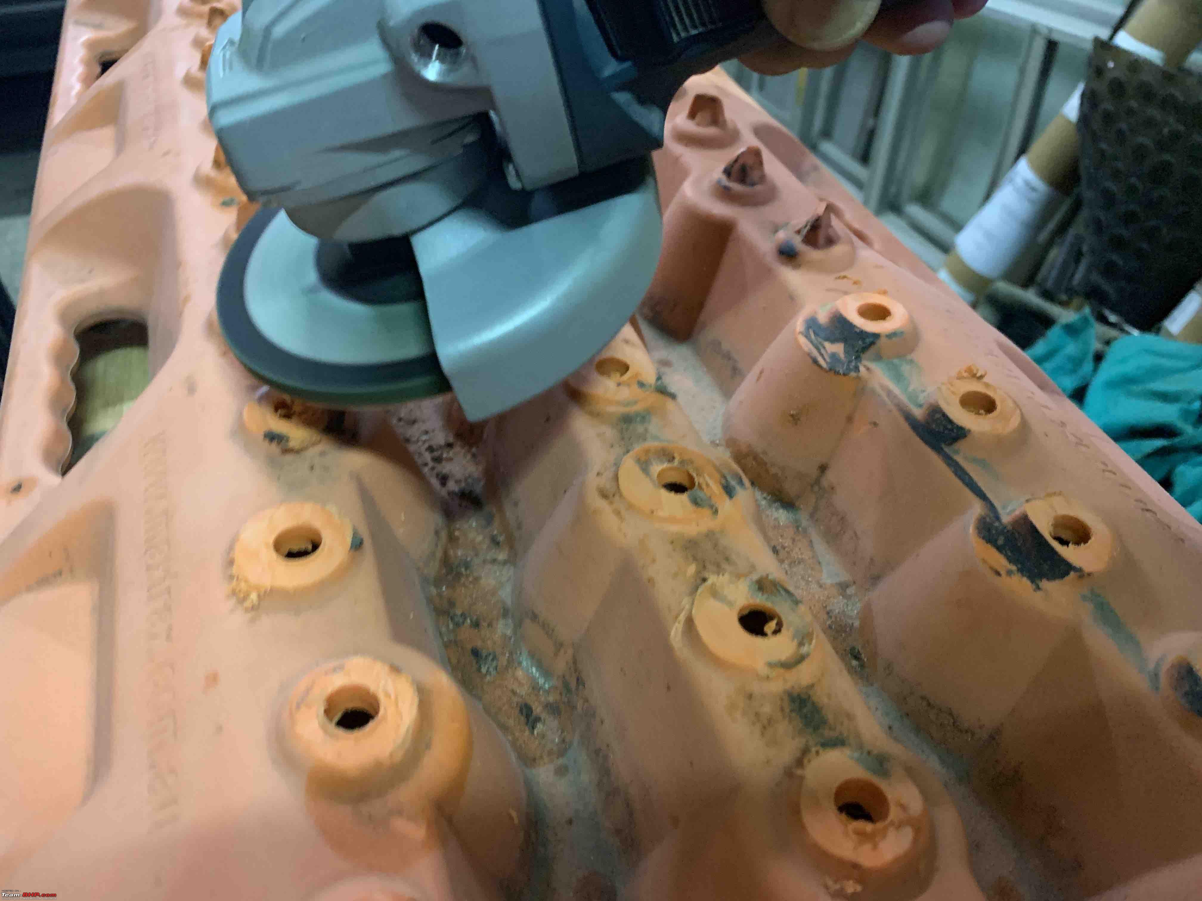

Fits well but the Dremel takes forever to cut. So decided on a faster option and took out the angle grinder:

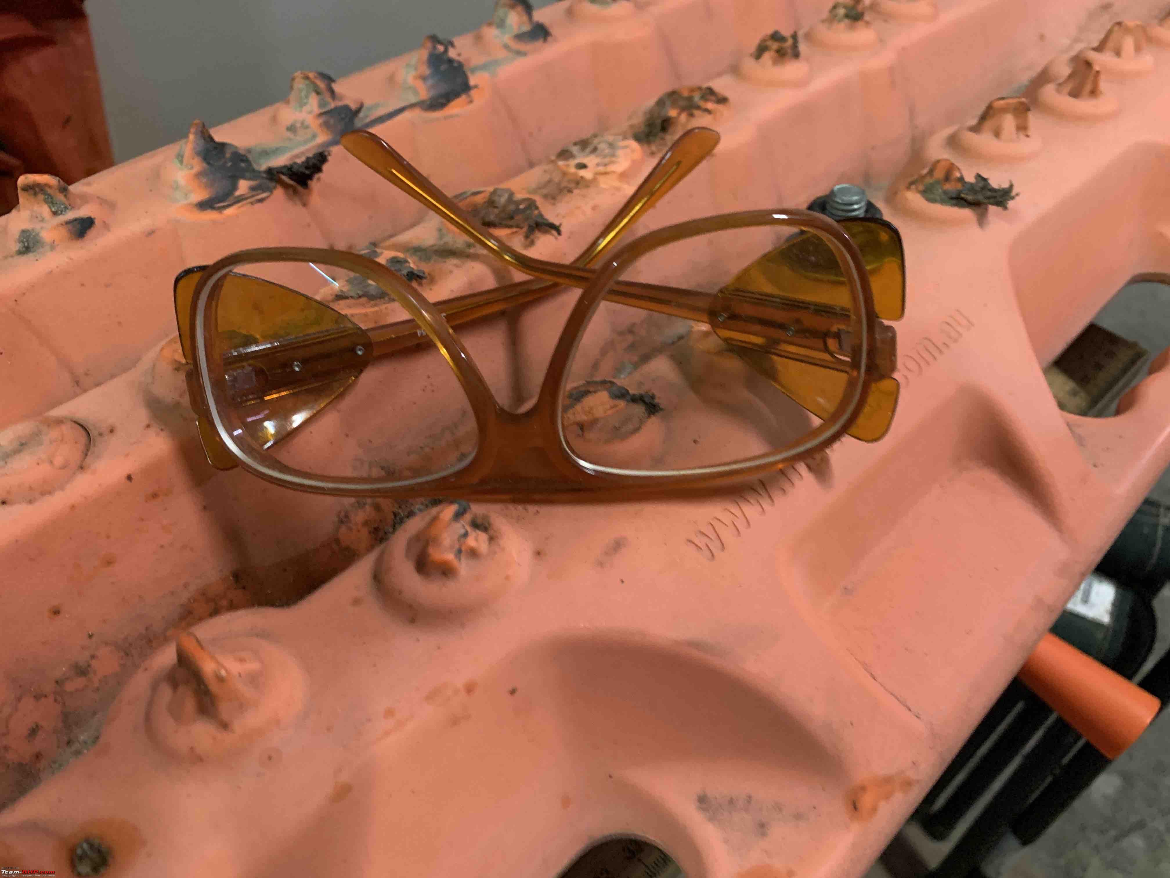

Remember, safety first:

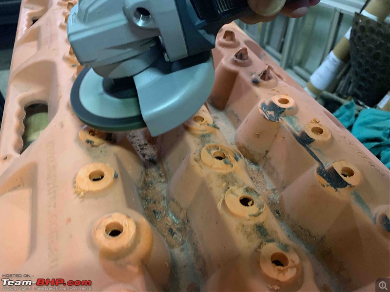

The angle grinder made quick work and I had 28 damaged studs down in less than 2 minutes:

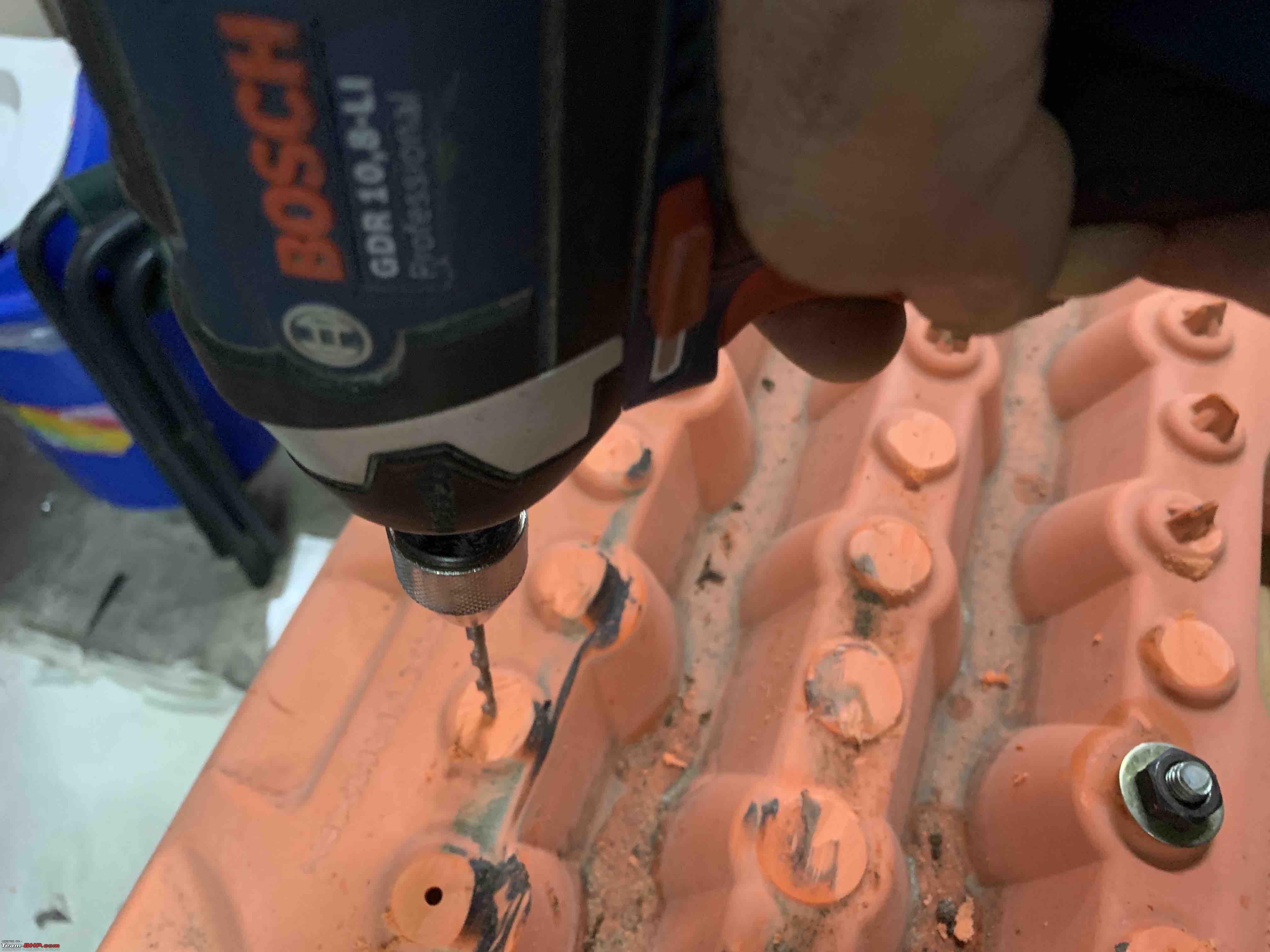

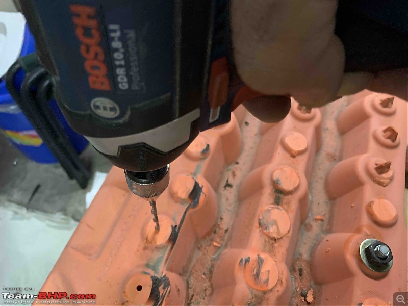

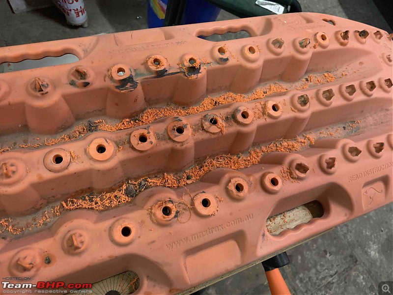

Now remember, you need the holes to be exactly centred. So it makes sense first to make exploratory small holes before using the larger drill bit:
All drilled and ready to be smoothened:
Again used the angle grinder to remove the burs:

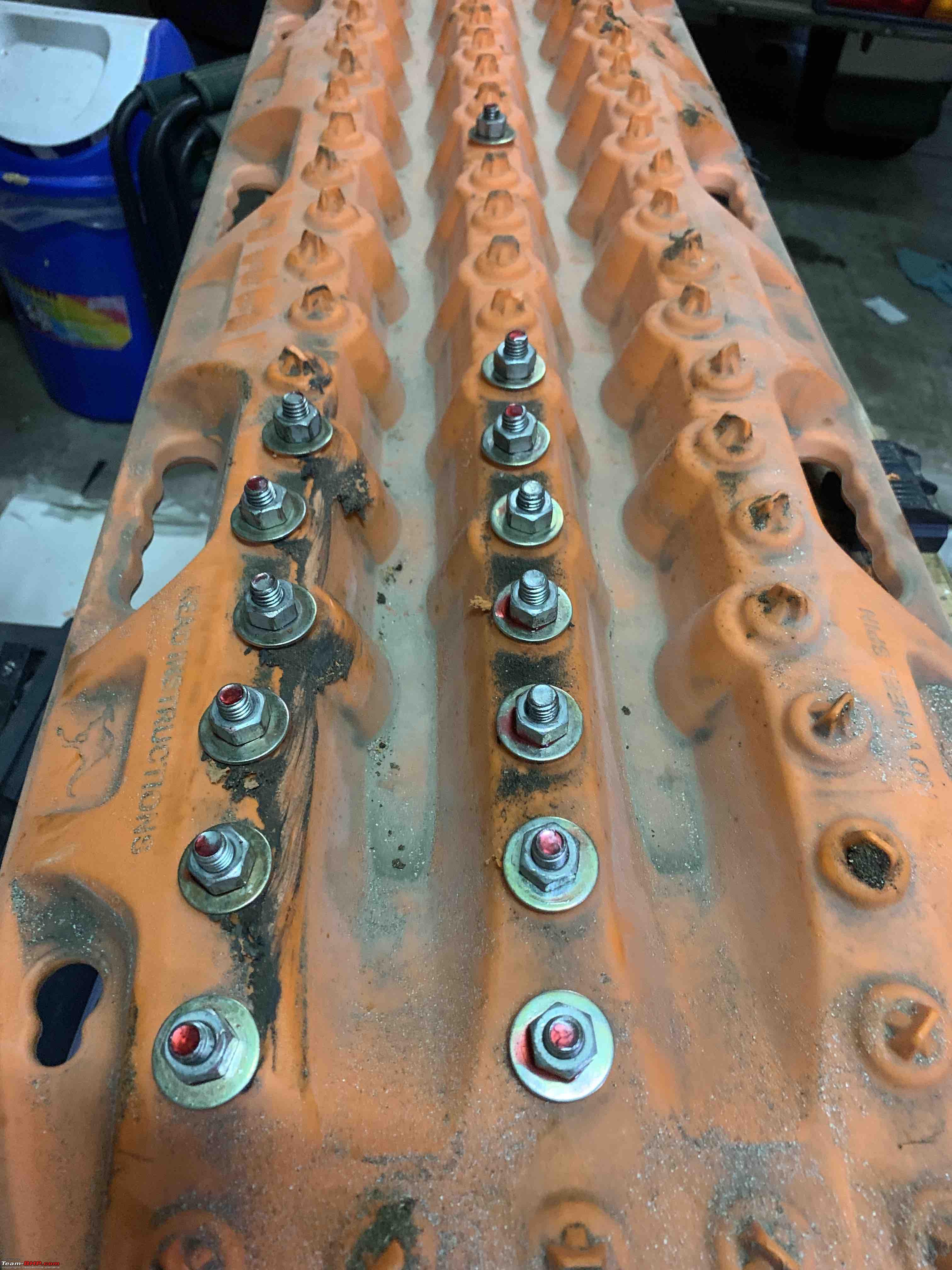

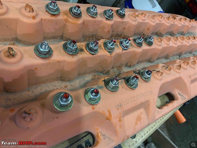

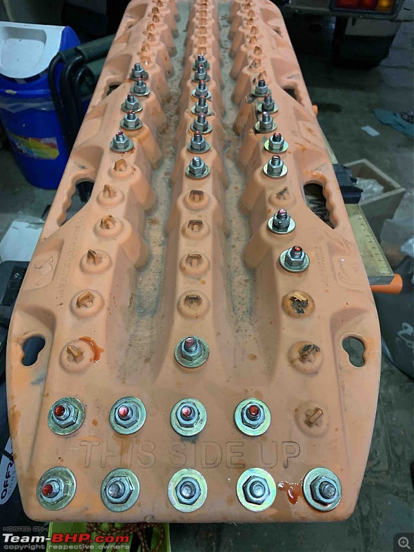

Bolts inserted from behind:
Top view:
Washers (10mm):

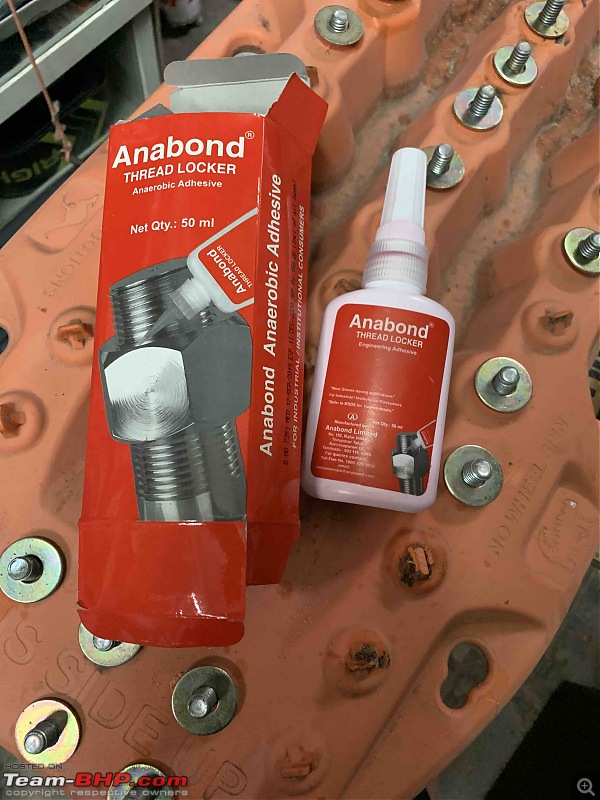

I should use lock nuts ideally but they are expensive and I went with Anabond thread locker to save money. If it doesn't work, will shift to Nyloc.
Anabond applied:
All the nuts torqued. Power tools make life really easy!

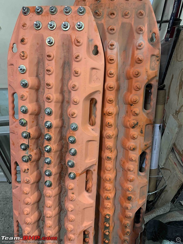

Finished:
A different angle:

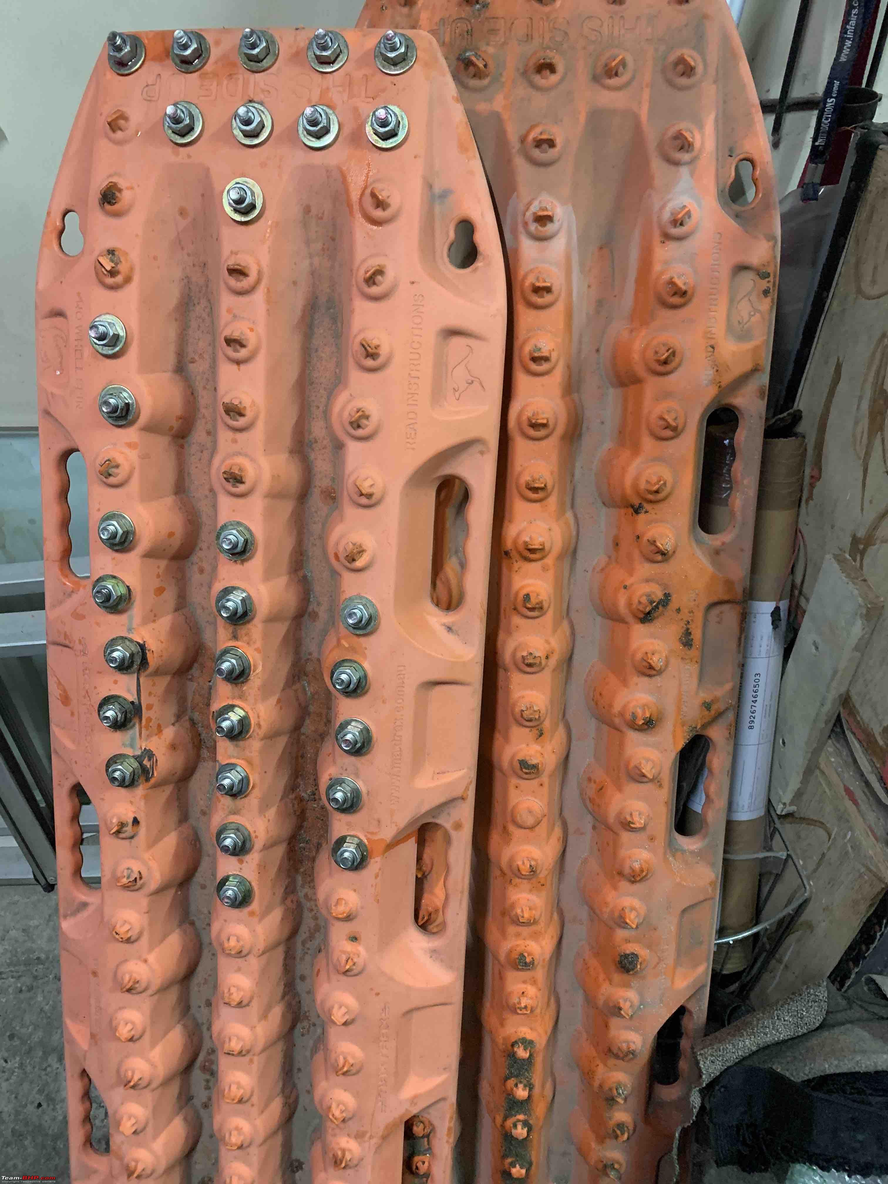

Compare with the second board. The weight increase is marginal:
Did the same with the second board:

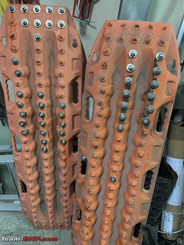

Both ready:

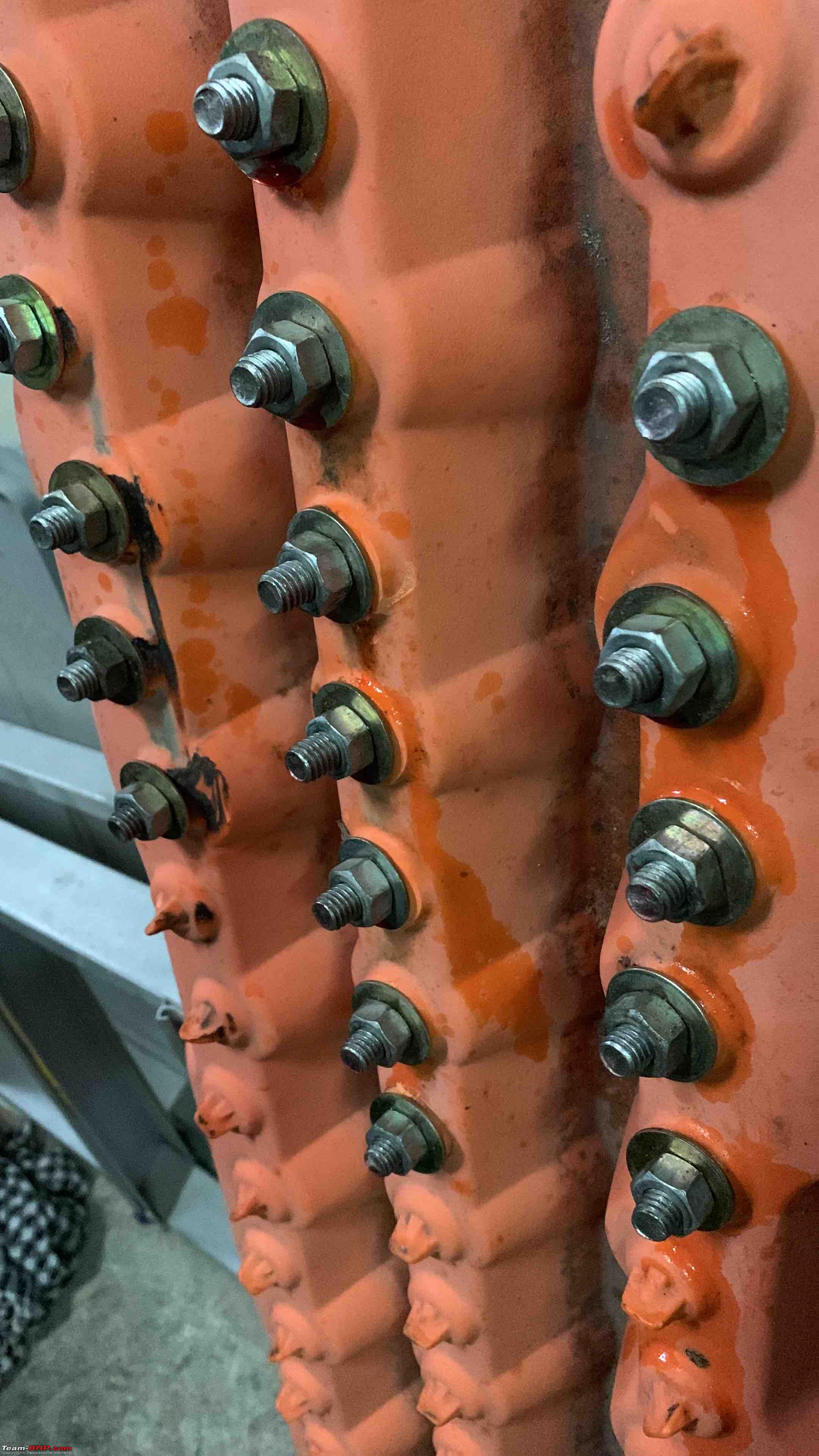

Close up and time to wipe off the run off anabond:

Tejas, have you thought of reversing the nut-bolt so that the bolt is on top ?
Me thinks that the bold will help to gain traction without so much protrusion. And wider surface means lesser damage to tyres.
OTOH, if some one guns with his tyres on these repaired boards, this time it can be the tyres getting some nice damage at the bottom tip of the bolts.
