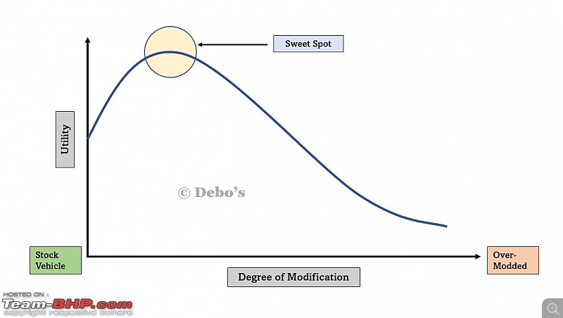

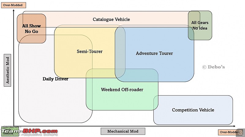

The list can be never-ending given the plethora of options available in the market. Provided an unconstrained budget, there is always a chance of going overboard with modification beyond need. The sweet spot for aesthetics vs functionality for every mod is often missed in the pursuit of uniqueness. For example, let the following pic do the talking. None of the extremes conforms to any viable use case, save 'looks' (which is often very subjective). These all seat at the right-most point of the curve (refer graph next to the pic.)
Coming back to the graph— people might have polarized opinions, but these are approximate representations that vary with each mod. Where do you see your 4WD in the visual matrix?
Also, please let us know your preferred mod list and the respective vehicle details.

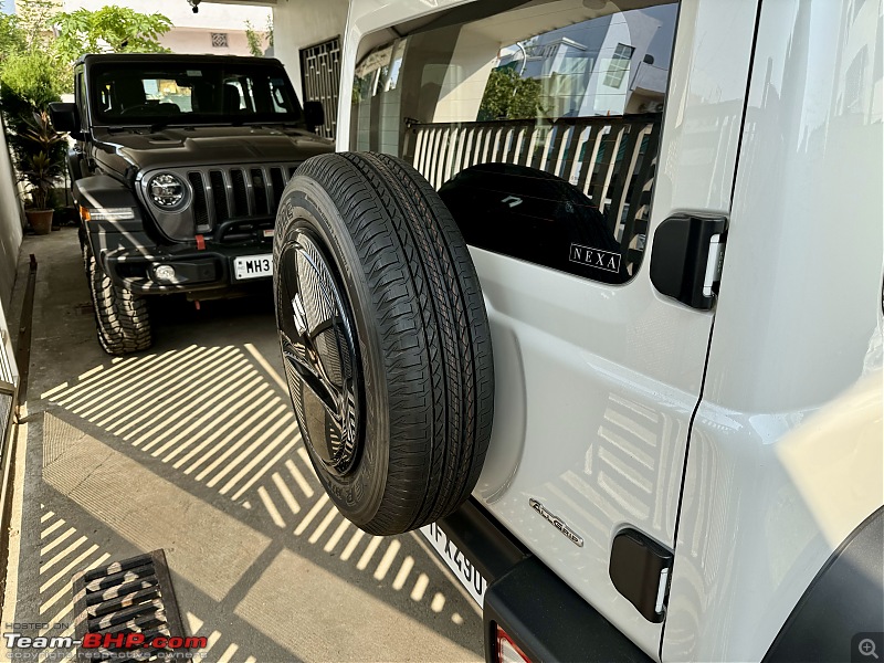

I didn't want to increase the ride height but it comes with the package. Only con I can think of is due to the increased height there is more wind resistance.
Pros: improved ride quality, lighter steering, lesser nose dive and marginally better brake feedback.
I have done host of functional mods and a few aesthetic ones too.
