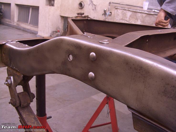

Update time folks.
After a long time of inactivity finally managed
to get the jeep towed to Noida so that some work
could be started. The body, engine and transmission were
removed from the chassis. Unimaginable amount of grime and
crud was found clinging to the chassis. The chassis was pressure
washed and cleaned up.
Then we hit the angle grinder with a wire cup brush attachment with
a vengeance and started the surface rust removal process. I must say the
results look encouraging. The chassis looks pretty fine and solid.
Although we have just started with the chassis i wanted to update
with some pics.
More updates coming soon.
gotzuk is offline
