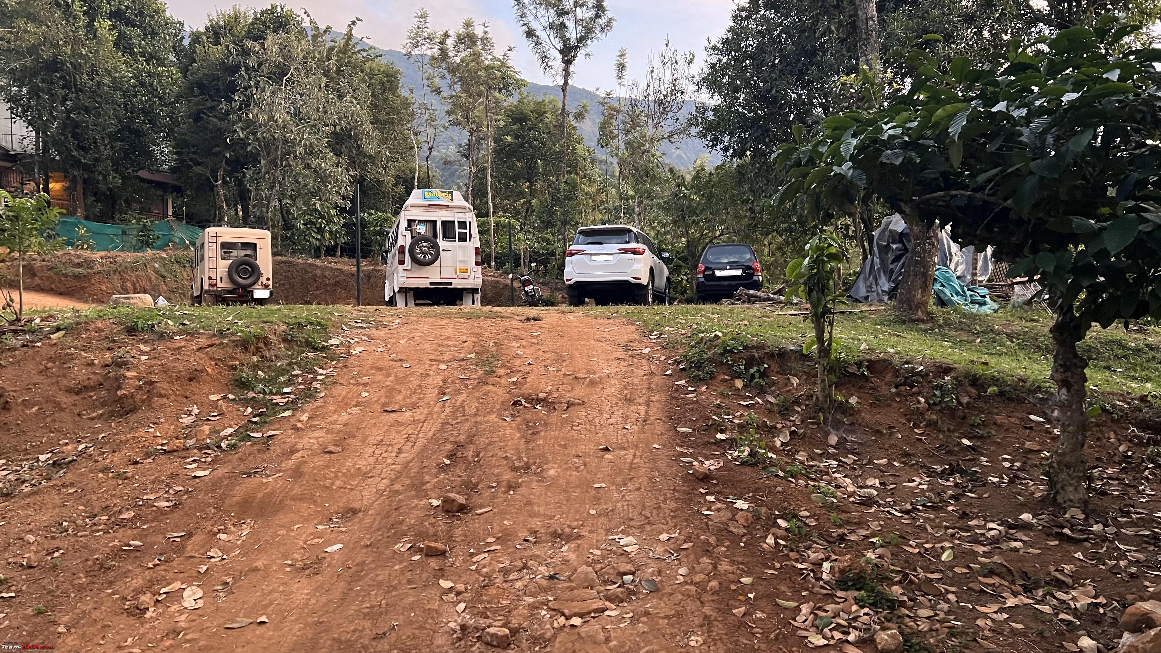

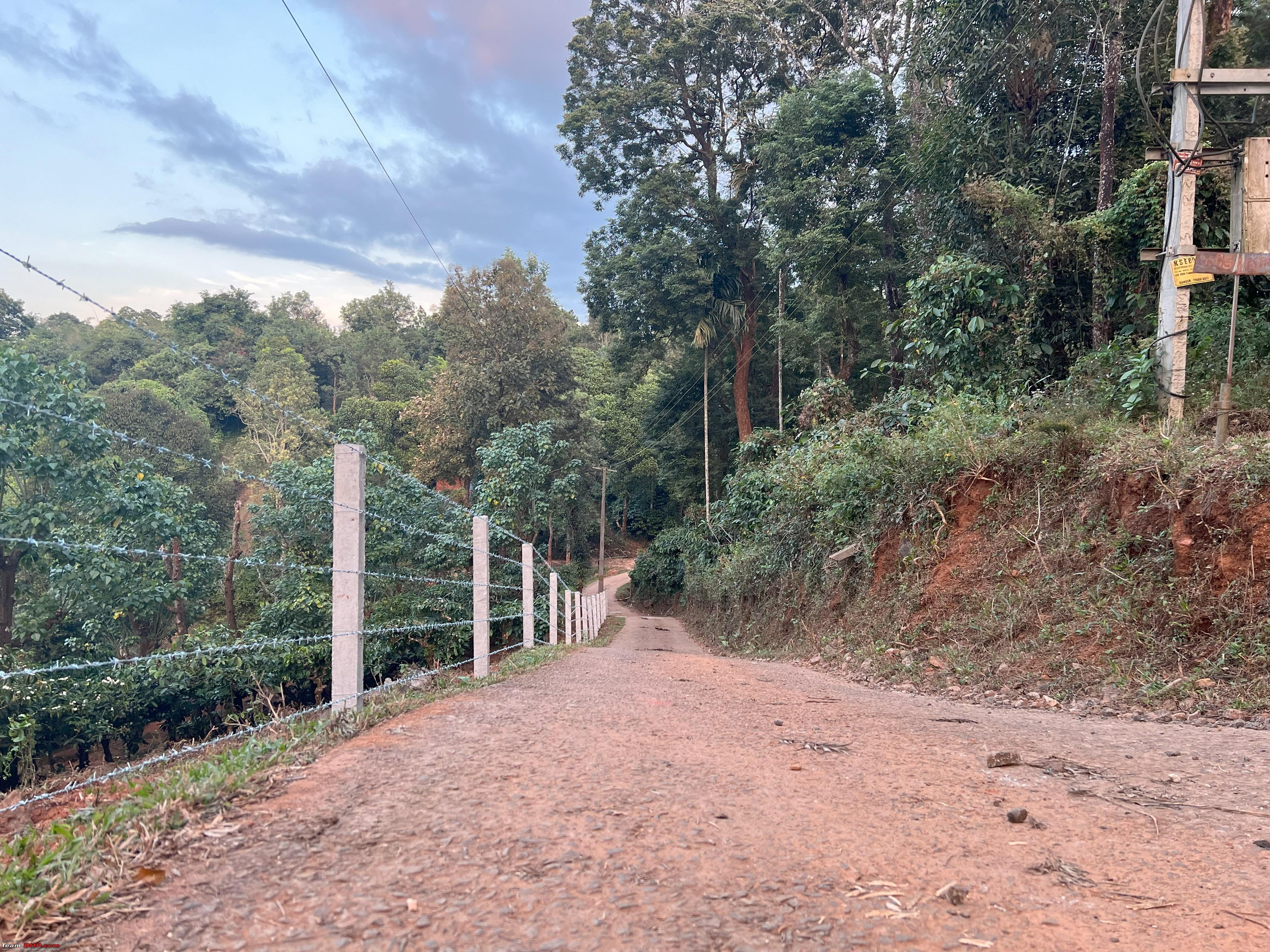

Recently got a Fortuner 4x4 AT and went on a trip to Wayanad. The approach to the resort was a stony road with with reasonably steep climbs with turns.
There was a also steep drop some 50m in length and a 40 degree drop - straight one on concrete and followed by few a rather steep climb with tight hairpins - total length around 60meter but with 40degree climbs with hairpins between them. The last set of hairpins was concrete with mild sand cover from the vehicles gone by.
Is this surface/climb ok to be taken on 4H on a AT Fortuner:
Since I am new to a 4x4 drive and new to a heavy SUV as well (previous drive was a 2010 Ford Figo petrol), did not want to risk wheel spin and rolling backs on the climb decided to switch to 4H and the whole climb went without any drama and we reached safely to the top.
When I had re-read the owners manual realized driving on dry surface where wheel spin is not possible could harm the drive train and transmission when driven on 4H or 4L.
Wanted to take the forums opinion on if it was ok to use 4H on the below trail.
I had driven the whole stretch around a KM of the approach stone top/gravel top road on 4H and the final 100 meters on concrete at a slow 10KMPH rolling speed. The same trail had been covered by 2 wheel drive vehicles - I saw an Innova, Creta and Lord Alto parked once I reached the top. So the trail is possible in 2H alone and did the return path in 2H.
So the main question I had was - was their undue stress from the above trail on 4h which I should continue monitoring for any issues or are things are ok from the minor wheel spins from the sand on the dry concrete and the sand top which should have released any stress once reached the top parking spot which is non paved sand top.
Had taken to service center for as the vehicle had complete 950 KMs - they had checked and confirmed everything is fine.
Approach Stony Road - It had few steeps as well - Pic for surface reference.
Does these stones allow wheel slip enough to prevent windup? I had tried moving a few of them - they are relatively loose and some them come off when pulled with hands.
Don't worry, your car is almost certainly completely fine and the extra wear would be insignificant at such low speeds. Depending on how loose the surface was, 4H was probably the right call, especially for that last climb.
Just don't leave it in 4H on tarmac highway drives.
Speed doesnt matter. Slow or fast, if the drive train has to windup, it will.
Remember the three things that have to happen together for a drivetrain windup. Any two and you are ok:
1. You must be on a high traction surface (ergo no wheel slip)
2. You must be taking a turn (even a couple of degrees of turn matter)
3. You must be in 4wd (locked) mode
If you are able to shift to 2wd, then you shouldn't be worried. It will release the windup caused.
When in doubt and you have no choice but to engage 4wd on a high traction surface, always air up. Carry a compressor and air up many points to reduce the contact patch and make the car bouncy in the hopes that it would bounce and loose traction and let the wheel slip.
