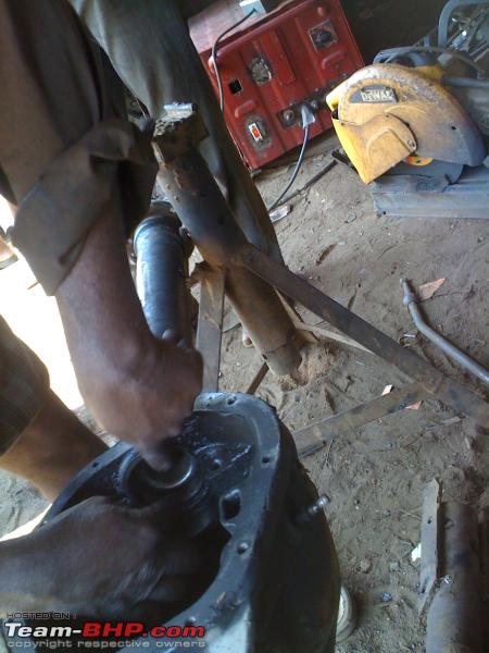

Some pics on the FFRA tube swap
Size:  498.4 KBName:  010.FFRAtubeswap2.png
Size:  498.2 KBName:  010.FFRAtubeswap3.png
Size:  458.1 KBName:  010.FFRAtubeswap4.png
Size:  465.1 KBName:  010.FFRAtubeswap5.png
Size:  410.3 KBName:  010.FFRAtubeswap6.png
Size:  461.2 KBName:  010.FFRAtubeswap7.png

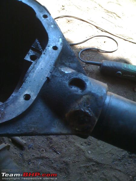

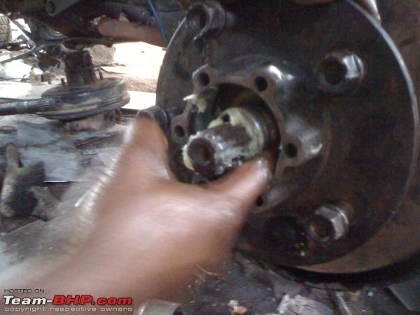

Santhosh, Apologies for the late update. As mentioned was away for 10 days . Posting some pics on the OKBJ installation as req....Name:  009.OKBJaxlesinstalation1.png
Size:  491.4 KBName:  009.OKBJaxlesinstalation2.png
Size:  481.3 KBName:  009.OKBJaxlesinstalation3.png
Size:  482.6 KBName:  009.OKBJaxlesinstalation4.png
Size:  493.3 KBName:  009.OKBJaxlesinstalation5.png
Size:  477.1 KBName:  009.OKBJaxlesinstalation6.png
Size:  469.6 KBName:  009.OKBJaxlesinstalation7.png
Size:  449.9 KBName:  009.OKBJaxlesinstalation8.png
Size:  411.2 KBName:  009.OKBJaxlesinstalation9.png
Size:  416.3 KBName:  009.OKBJaxlesinstalation10.png
Size:  443.9 KBName:  009.OKBJaxlesinstalation11.png
Size:  453.6 KBName:  009.OKBJaxlesinstalation12.png
Size:  417.5 KBName:  009.OKBJaxlesinstalation13.png
Size:  402.5 KBName:  009.OKBJaxlesinstalation14.png
Size:  450.5 KBName:  009.OKBJaxlesinstalation15.png
Size:  428.1 KBName:  009.OKBJaxlesinstalation16.png
Size:  441.3 KBName:  009.OKBJaxlesinstalation17.png
Size:  405.1 KBName:  009.OKBJaxlesinstalation18.png
Size:  428.5 KBName:  009.OKBJaxlesinstalation19.png
Size:  423.1 KBName:  009.OKBJaxlesinstalation20.png
Size:  436.5 KBName:  009.OKBJaxlesinstalation21.png
Thanks, Vivekj
One quick question to the experts!!!
Mahindra pickup OKBJ axle setup as shown in my previous post, dos this come with a spindle and hub setup that bolts on to the knuckle or with Unit bearing.
Referring to the above pic, I feel it should be the spindle and hub setup. Do correct me if I am wrong.
Thanks , Vivekj
