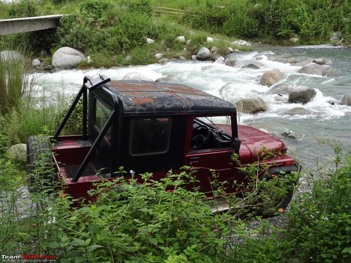

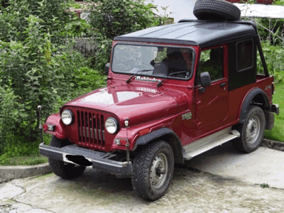

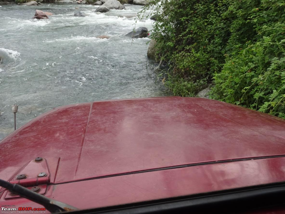

I put a specially fabricated steel half cap on my 2013 Thar in 2016. It's a good functional design. I have room outside in back for odd sized stuff and people can ride on the rear fenders back there in a pinch. And there is plenty of room for luggage inside behind the front seats. I can also put a couple of people inside behind the front seats in a pinch.
But, as you see, I park it outside and the fabbed top has not handled the Indian sun too well. The metal top and the body filler expand at different rates and the paint can't stand up to that. So, what I might do is re-prime the top, sand out the rust, but cover the primed steel top with cloth, leaving some space between the metal top and fabric top for air to dry the top out. That's the plan anyway. My 2013 has 134,000km on it and it runs like new so I am not in a hurry to sell it.
First pic is the top today.
Second pic is my scratched up bonnet. A troop of Langurs plays poker on it.
Third pic is the top when new in 2016.
Gotta sand and paint the whole thing. Might go with yellow or gold.

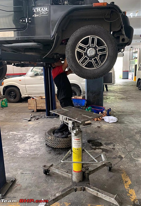

60,000 Km Servicing.
Routine 60,000 Kms servicing done in Sikkim Motors Authorised Servicing Centre. Usual Stuff, they never have parts in stock, had to run around in town to find Engine Insulator Blocks (I had already placed orders with a vendor and luckily he could manage) It cost Rs 2013 which is not in their Bill as it was purchased from another place. The same vendor Mr Sonu from Bye Pass (Authorised Mahindra Parts Dealer) who managed to get me an AC Condensor also during the Covid Lockdown. The Sikkim Motors Service Station Parts Shop is an absolute pathetic in its dealings and after multiple requests fails to provide basics of the parts. The upper arm ball joint assembly was ripped off an arm itself due to unavailability.
Nevertheless a less than enthusiastic service, due to paucity of space they did in the commercial section and didn't follow standard hygiene protocols like magnetic body protector covers, seat and steering covers for service etc. Plus they were more concerned in just changing oils and changed even the Transfer Case Oil when it was not in the manual. They defended saying that it is in the updated manual but failed to provide documentary evidence. Rest of the work, parts cost and labour costs are in the photographs that follow.

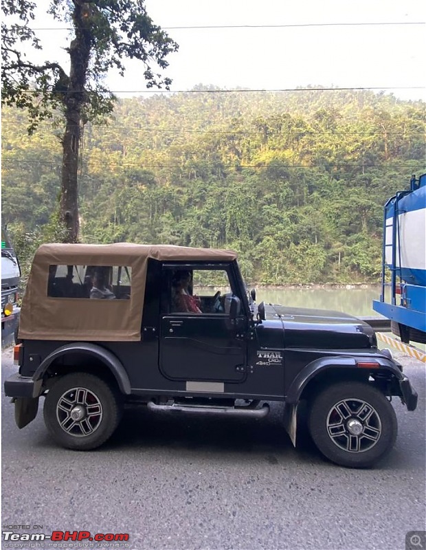

ARMORO Softtop issue
Brand New Armoro Operable Soft top leaked in the seams in a heavy downpour. Nothing alarming but definitely leaked visibly in the seams. Especially around the openable windows. Shot on Watsapp to Armoro with pictures and videos and they responded when I threatened for a TeamBhp Review . They got in contact with their QC team and got back to me again after 48 hours. They said the entire batch is defective so offered me three options to choose.
1. Full Refund & Return of Top
2. Rs 3000 Gift Coupon on Armoro and Replacement of Top (When New Stock Arrives- not sure when- could be few months to more than 6 months)
3. They will give me one non openable top Free on top of this current one.
Chose Option 3 and waiting for an extra Non Openable Top in Sand. Always wanted a Sand one too. :-) The current one needs some seam sealant and hope it holds on. Cant say for sure though.

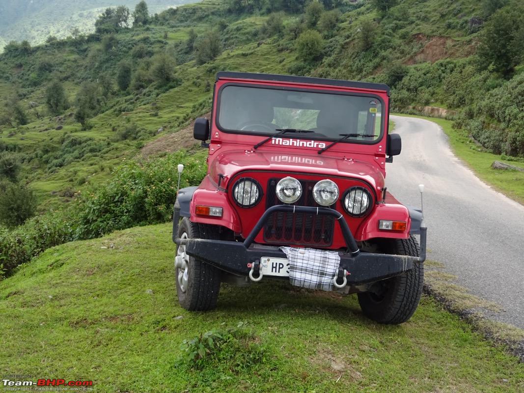

It should be easy to fab up a little cross piece about at the level mine is and mount your lights there. You could attach the cross piece to the the OEM bumper without a whole lot of trouble. My lights are low enough not to attract cops and high enough to miss most of the bumper level whacks and bumps. I put in 100watt capable headlights with a voltage regulator, too. Works good and does not blind anybody. I take care to aim my all my lights so as not to bother people or attract attention.

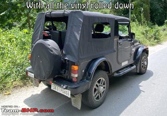

The new Armoro black openable softtop leaked at the seams at couple of places in heavy rain so the company provided me an extra Closed Canopy free of cost. I choose in sand colour and the contrast makes it stand out.

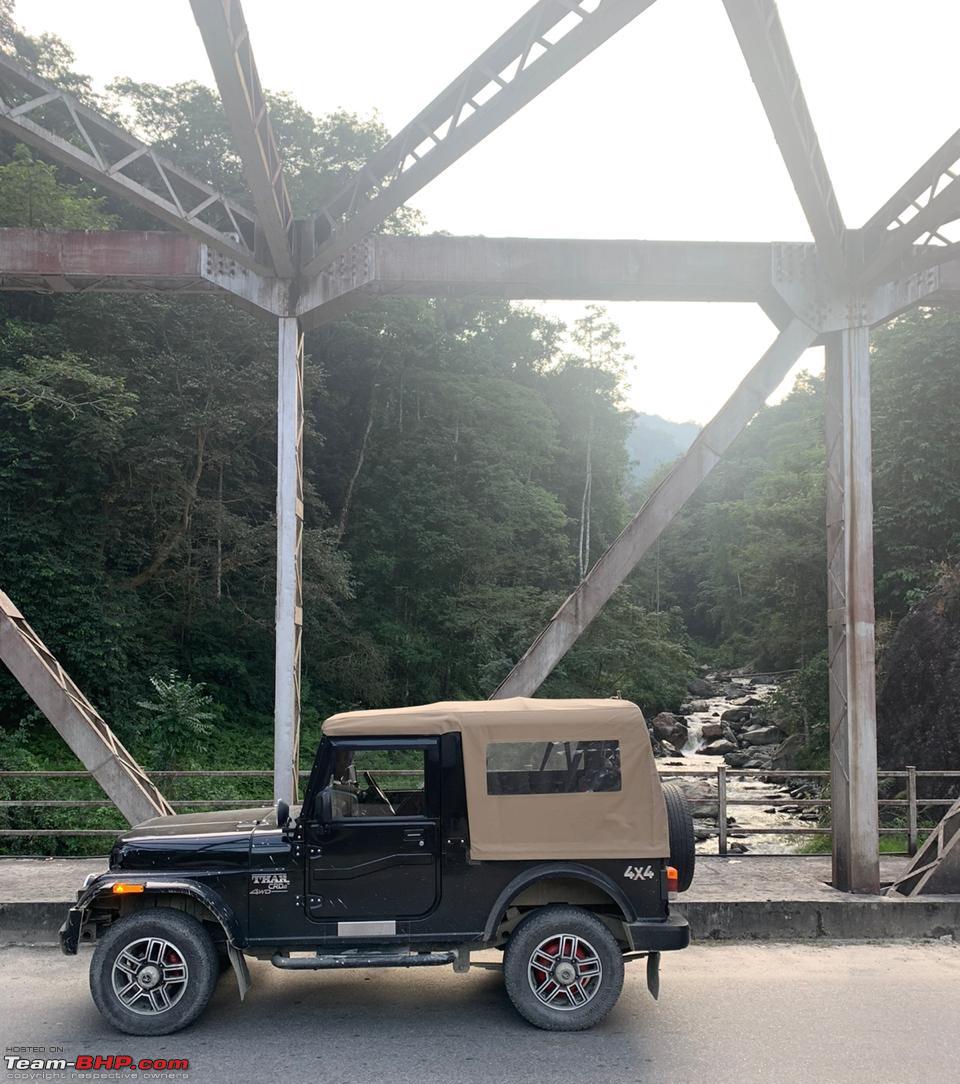

Managed to buy a sealant and seal the leaking canopy of the openable Armoro Soft Top. Black Soft top looks better for me i feel so the sand one is neatly packed and stowed away for time being.

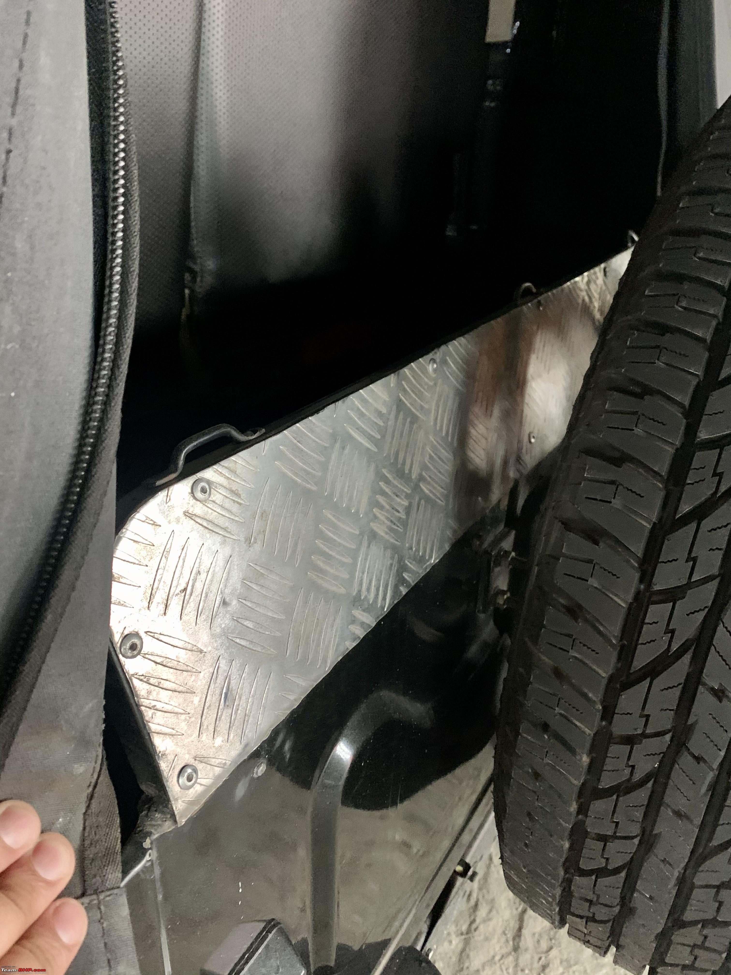

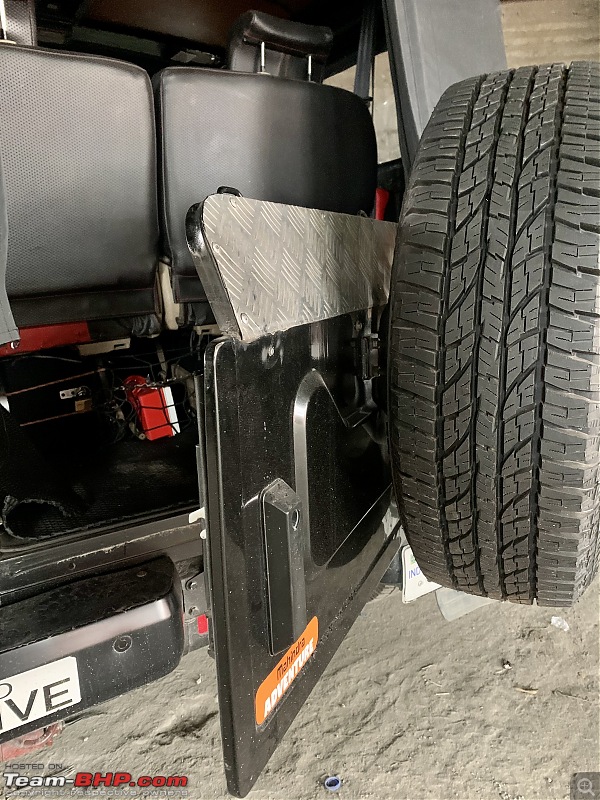

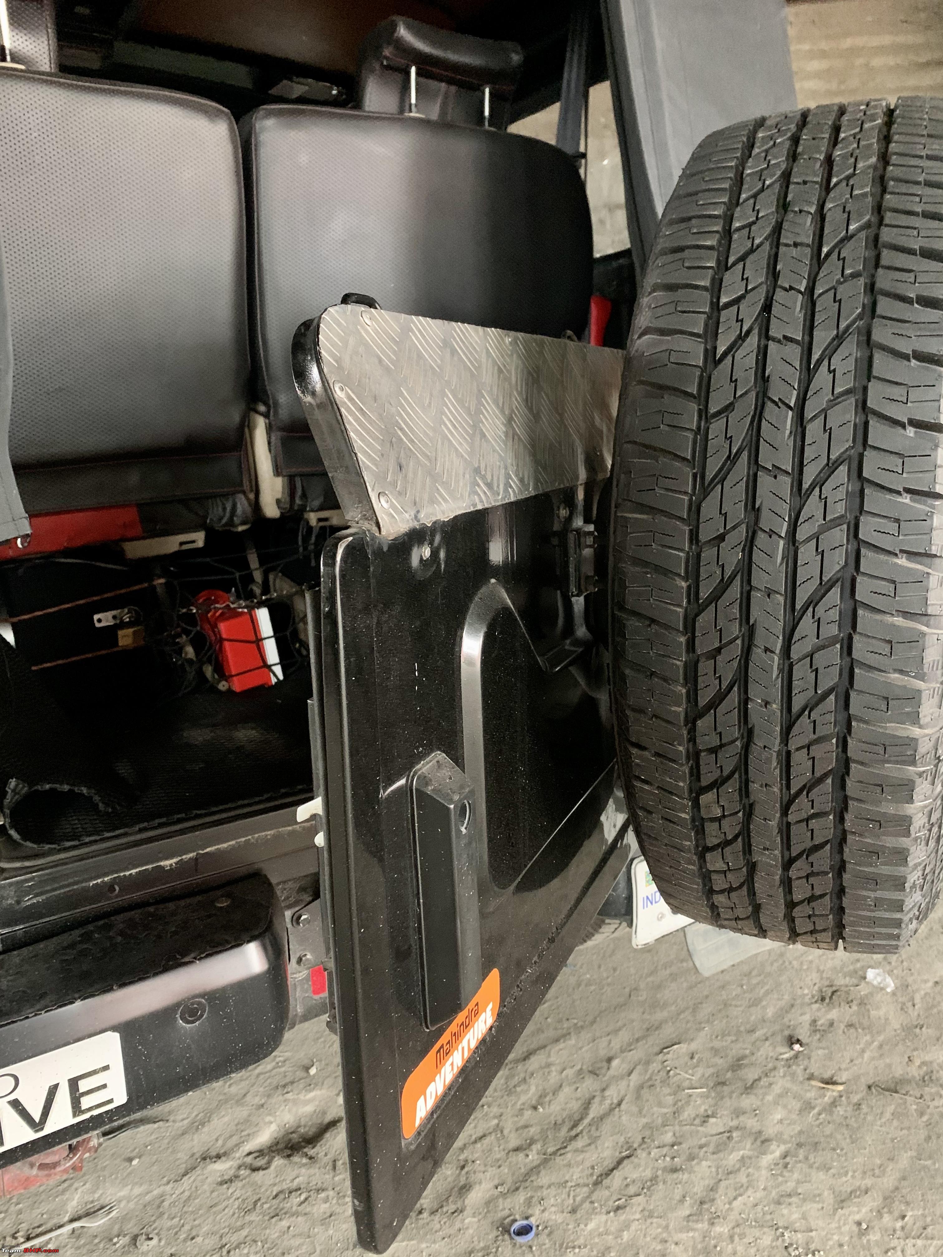

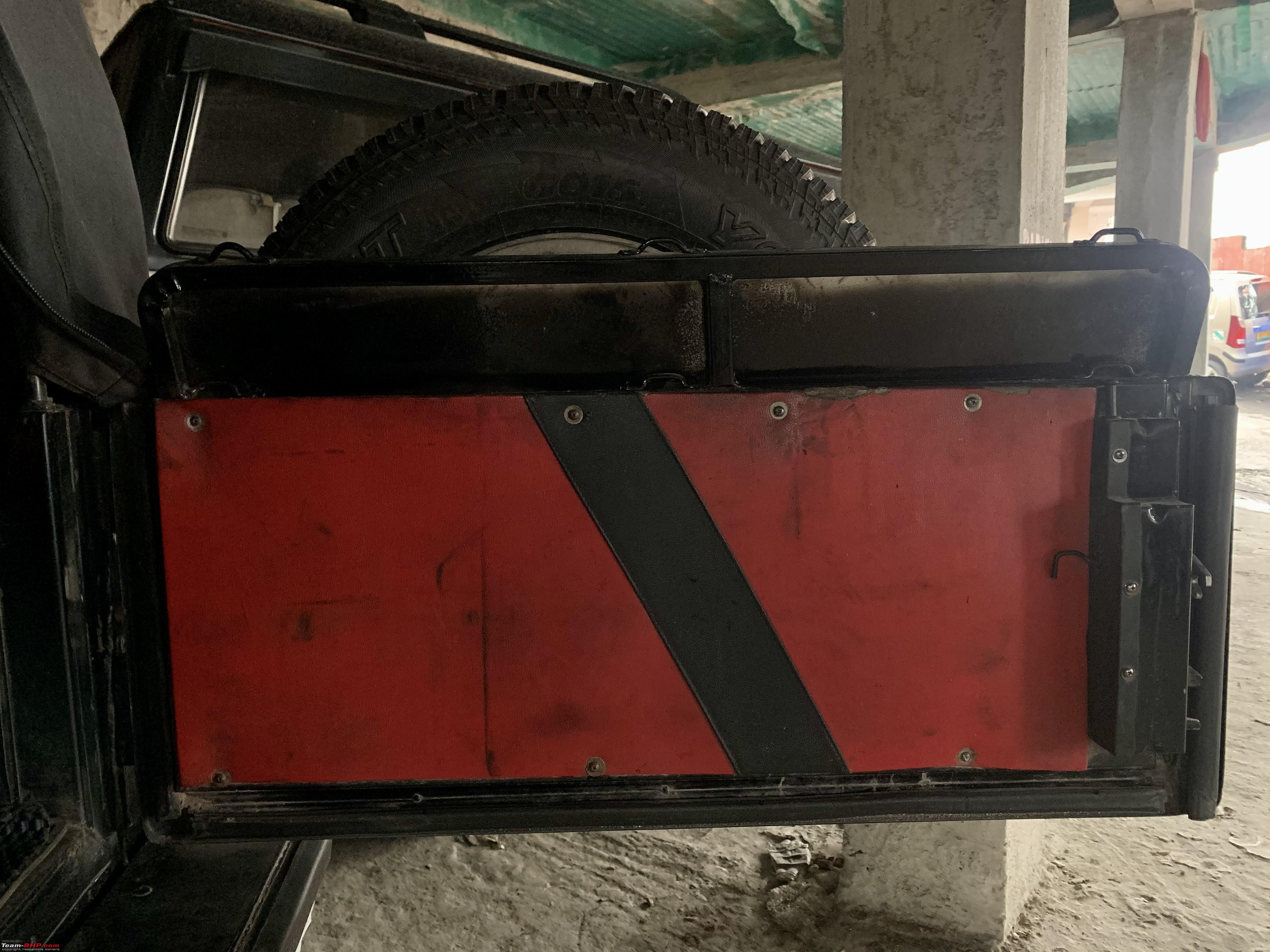

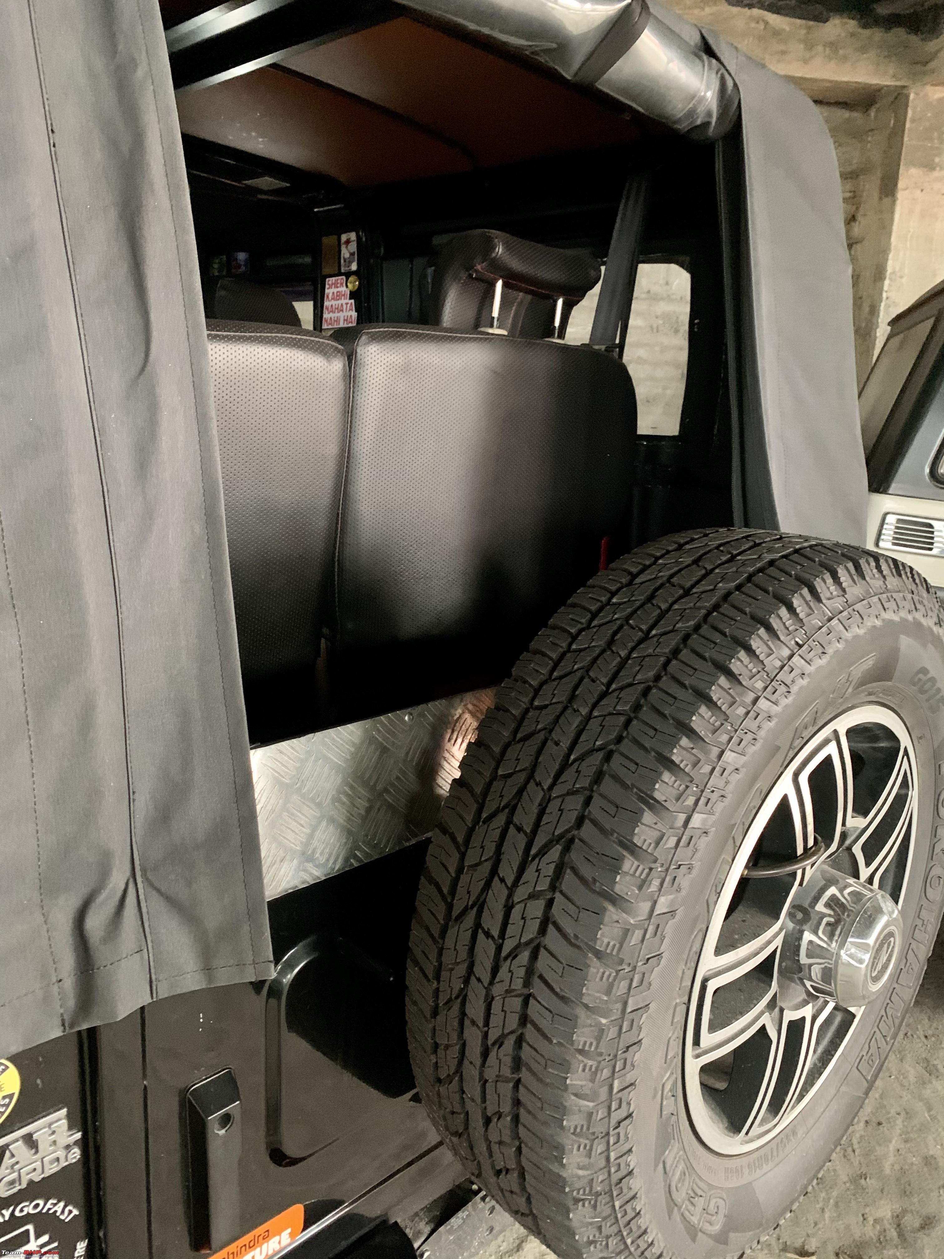

The rear tailgate I extended by 6 inches by a frame of steel pipe and chequered aluminium sheet to prevent the rear canopy from dripping down inside and keep some dust and water ingress.

More pics of this? I'm unable to imagine what and how of this.

He made his tailgate door taller so that the soft top overlaps it more outside, thus shedding more water and dirt. Smart idea.

Ahh okay. In one of the pictures above, the tail gate looks stock and hence the question. The mod job must have been after the trip.

Oh yes. The first photograph was before that mod. The Puri trip was after the mod but didn’t become visible in pictures. It cuts down dust and water ingress by a significant amount. Photographs here.

Good idea! Btw, where is the lock/unlock switch now? When I had soft top, I would lift the flap a little and press down that switch to lock from outside. And lift it to unlock. Convenient but hardly any security.

Thank you. Its welded and rivetted so lightweight and no noise. The default locking mechanism remains as it is and is easily accessible too.
