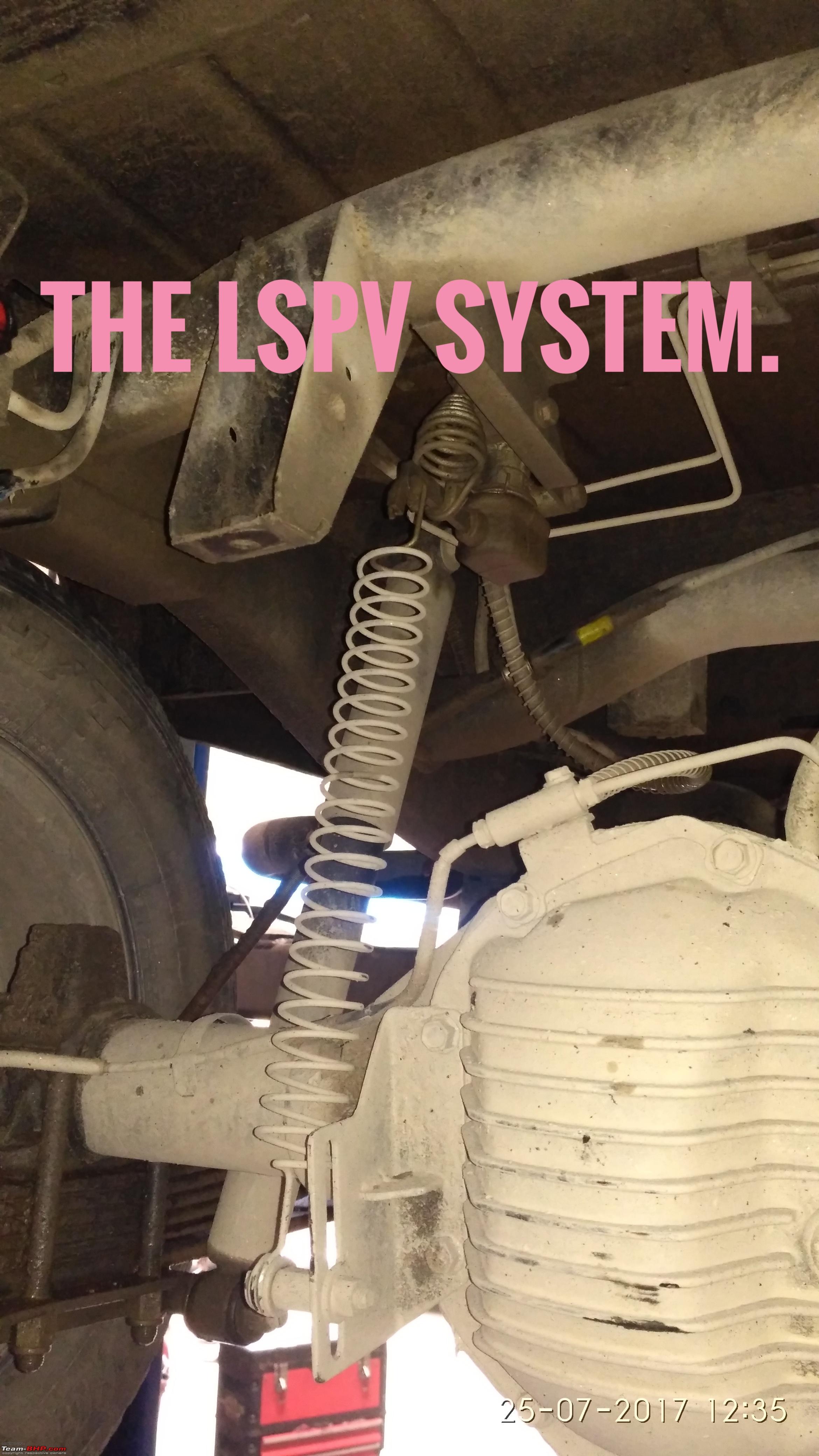

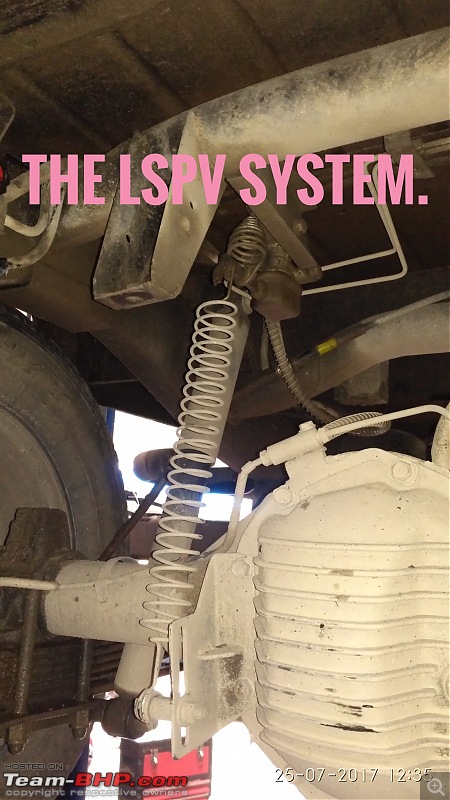

4th Servicing (Paid) and Fuel Meter Recall Finally.
So at 28000 kms I land up for my 4th Scheduled Service and they inform me that the fuel meter has a recall. I already have changed it twice in warranty so I expressed my displeasure but they informed me that it is a new assembly which should work.
Hence I agreed. Routine servicing done and fuel float changed after removing the tank. Also since I frequently visit sub zero temperature decided to remove the fuel strainer and stick to cleaner fuel.
Also saw the LSPV when the tank was removed for float change and cleaning etc.
Just got my Thar moments back and the fuel meter is showing a reading. Lets see how long this works.
