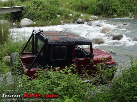

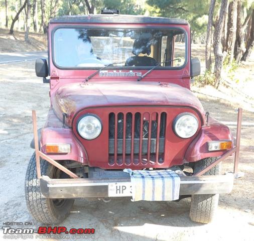

Next will be a preemptive rebuild of the alternator and starter. It's about time. I do them before they go bad. Needs paint bad. Gonna do that very soon. The steel half cap you see I fabbed seven years back. It is VERY handy, makes the vehicle more secure, cleaner inside, quieter. A gamble that paid off big time.
Runs like a scalded goose, rusty top and all! Burns no oil. "Cheaper to Keep her"...mebbee. And, no, I am not about to ford that river.
