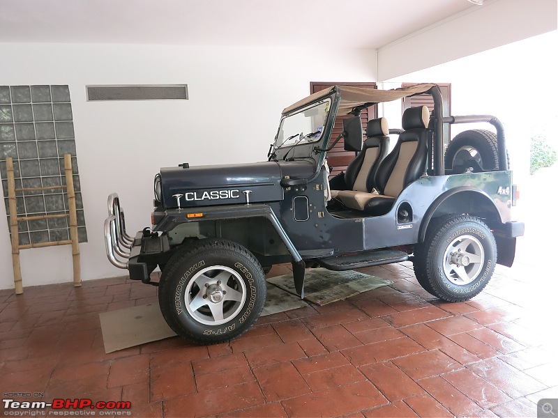

Hi Adrianus - first of all, let me congratulate you on owning the wonderful machine that you have there. Having owned a 2000 model Mahindra Classic myself for over 8 years, your pics made me miss my ex-flame yet again, more so because mine was a green one too with similar alloys Attaching a not-so-good pic of the same.
Coming to your issue at hand - looks like your Jeep is suffering from a symptom known as "Death Wobble" which is typically a result of worn out kingpin bearings and should be a straightforward fix. More details available here.
Hope this helps...
