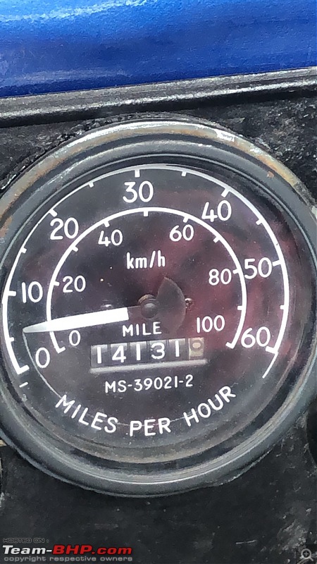

- The dash (incl the speedo which you've shown separately) is from the CJ 3A. But it is likely that this console is planted to an original Willys dash, as these never came as a separate console, but the gauges were seamlessly located within the dash sheet metal. The CJ 3B had a single speedo console, with the temp and fuel gauges within and a red speedo needle.

Stearing wheel and column are aftermarket, and not of that era.
Automatic GB, this is certainly not from the '60 or '70.
