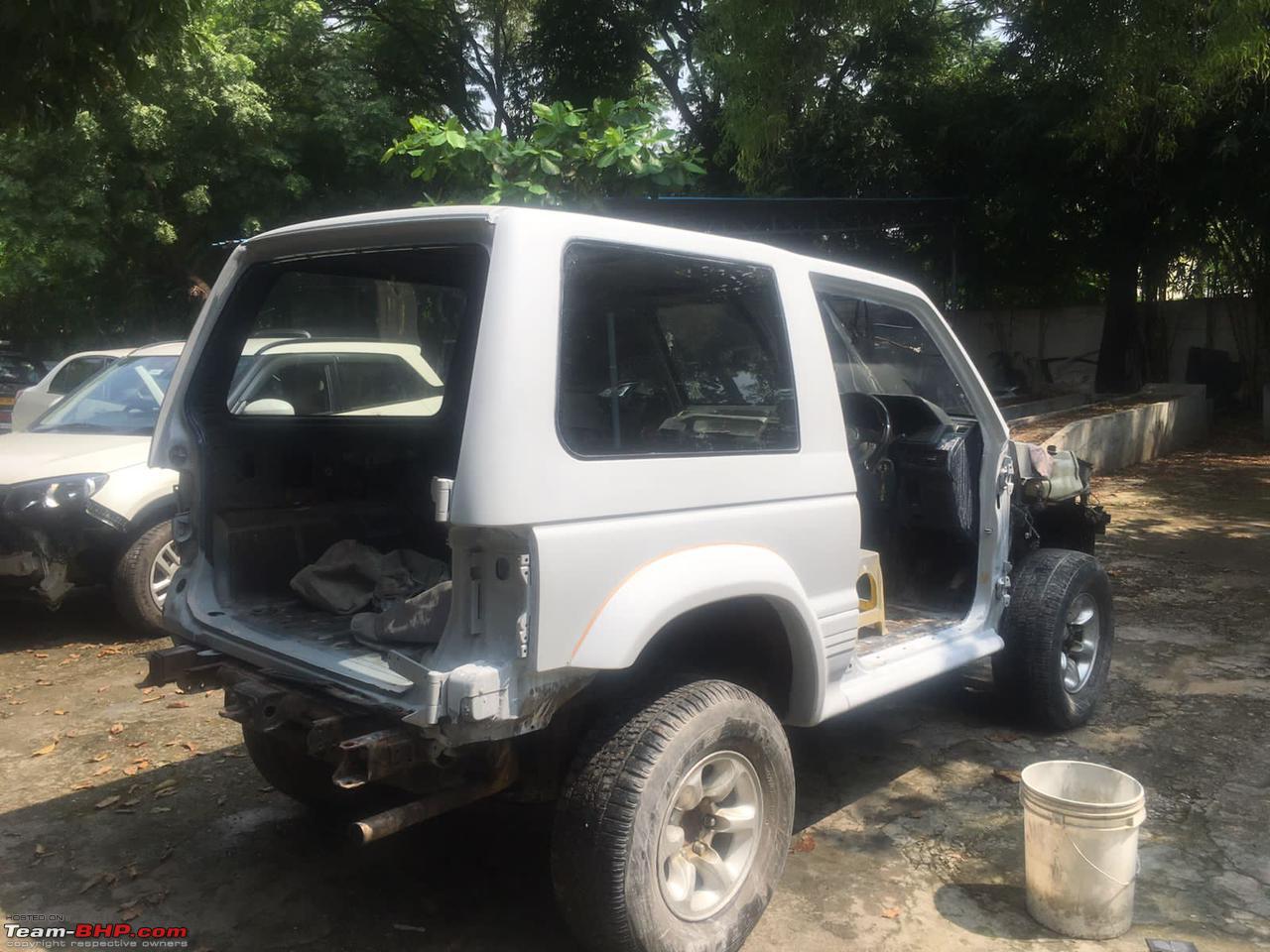

Fast forward 4 years and in 2015 I decided to go ahead and do major changes. The reason being-
1. No engine power (torque came after crossing 60 kmph), driving in low speed was painful
2. Gear box problem
3. Rusting (windows, rear door)
4. Interior work as sunroof leaking, seat wear and tear etc
5. Tyres
When we started working on it we thought of fixing the existing engine and gearbox. But availability of parts was a major issue which was taking a lot of time, without any result.

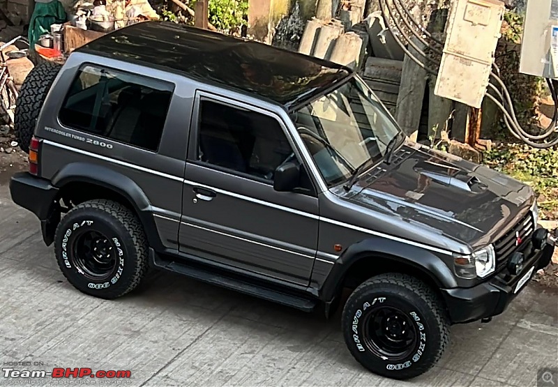

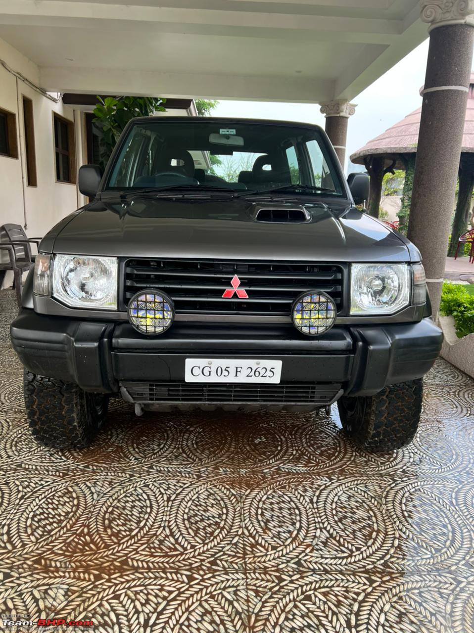

So eventually we went ahead and converted it from 2.5 to 2.8, thinking about the future maintenance also being easier. Also shifted from automatic to 5 speed manual gearbox. Few other changes-
1. 3M underbody antirust coating,
2. New carpet after fixing the rust and did antirust coating here also
3. Shut the sunroof (big relief) and have a new ceiling now
4. New seat cover
5. 4*4 works perfect now

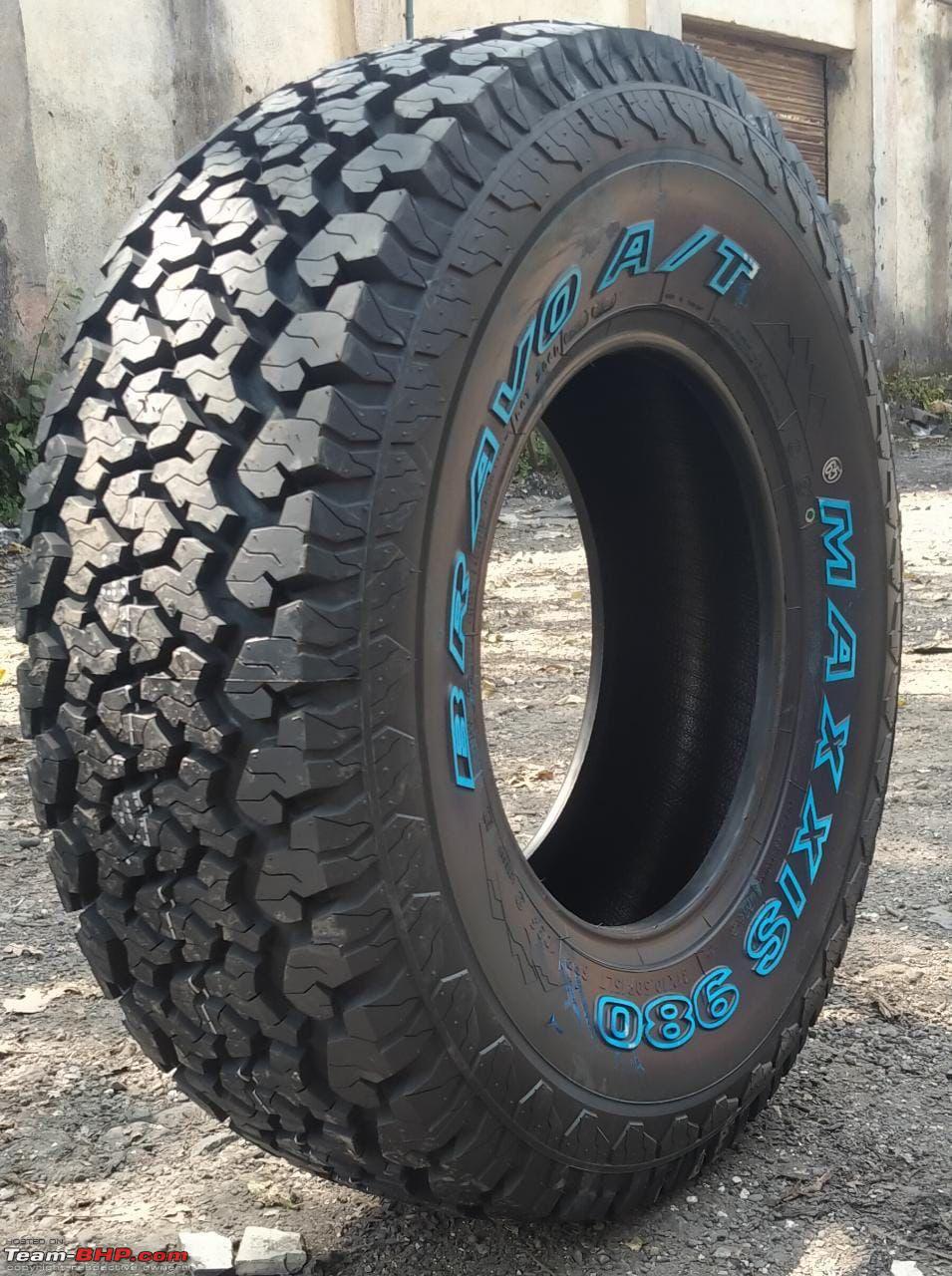

6. Maxxis 31/10.5/15 all new tyres and steel rims
7. New color
There are a lot of other minor changes done in the vehicle which I may not be aware as I relied and trusted the garage. I have started using it now and getting to learn slow and steadily. There are no modification wrt off-roading except A/T tyres. Just the basic and most important work done so far.
Recently I came across the idea of putting hybrid clutch, would like to know more about it. If anyone has any experience in their Pajero do share your valuable feedback.
Driving it is luxury :cool: and super fun. People look at it till it's out of sight even expensive car owners stop and give it a glance. I am making a video of the restoration will share it soon till then do enjoy the pictures :loveit.
Have fun :thumbs up

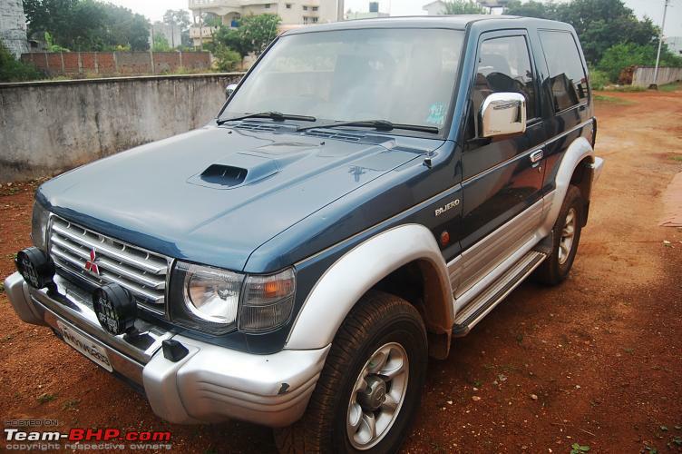

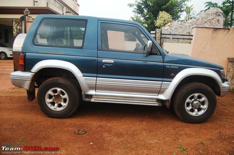

I'm little confused by the last two photographs where the car's colour is greenish. Is it some other Pajero?

The previous colour was blue (it may look green in the pic) as seen in the last two images. Tried to arrange the pics as those 2 pics were suppose to be the first pics. My apologies being new to the forum still getting used to it. So now it has Dark Grey colour.

You could have gone to 16 inch Tyres.
31/10.5/15 gives me enough sidewall for extreme roads and 16" wasn't really adding more of it so went ahead 15" only. Besides there were many using this size that gave me more confidence
