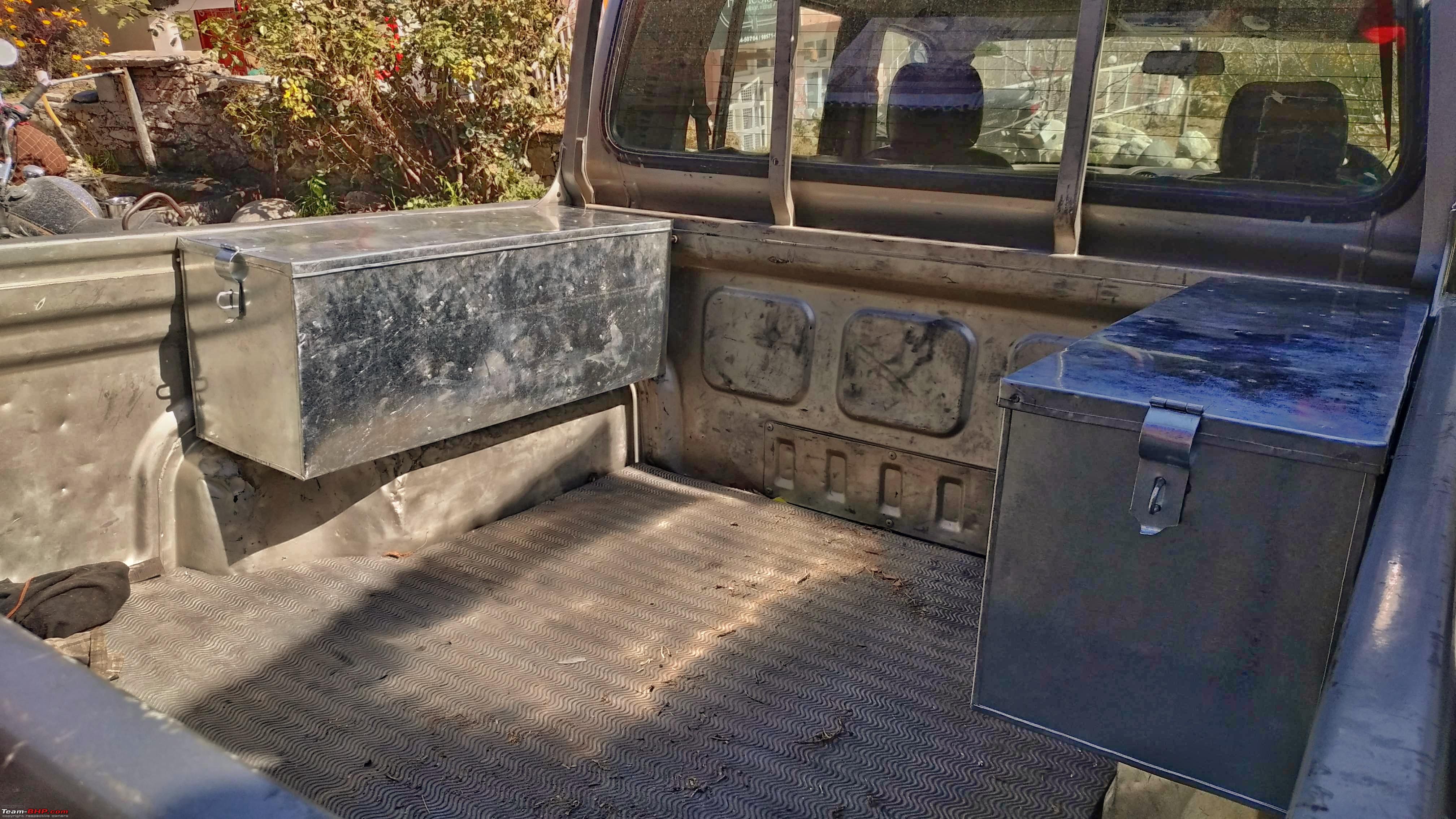

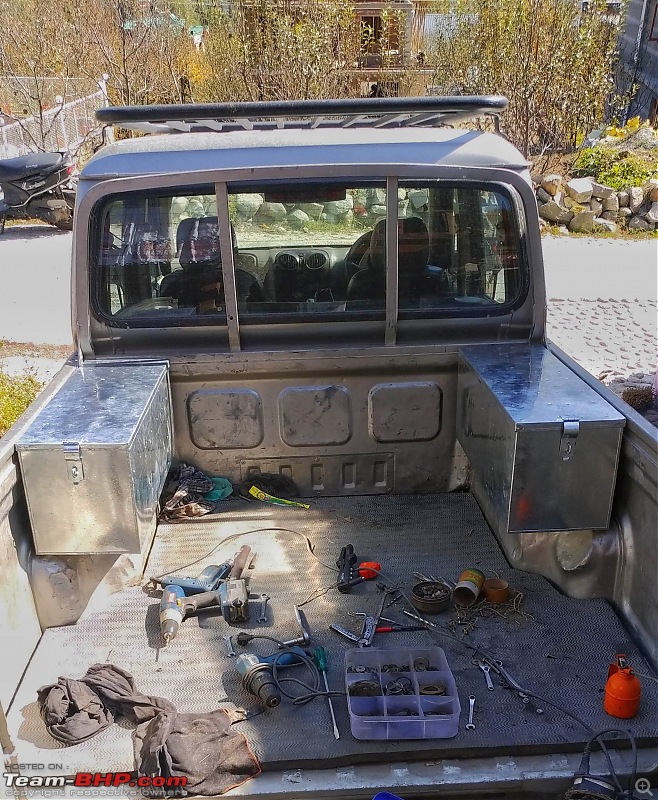

Got thinking that the transverse "tool box" I'd planned was going to make this short-bed even shorter, such that we'd not be able to manage bicycles, much less motorcycles... so came to this solution, locally fab'ed and self-installed, pretty rigidly I might add:
Mahindra Getaway 4x4 | Our Final Solution | Replacement for Mahindra Marshal?-img_20221103_12223601.jpeg
Mahindra Getaway 4x4 | Our Final Solution | Replacement for Mahindra Marshal?-img_20221103_11582301.jpeg
They're just about a foot wide and deep, and 2-1/2ft long, so just right for a couple of full-sized backpacks or whatever else. Weatherproof and braced enough / with tight-fitting lids so they don't rattle or creak much. Have already used them, both with and without a few cycles stacked between. Gonna be helpful.
Ordered a cheap enough OE front bumper which should be in tomorrow. Probably ought to get a reverse camera, since the head unit is set up for that function anyway, and the thing is certainly a lot longer and wider than the Marshal. On that note, though technically (legally) this is the wife's car, she hasn't driven it yet; I wanted to get everything right mechanically first so there wouldn't be any distractions, without which there is already enough to adjust to / be mindful of. It's a beast.

Nicely done boxes, there @Ringoism.
Reading your updates gives a sense of work getting done in a purposeful way, and for a purpose. All the repairs, functional mods would be put to use, unlike the ricer style mods that some do. (My MG413W is also getting readied in a similar way. Small issues are being taken care of, and some functional touches so that it wont go back for a long time. Just waiting to get my hands back on it so it can put to it's intended duty asap).

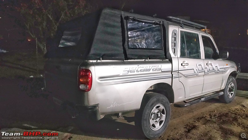

Spent (unbelievably) a couple days fabbing these cargo rails, or whatever you want to call them. Couldn't find anyone around who was either available to do the work or using methods by which it would actually turn out looking well-finished. These match the pipe diameter of the roof rack and (soon to be removed) brush guard / bull-bar... Hadn't really done any work like this since the rock-sliders on the Marshal, and those were far easier.
Mahindra Getaway 4x4 | Our Final Solution | Replacement for Mahindra Marshal?-img_20221126_14471301_1.jpeg
Anyway these would not really have been necessary if I'd not been intending to fit a canopy on the back - and would not have been thinking of a canopy if not for the plans to head out we early December with four persons, five bicycles, several boxes of apples and jam, and luggage, on a few-thousand km journey from Manali to Mizoram...
Mechanically preparations are getting close - still four or five important things to get done, and too busy to get into discussion of completed / pending.
Suffice it to say that a near decade-old, semi-neglected M&M product can keep you going for awhile.

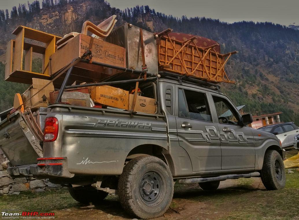

11. Cargo rails / carry boxes / canopy for bed.

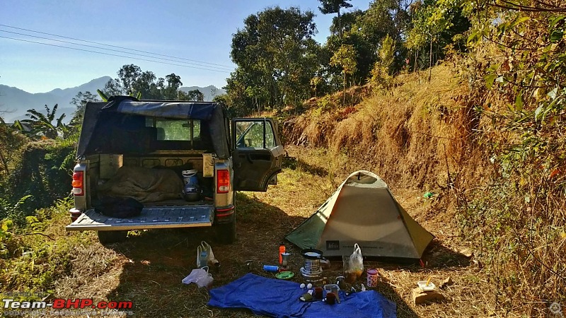

Mahindra Getaway 4x4 | Our Final Solution | Replacement for Mahindra Marshal?-img_20221129_19082201.jpeg
We had wanted to get on the road December 7th, but at the last minute, sleep-deprived and still trying to move stuff out of our place into storage as we awaited completion of our new place, we wisely postponed our departure.
9th morning we were off, we took ten days arriving, had almost two months on the ground in Mizoram, and departed the 21st Feb for another ten days back, with about six days each way spent actually on-road, the others sight-seeing etc. Did quite a lot of moving about within MZ as well, such that by the time we returned, we had covered nearly 8800km's! The car did great, took us on all sorts of roads (and non-roads) with no significant issues.
Stayed with lots of old friends & good people along the way... I pretty much had stopped traveling outside the hills at the point we got married, and it has been amazing to see how much things have changed, overwhelmingly for the better. Might post a more complete thread (and/or that Mizoram thread I started years ago) eventually, but for now just will share the route and whatever pics I took with my phone (also had my Oly Stylus 1 along, haven't delved into those as yet):
Basic route going was Manali - Dehradun - Lucknow - Allahabad - Varanasi - Kushinagar - Siliguri - Guwahati - Aizawl; And within MZ east right up to and then along the Burma border. Crossed over there on foot (Burmese border officials having fled their posts in that particular place), but vehicle bridge is closed now due to the war over there. Had been over a couple times to see what is called "the biggest lake in Mizoram" - Rih-Dil - which has for a long time actually been a few km's inside Myanmar. This time stayed mainly on the Indian side, spent several days out there, moving around quite a bit and seeing quite a few lovely sights.
And returning: Aizawl - Guwahati - Siliguri - Kakarbitta/Kalyam (Nepal) - Malda dist (WB) - Patna - Lucknow - Manali.
Will leave you to the pics now, in the hopes that sometime in the next few months I'll be able to find time to write up something like a proper (at least proper for me) travelogue. FYI the focus here is on things we could view and witness from the car itself, very often in places (especially in Mizoram) seldom trod by outsiders. Whereas getting into the tremendous number of beautiful things we witnessed further off the roads / deeper into the cities in all the above places spanning the north of the country would take an enormous amount of time that I can't afford at present. But suffice it to say for now that this is an amazing land.
