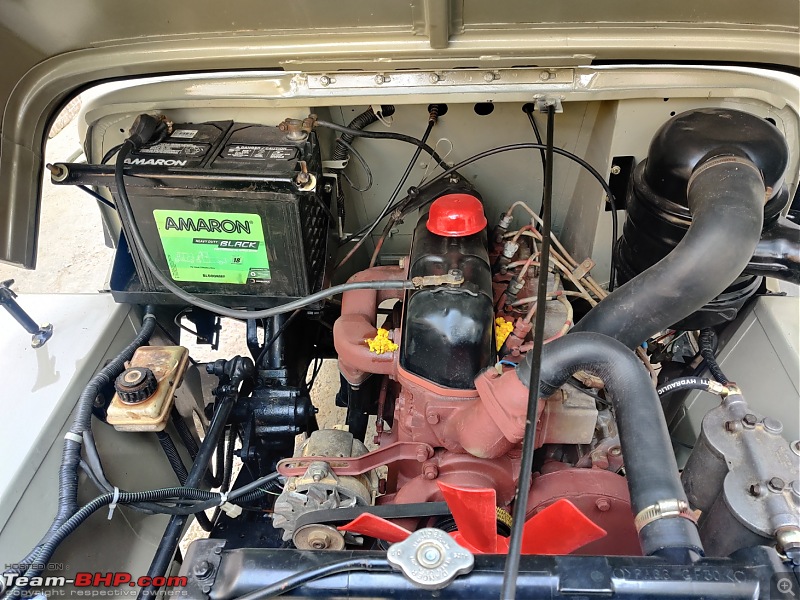

Zooming into your newly painted engine bay I dont see a tell-tale large Transfer case. Most likely you have just the 2wd GB and the rear diff center aligned. If you insist on a 4wd you would literally need front and rear axle+diff+diff tubes and GB + Tcase. I would say 1Lac approx cost in exchange for your existing parts.
See if it is worth it, if needed I can guide you over a phone call to get it done.

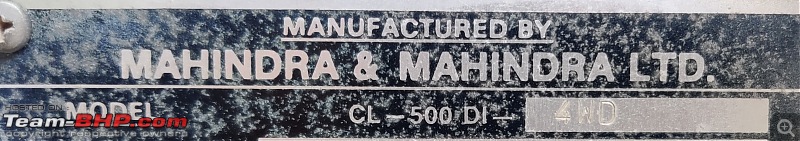

This particular jeep was sold as 4WD from company. Look at the first pic of chassis number which starts with 4WD.
