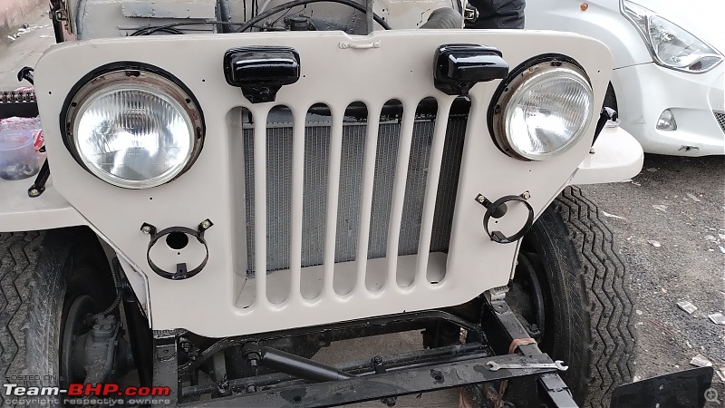

Fitment of Lights
Bought a 1970 Mahindra Jeep (CJ500) | Requesting advice and guidance-img_20250115_170928650.jpg

Final Checking of the Lights and all connections before mounting various casings
Bought a 1970 Mahindra Jeep (CJ500) | Requesting advice and guidance-img_20250123_130025598_hdr.jpg
Bought a 1970 Mahindra Jeep (CJ500) | Requesting advice and guidance-img_20250123_130019359_hdr.jpg

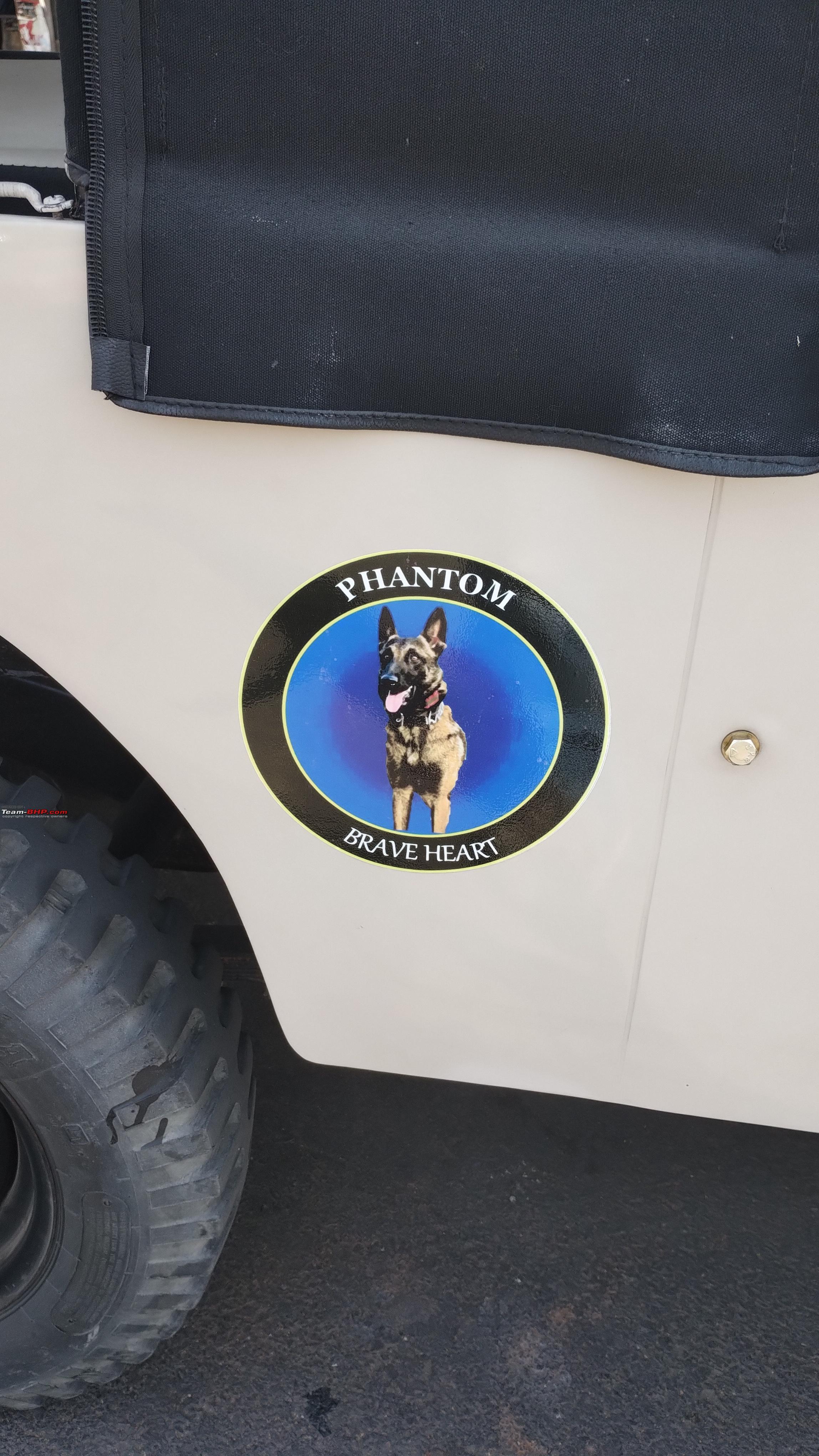

COSMETIC CHANGES
Just some pictures
Bought a 1970 Mahindra Jeep (CJ500) | Requesting advice and guidance-1000335065.jpg
Bought a 1970 Mahindra Jeep (CJ500) | Requesting advice and guidance-1000335064.jpg
