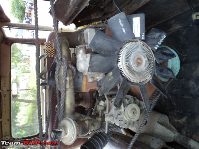

I have only just come across this post. And it is just what I need. I am in the midst of upgrading my soft top 750DP 105, and have purchased the DI turbo from a Bolero Maxx pick up along with the 5+1 box. Is there anyone out there who has done a similar upgrade??? Are there any pitfalls that I need to watch out for?? Thinking of going the full way with replacing the axles as well so that I can get the advantage of the disc/drum brake setup. Would like also to use 17 in wheels instead of the 16 in ones. Waiting for replies ASAP before I get covered in grease or drop into hot water with this job. Thanks in advance!!
