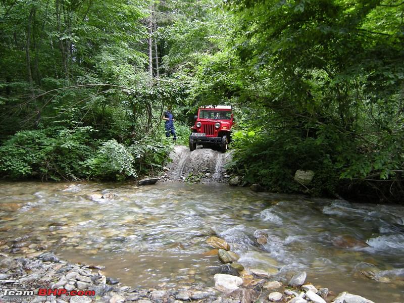

Dear friend, your words reveal your love for the Jeep, the condition of the Jeep endorses it and it is equally gratifying to see the interest you have shown in this forum of Jeep Lovers. And the pictures of serene nature are gorgeous!It looks like a Mahndra Jeep offroading in Indian hill stations like Nainital or Munnar.Please do write something about Macedonia, the land of Alexander th Great and of chivalry, and also post some pictures including other four wheel drive vehicles in Macedonia.
