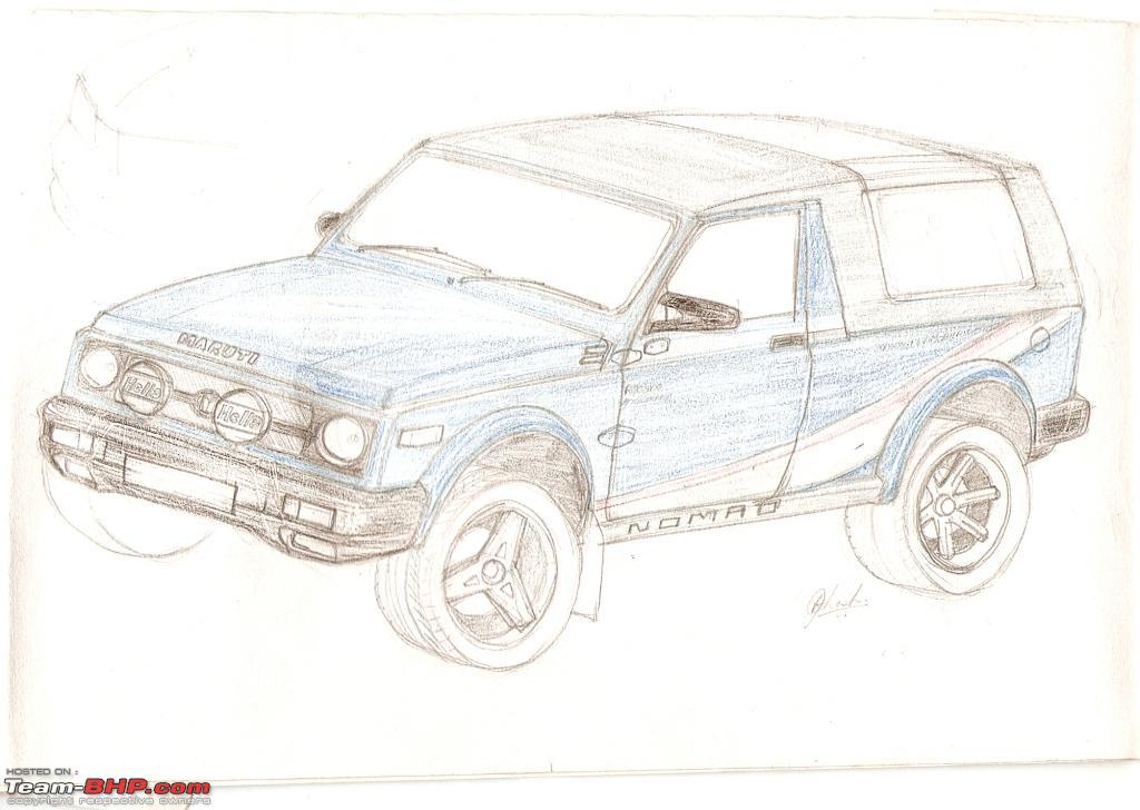

Our resident designer Tbhpian, Ayan, is quite a talent. I discussed Project Nomad with him, and he drew out this wonderful rendering at a moments notice, giving vision to my thoughts. Do check out the guys talent.
Project Nomad - The quest to build an adventurer Gypsy King-scan0009-smaller.jpg
So all 4wd gurus, as you can see, I've done quite a bit of research on Project Nomad. Please please advise me on all aspects. I'm serious about this project, and will see it to fullfillment. Looking forward to your help.
