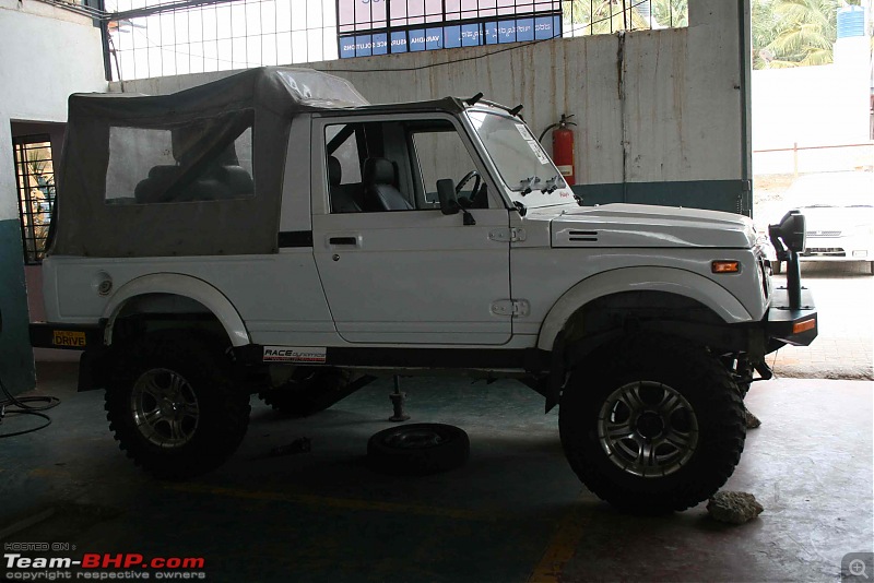

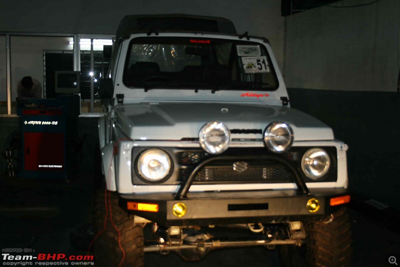

Gypsy before and after SPoA
A Pure Off-Road Spec Gypsy Build | SPoA, Lockers, Bumpers etc etc.-vviji5.jpg
A Pure Off-Road Spec Gypsy Build | SPoA, Lockers, Bumpers etc etc.-vviji1.jpg
A Pure Off-Road Spec Gypsy Build | SPoA, Lockers, Bumpers etc etc.-vviji2.jpg
A Pure Off-Road Spec Gypsy Build | SPoA, Lockers, Bumpers etc etc.-vviji3.jpg
A Pure Off-Road Spec Gypsy Build | SPoA, Lockers, Bumpers etc etc.-vviji4.jpg
A Pure Off-Road Spec Gypsy Build | SPoA, Lockers, Bumpers etc etc.-vviji6.jpg

Sweeeeeeeeet Vijay Sir!!
It looks killer! That before and after pictures reminds me of HULK movie
Why not chop the rear over hang?
Why is the front differential right offset? Or is this the case with all Gypsies?

Still lot of things pending, over hang work will be next just mechanical work finished.

Hello,
This is brilliant looking!
Articulation must have improved quite a bit, no?
Also, is there enough room for the tyre in the rear wheel wells?
Btw, this was always the look I plannedo n going for, in my own gypsy!
Softtop, with a nice bumper + SOA-type-stance.. looks meaannn!
When will you be testing it out?
Starter, front diff is offset to the right in all gypsies..

Viji, thats a macho looking Gypsy, love the front bumper styling. Anti roll bar looks misaligned or is it the angle of the pic?
Spike
P.S. Is the front indicator lamp mounted on the front bumper from a MM540?
Spike
Spike its not fitted when i took this picture,
you are right spike its from MM 550

Originally Posted by bishancm View Post
Looking Gorgeous in fact.
Just was curious to know if these pictures were before or after RUF mod...
This is after the RUF mod. That's why you don't see the steering drag link in the pictures (surprising that it has missed the eagle eyes of members here.. ). With RUF, the drag link touches the left leaf spring and needs to be modified. Either a Z-Link setup or a cross-over is mandatory for RUF.
