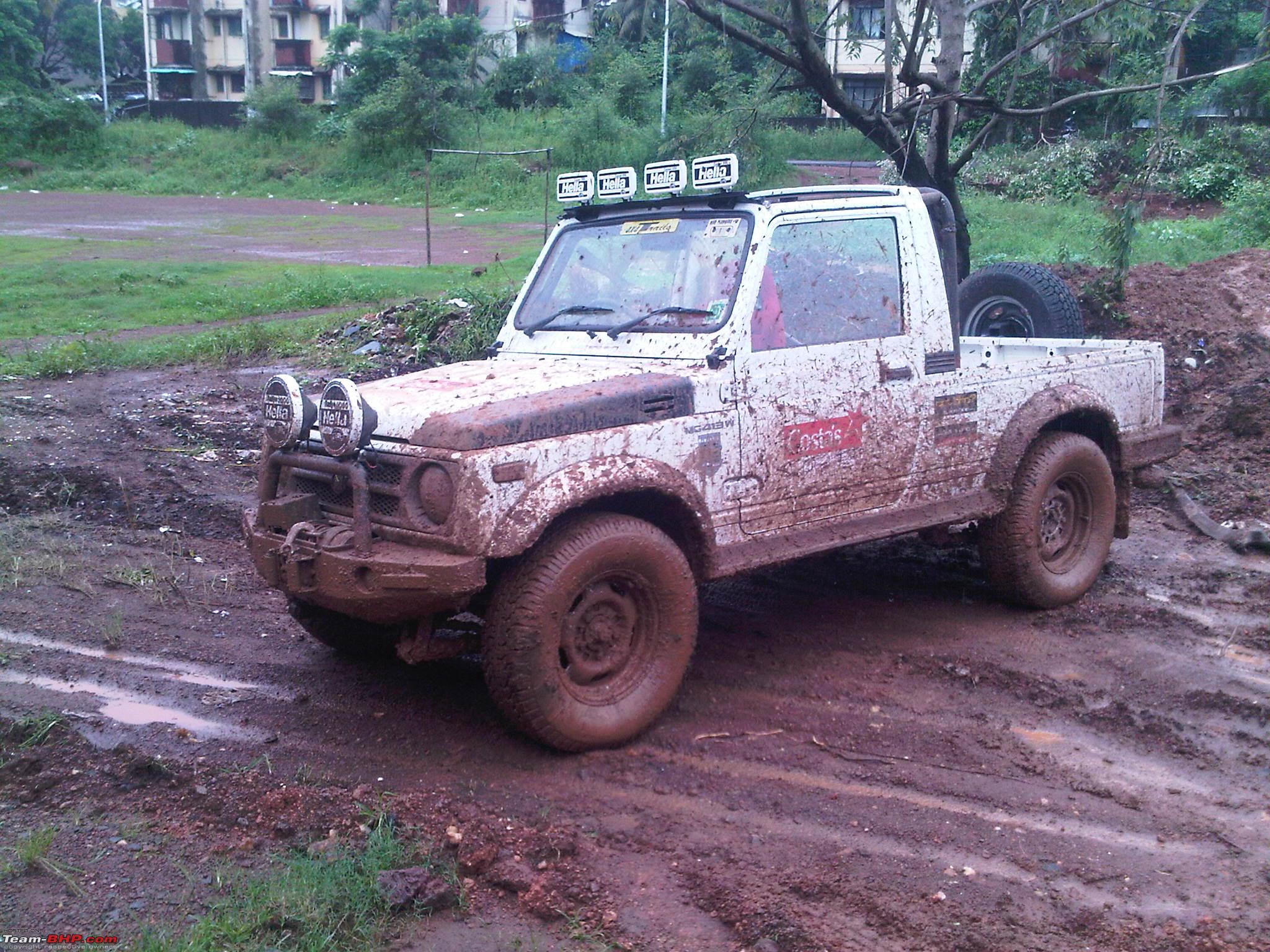

Good job done on your Gypsy Indra. Will you let me on to Santan to fabricate that bumper for my Gypsy too ?
I See you already tested that winch from the photos on your post
Are those MICKY THOMPSONS that are coming from the US ? They are great wheels.
Will try to drop into Margao this week. Cheers till then

The gypsy is simple looking amazing. Don't regret about your choice of bumper. Its very well gelling with the car. And yes, it badly need new rims and better shoes.

@indra slk : thats a really wonderful job. Its nice to see such enthusiasts here on the forum.
Can you provide some information on the winch? Whats the type of winch? If its self-winch where has it been powered from? How effective is the winch? I can see you trying your winch in one of the pics.
